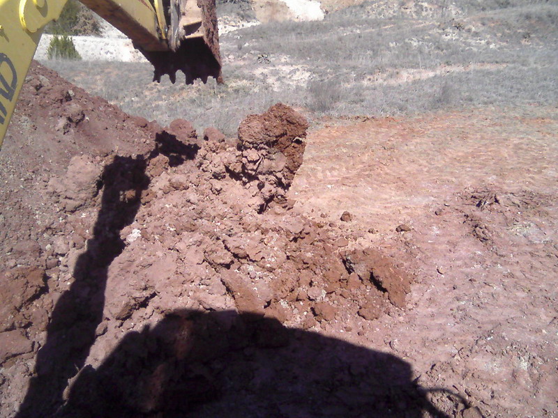

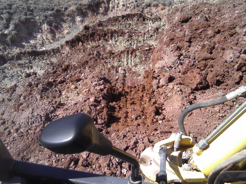

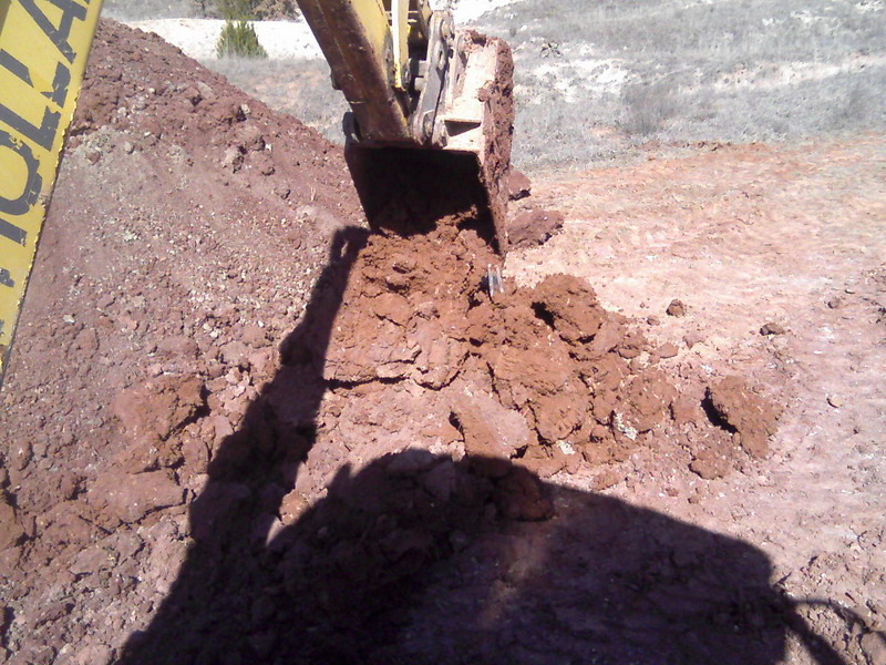

At the clay mine yesterday. Can you dig it?;)

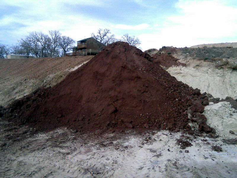

Here's three quick pictures from yesterday. The first is the huge pile of clay (around 100 sq yds) I hauled yesterday. To speed things up, I haul the clay and dump if over the vertical side of my finished dam. When I get a pile big enough, I go down to the pond level and spread the clay on the dam. That way I don't have to navigate downhill (very steep) with a bucket full of clay. I'm cutting corners where possible to speed the process. The 2nd photo shows my clay layer spread before compacting. The final picture is after driving back and forth over the loose clay with a bucket full of clay to aid compaction. I put in three tiers of clay yesterday. With the 100 cu yd, I was able to raise the level of the dam about 2' yesterday. I'm going to try to make another 18" or 2' today. Gotta go. . . :)
