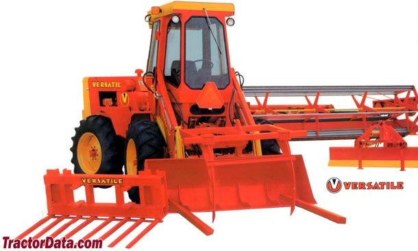

Ford- New Holland bought Versatile who were the original designers. Steiner also built large articulating 4 wheel drive tractors.
Thinking making a model around 40-60 HP based on a compacted/lightened model 150 which was about 70 hp ~ 50 PTO hp and was right around 8 k lb would be close to what would cover the bases. Not sure it had the rotating platform though or attachment capability at each end. Hard to get all that in even a 150 sized machine.
looking at the standard tires on the 150 (11.2 x 24) and its~ hp would be great just needs to be a bit more compact. Actually the 150 with FEL sounds pretty darn good!:)
edit: but having to remove the FEL to do 3 point work would not cover all the bases, but size wise it is getting close.

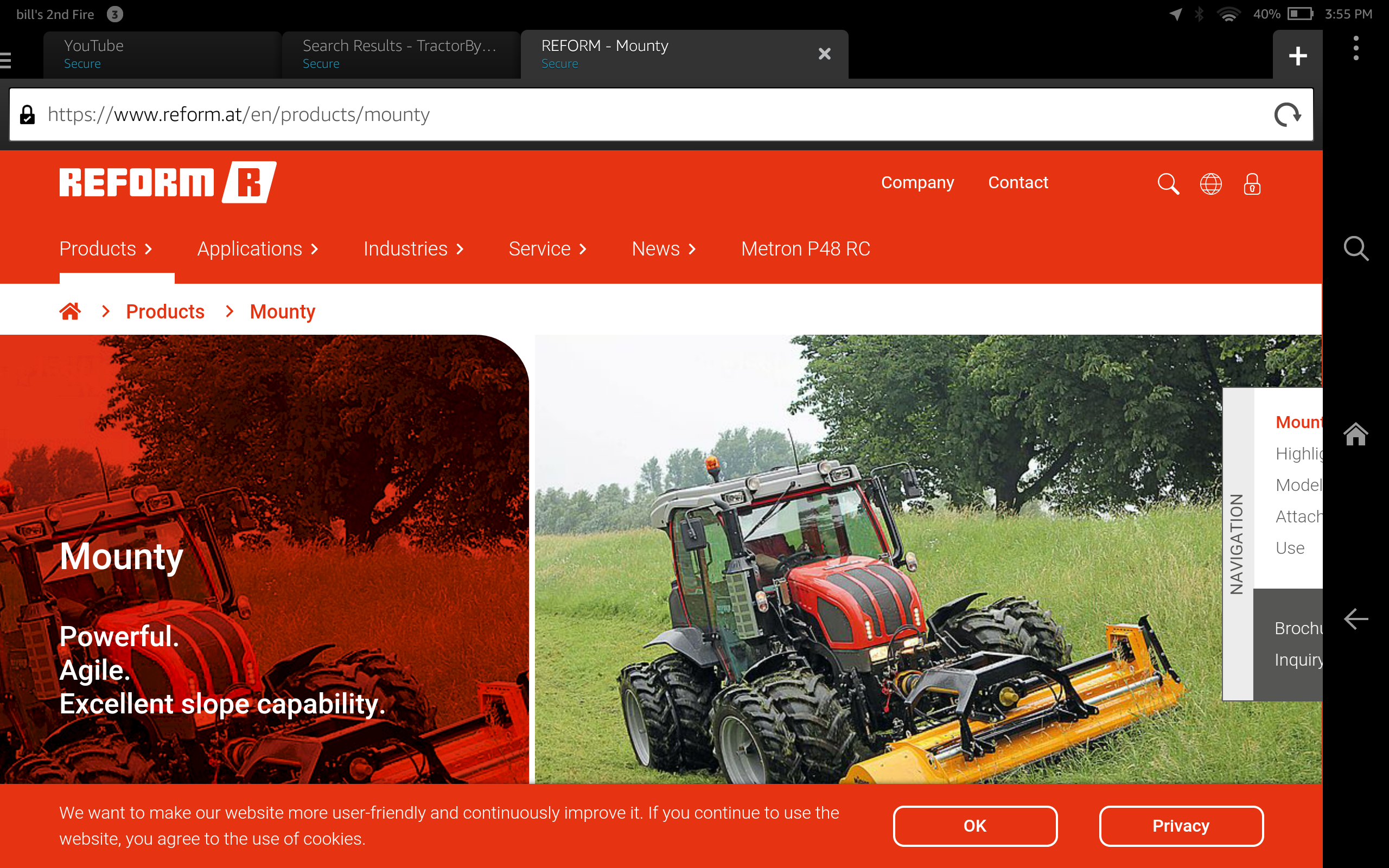

If cost were no object, guess this swiss tractor would top my list. High HP, front + rear PTO, linkage, FEL, slope stable, cab, HVAC, HST, 4 wheel steer, locking differential F+R, a real chassis FRAME,

SD455,
That's perfect! Now, about the price ...
I guess we (I) want it all, except the price tag that goes along with it.
