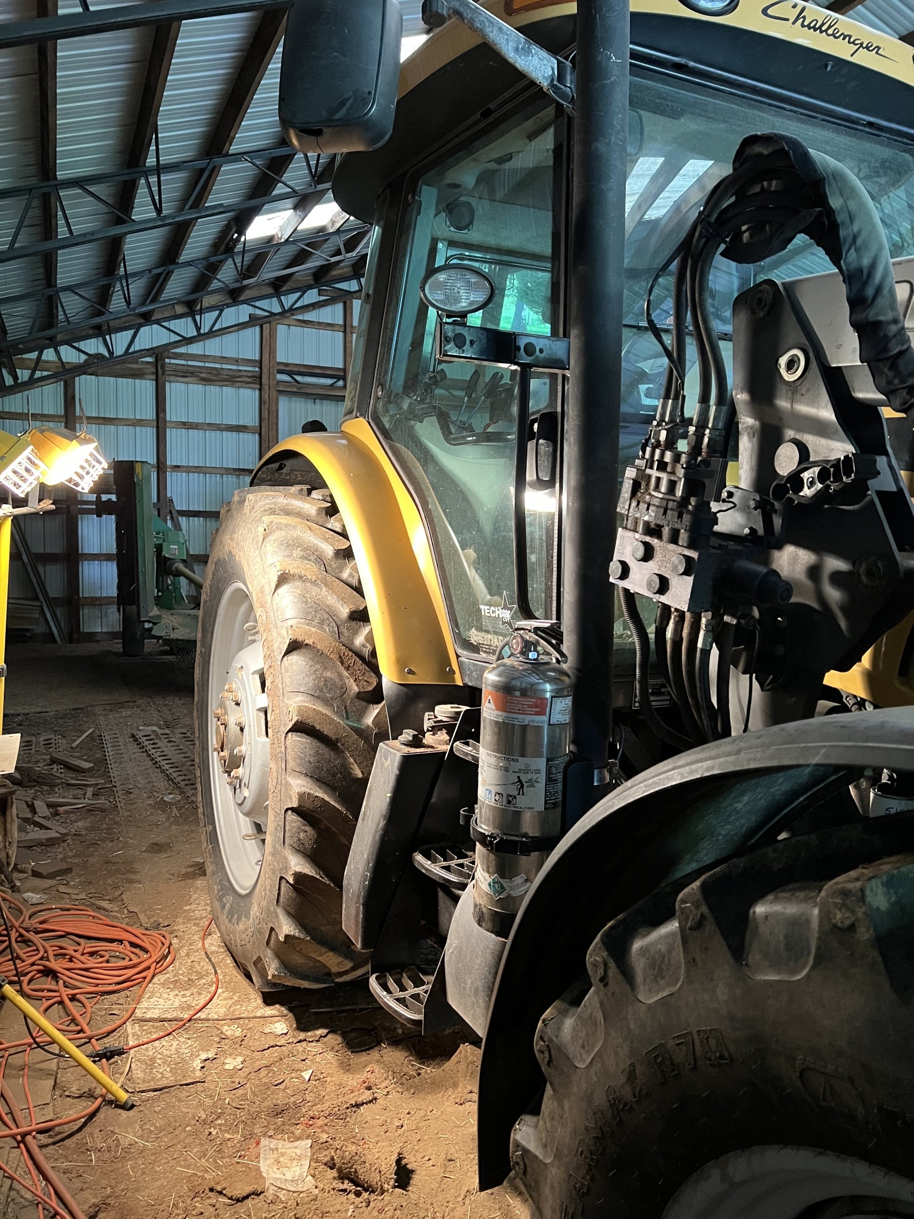

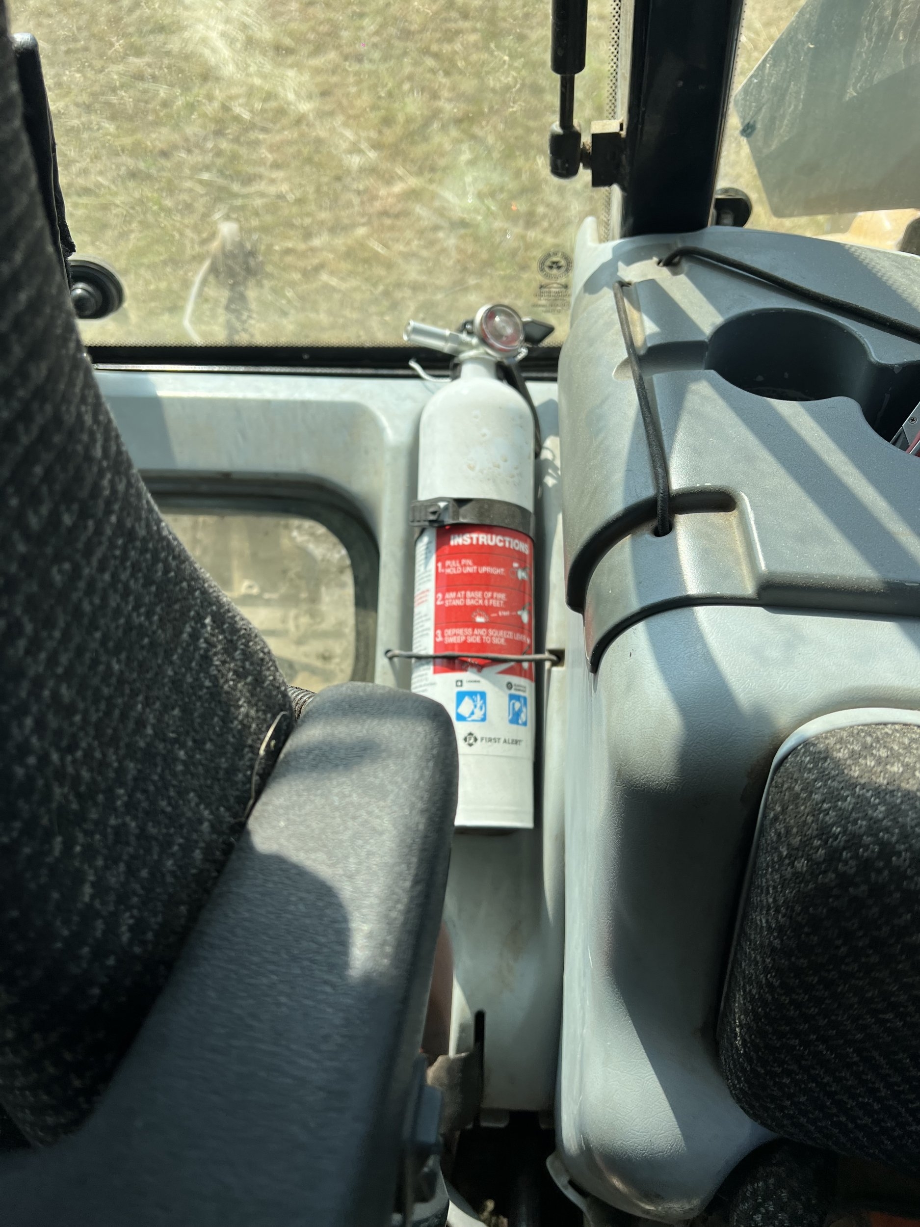

That's got to be scary as he77, a fire on a field and machine full of dry fuel. What do you carry for fire control?
I‘m scared of fire. Always have been. Had 2 round baler fires, but I got them early, so minimal damage.
The Challenger and the Magnum both have on board marine/auto (white) extinguishers in the cab. The Challenger also has a large stainless fire extinguisher outside. The Krone baler also has an on board stainless fire extinguisher.
Massey has a pretty big ABC extinguisher in the cab.

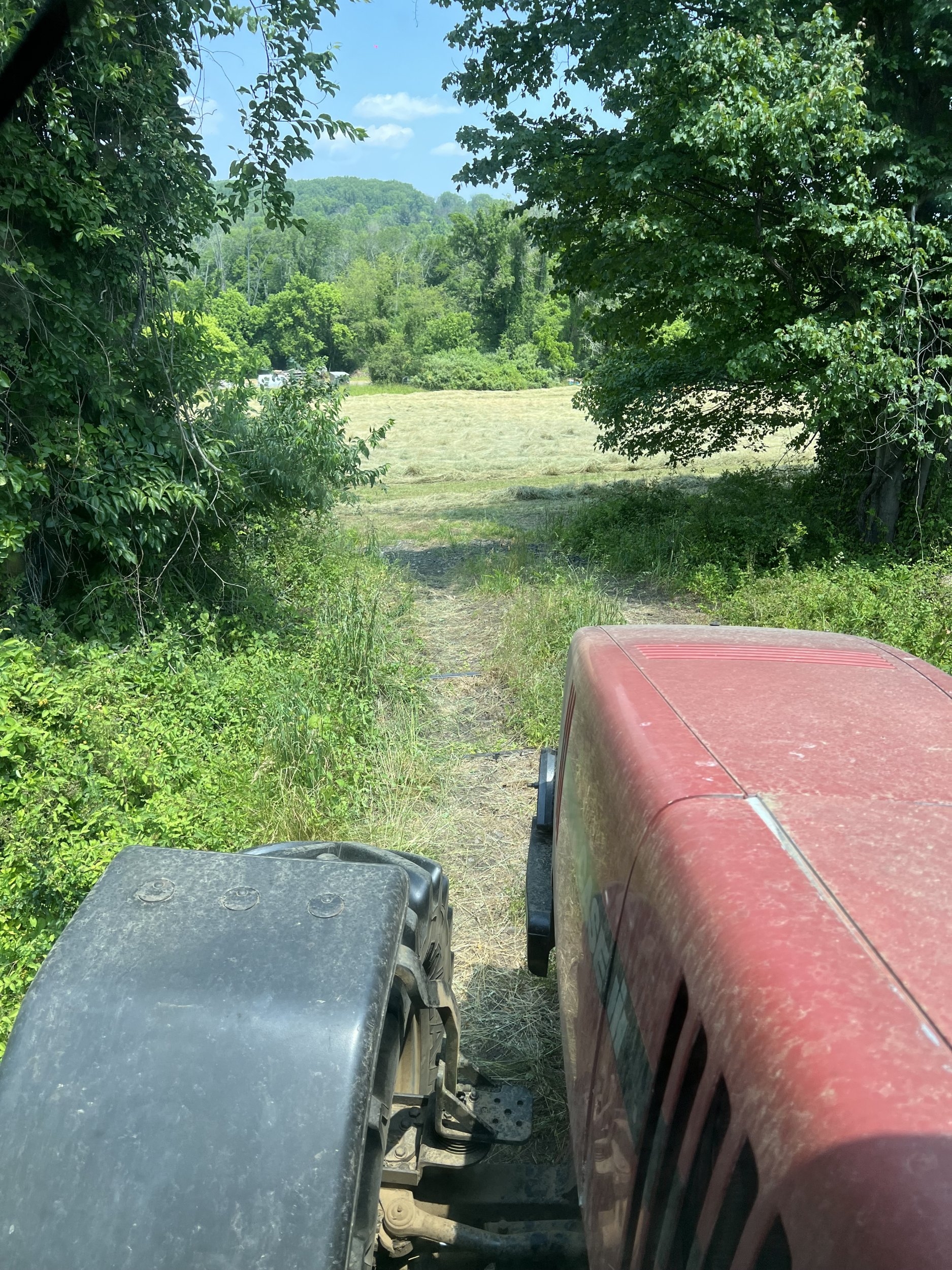

Back at it today. Made about 25 nice 4x4x5 feed hay bales and 45 typical 4x4x8 large square bales.
Crossing the old Baltimore & Ohio rail berm into a 10 acre field.
If you look closely you can see the old B&O rails in front of my Magnum.

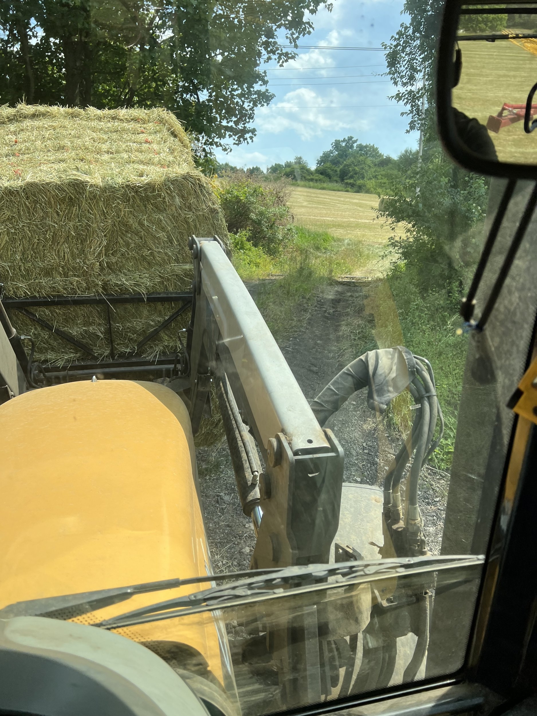

Carrying some of the 4x4x5 bales out of field back across the old RR tracks.

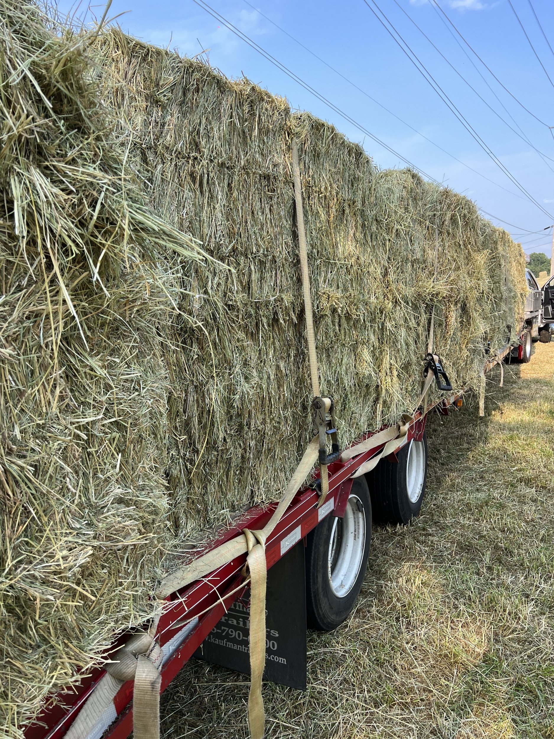

Back to truck & trailer strapped down and ready to go into the barn.

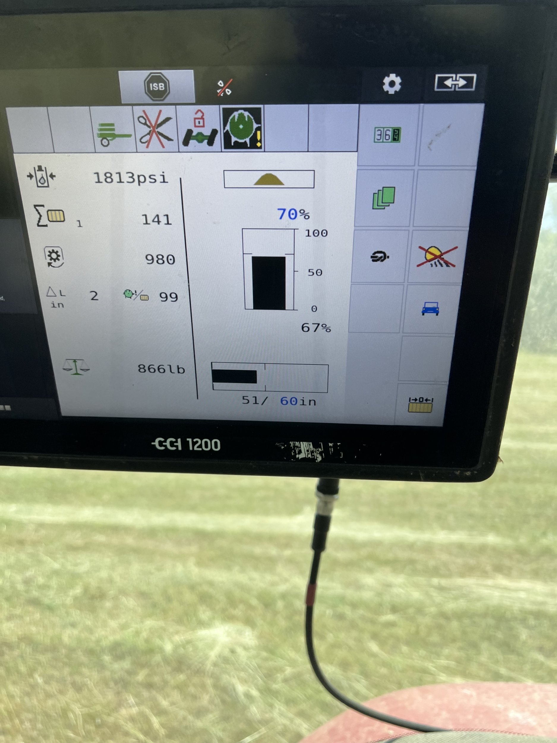

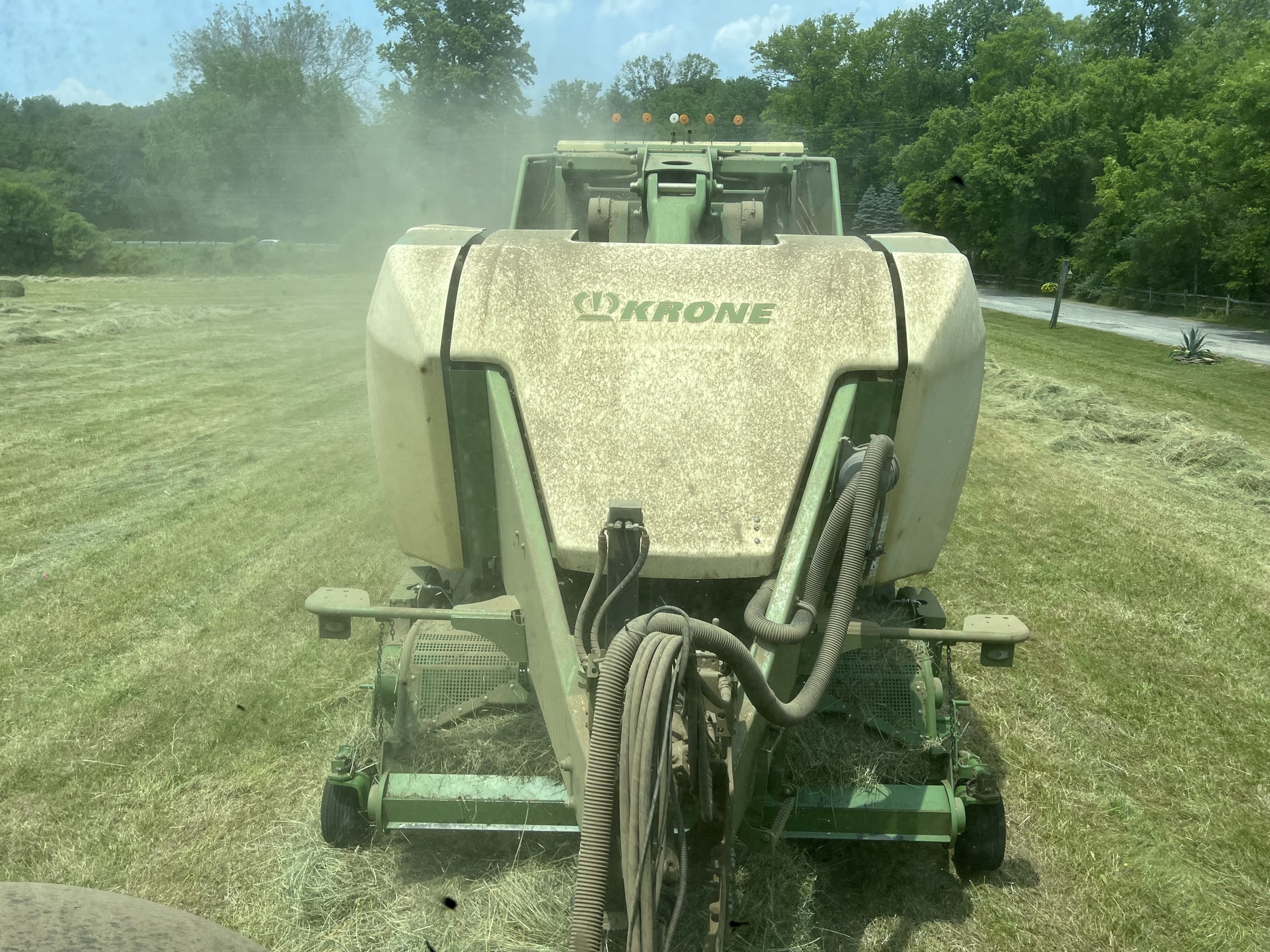

Today brought us more sun. I hit the 10:30 service, skipped lunch and began raking around 12. By 2;30 had 10 more acres raked & baled. Here’s a view of my Krone 4x4 XC baler from rear window of the Magnum. It’s about the size of a 10 wheel dump truck. Weighs 37,000lbs so theres a lot of weight there.

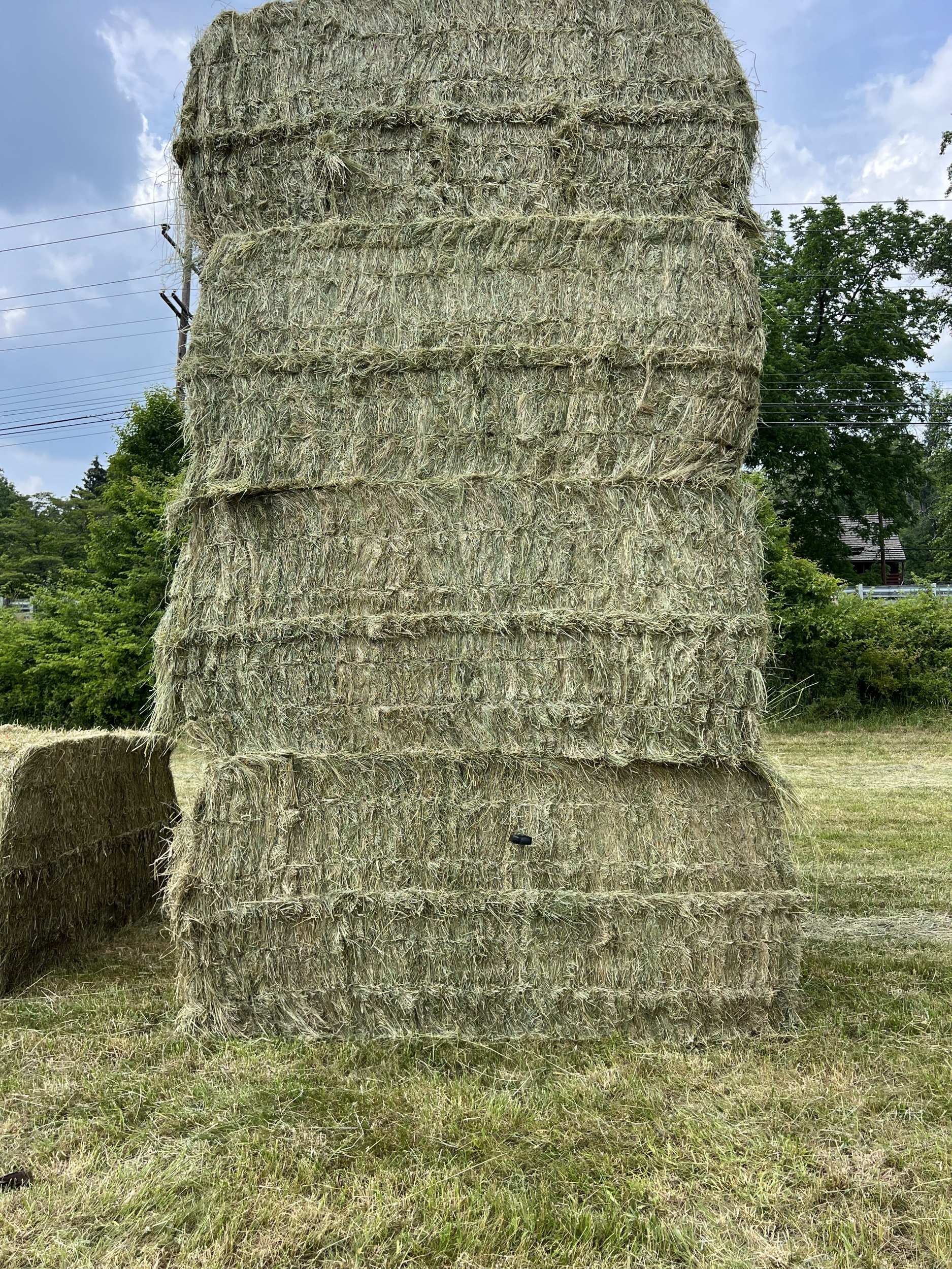

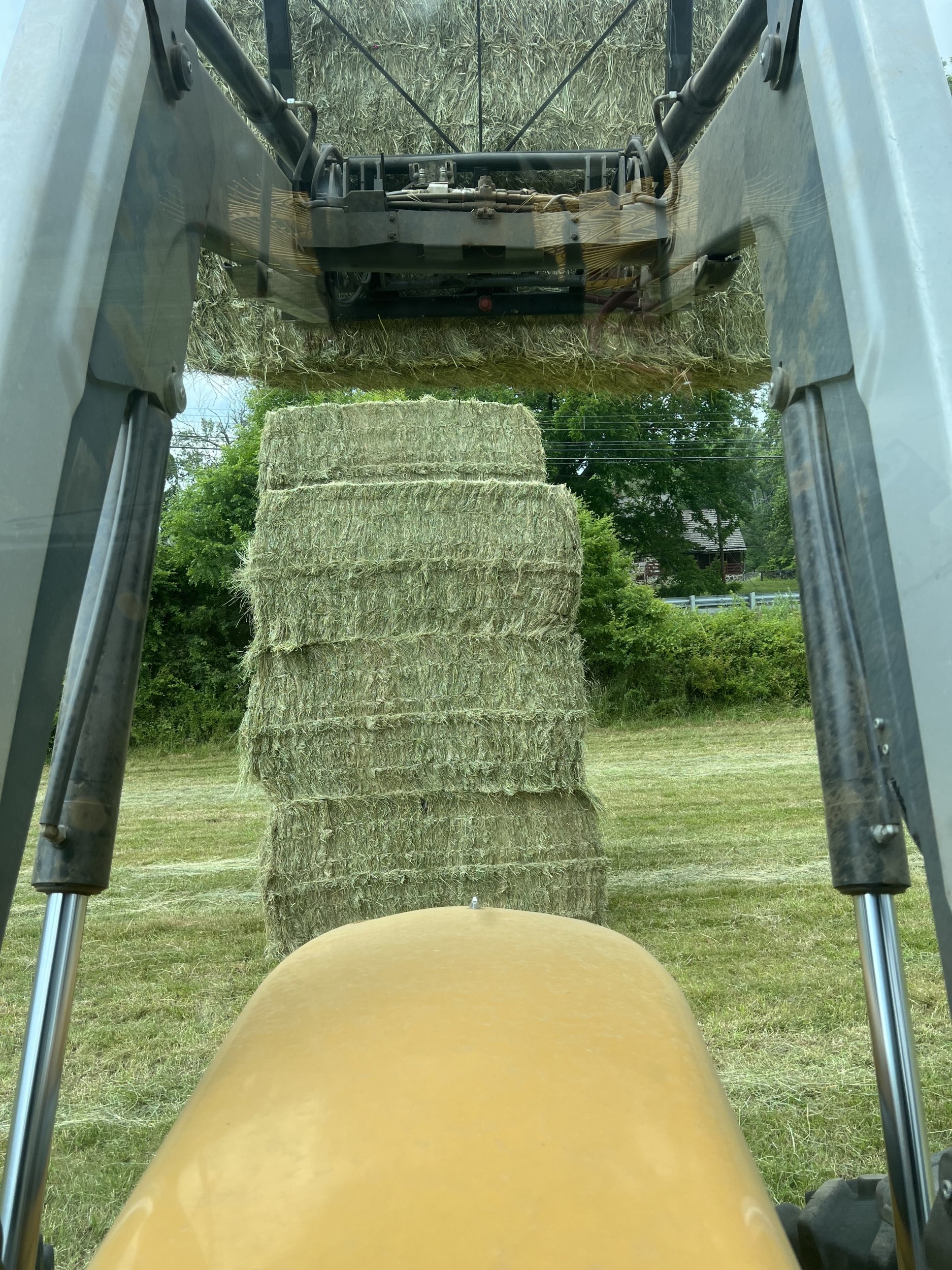

Here, I’m stacking bales 4-high.

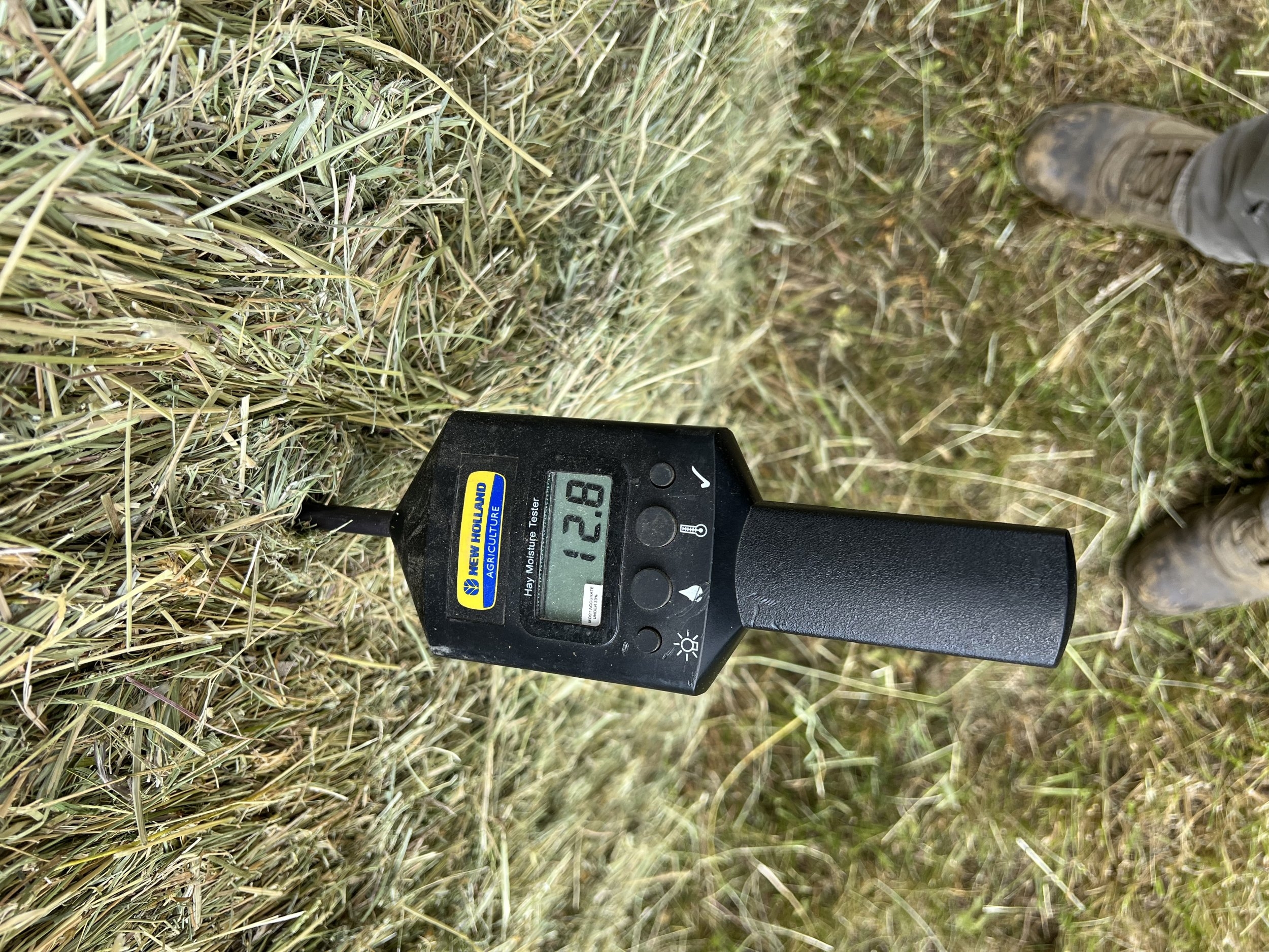

Tested some bales. Range was 10-22.

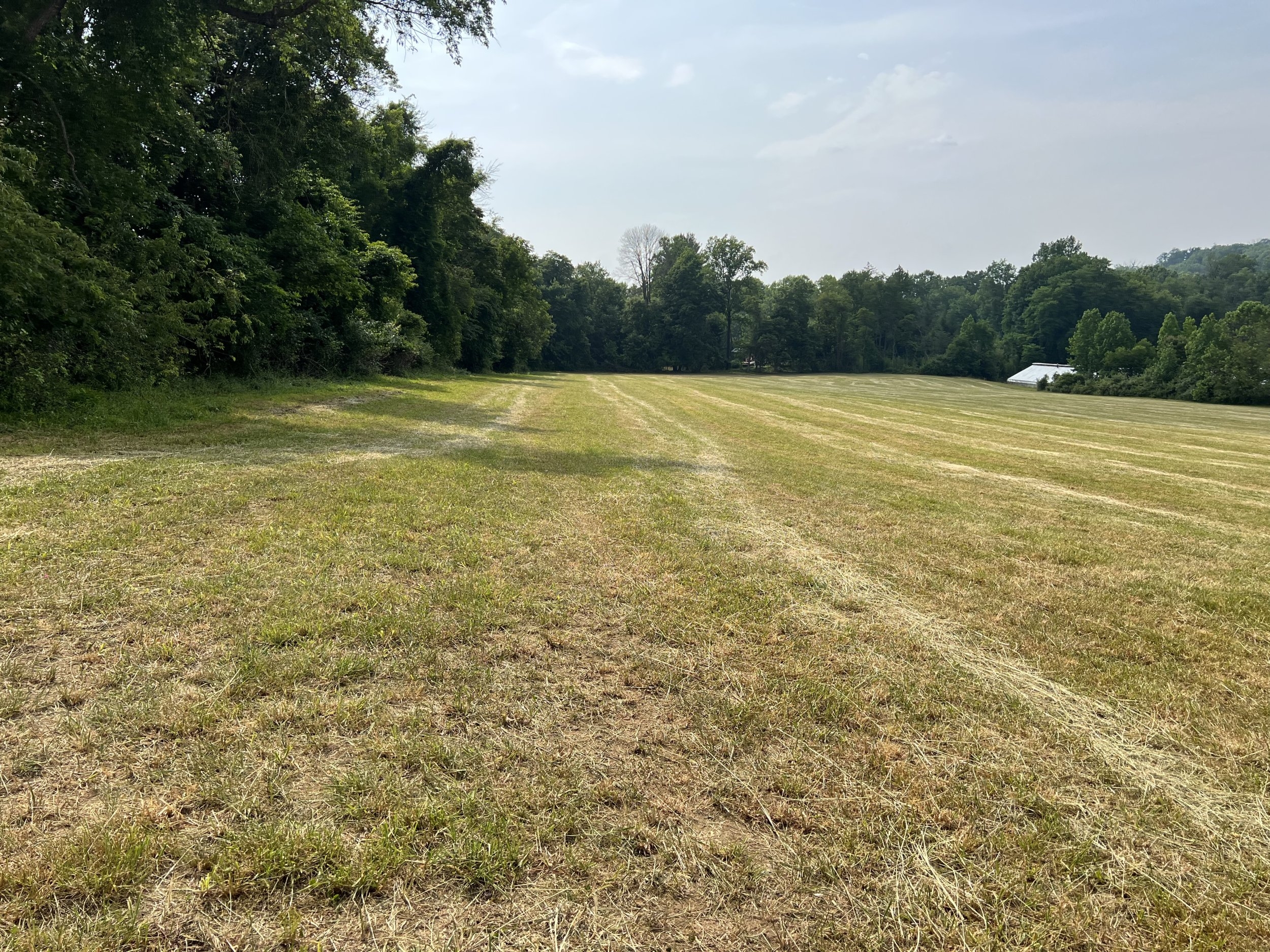

Field finished & ready for 2nd cutting

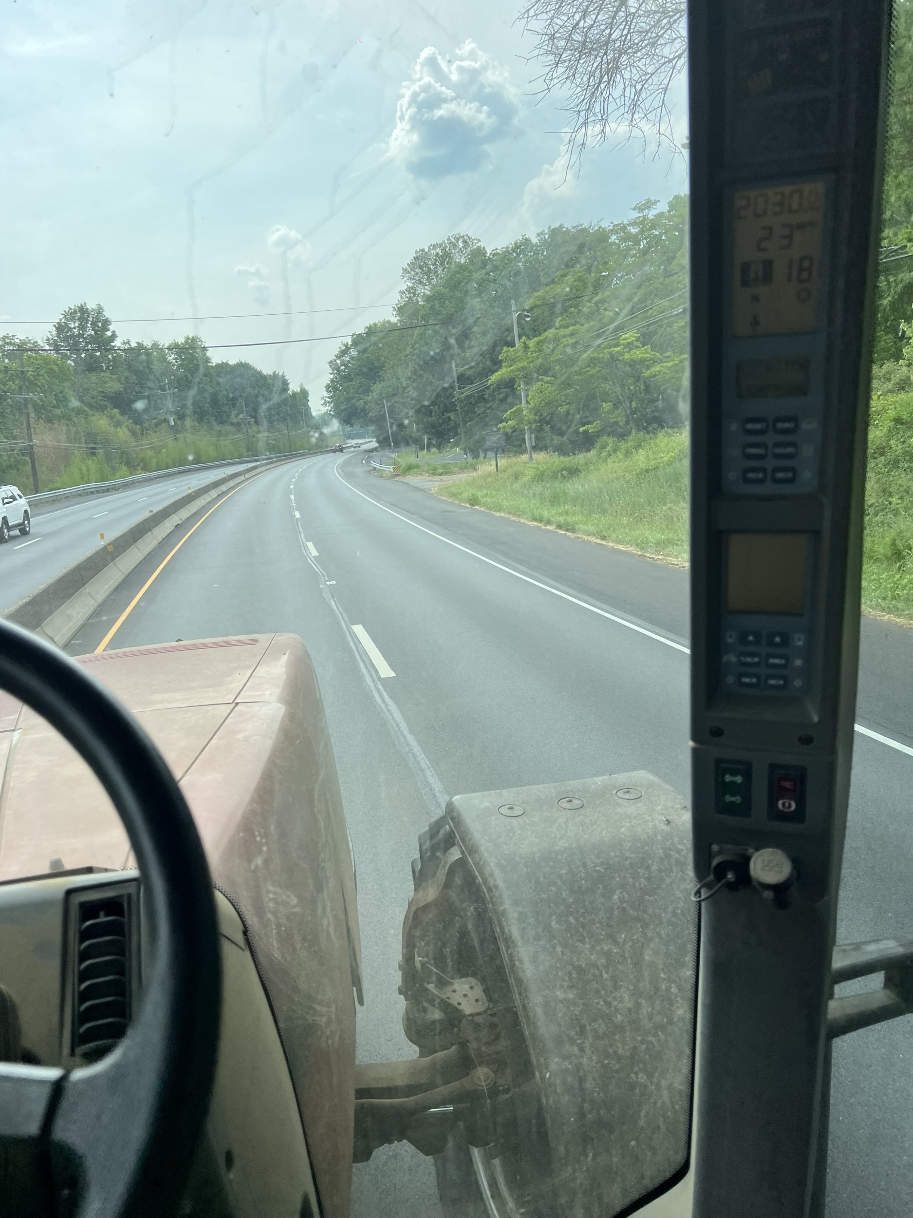

Knocked off about 5pm. Heading home. 18th gear, 23 MPH.
