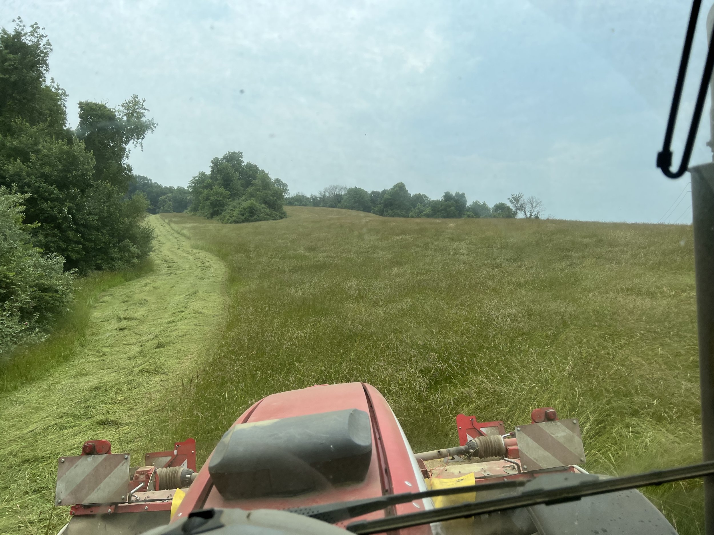

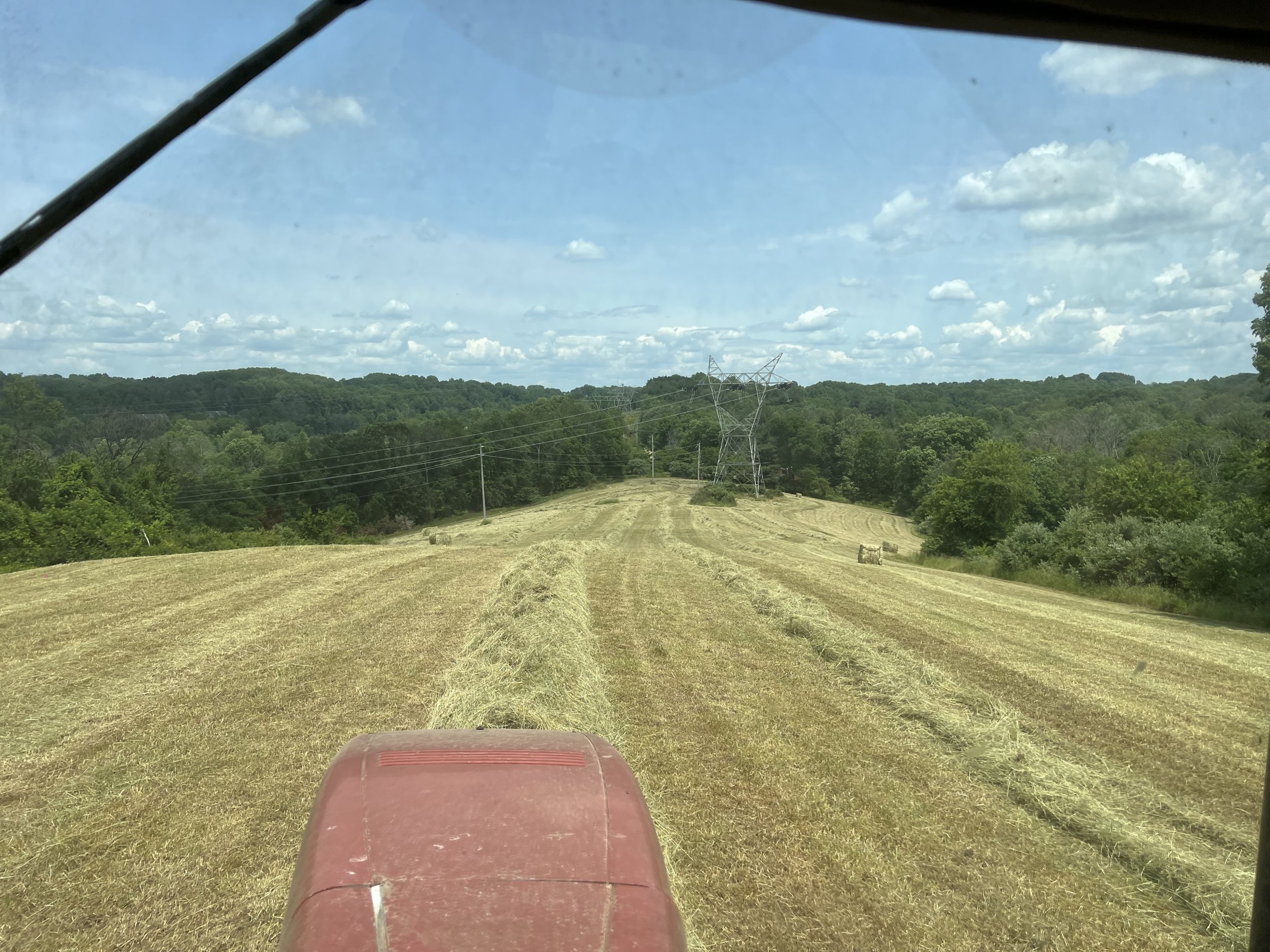

Here a 55 acre parcels we just started cutting with the Massey Ferguson MF7495 and Pottinger Novacat 351 disc mower.
This field is one of the highest elevations in my 400 year old township. Lore has it that while the Battle of the Brandywine raged, the townsfolk not involved in the combat came to the top of this hill and watched the fighting which went on for several days as Washington’s Continental Army battled the Queens Rangers and General Howe of The British Empire.
Really goes through your bones when you are in the cab cutting, thinking of the previous people who were here, what they saw and the hours of sweat poured into what is left of this ancient farm.
The wind was really whipping the grass tops around as deer emerge like ghosts and run off into the nearby tree lines.

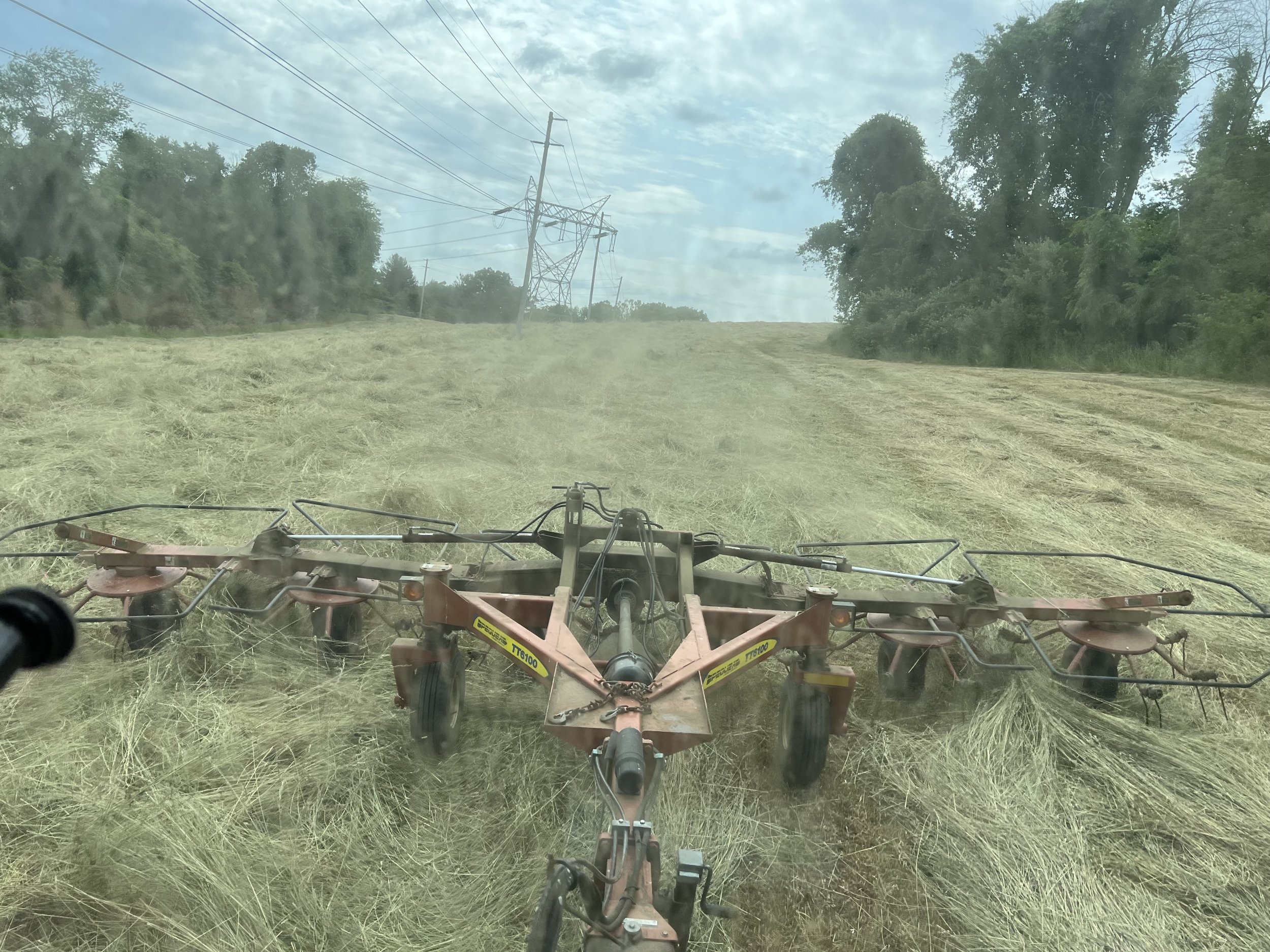

If the rain holds off, we will tedder this morning then begin raking & baling today and tomorrow. Weather has been very unpredictable.
I will add more pictures this evening.

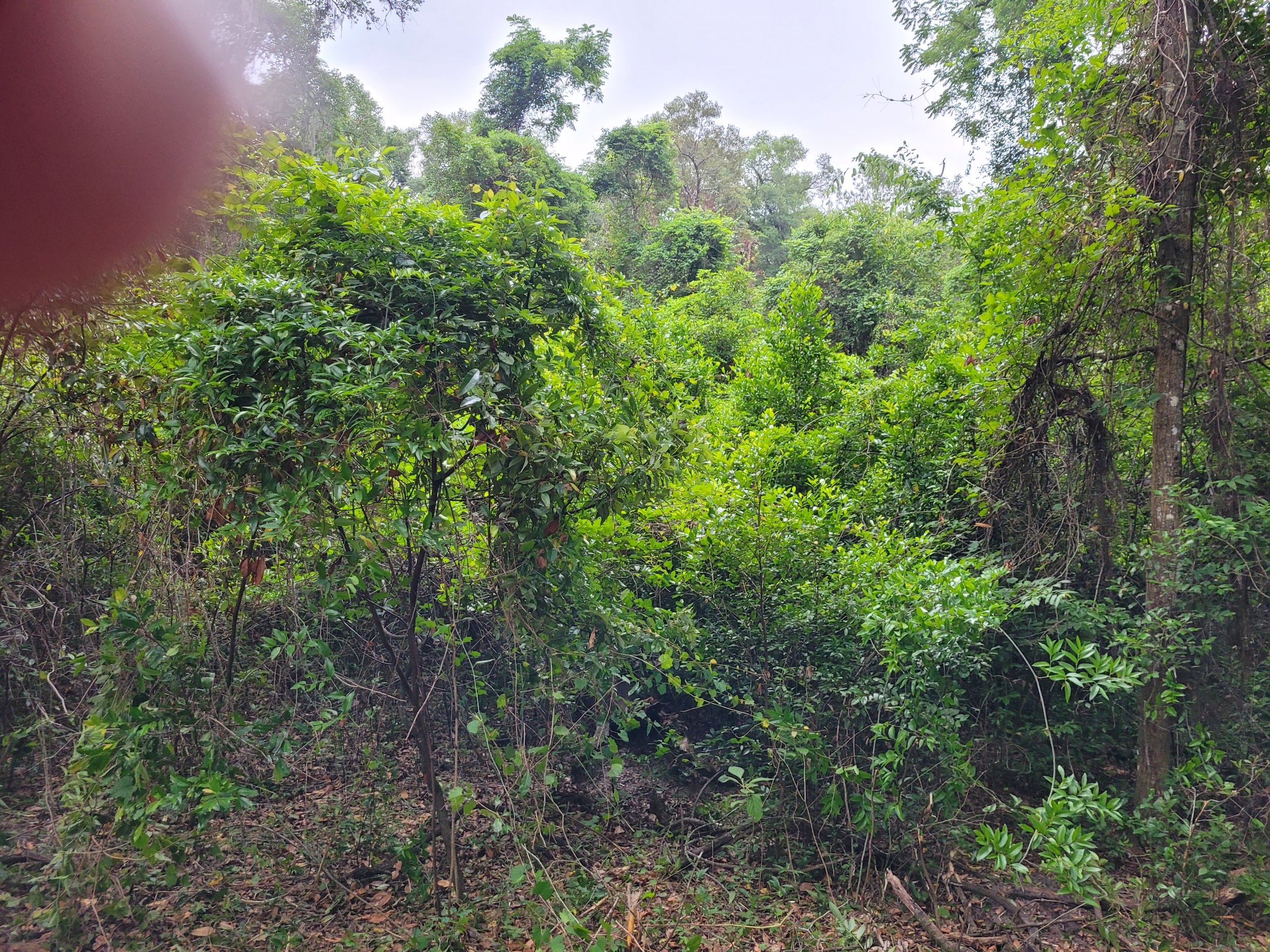

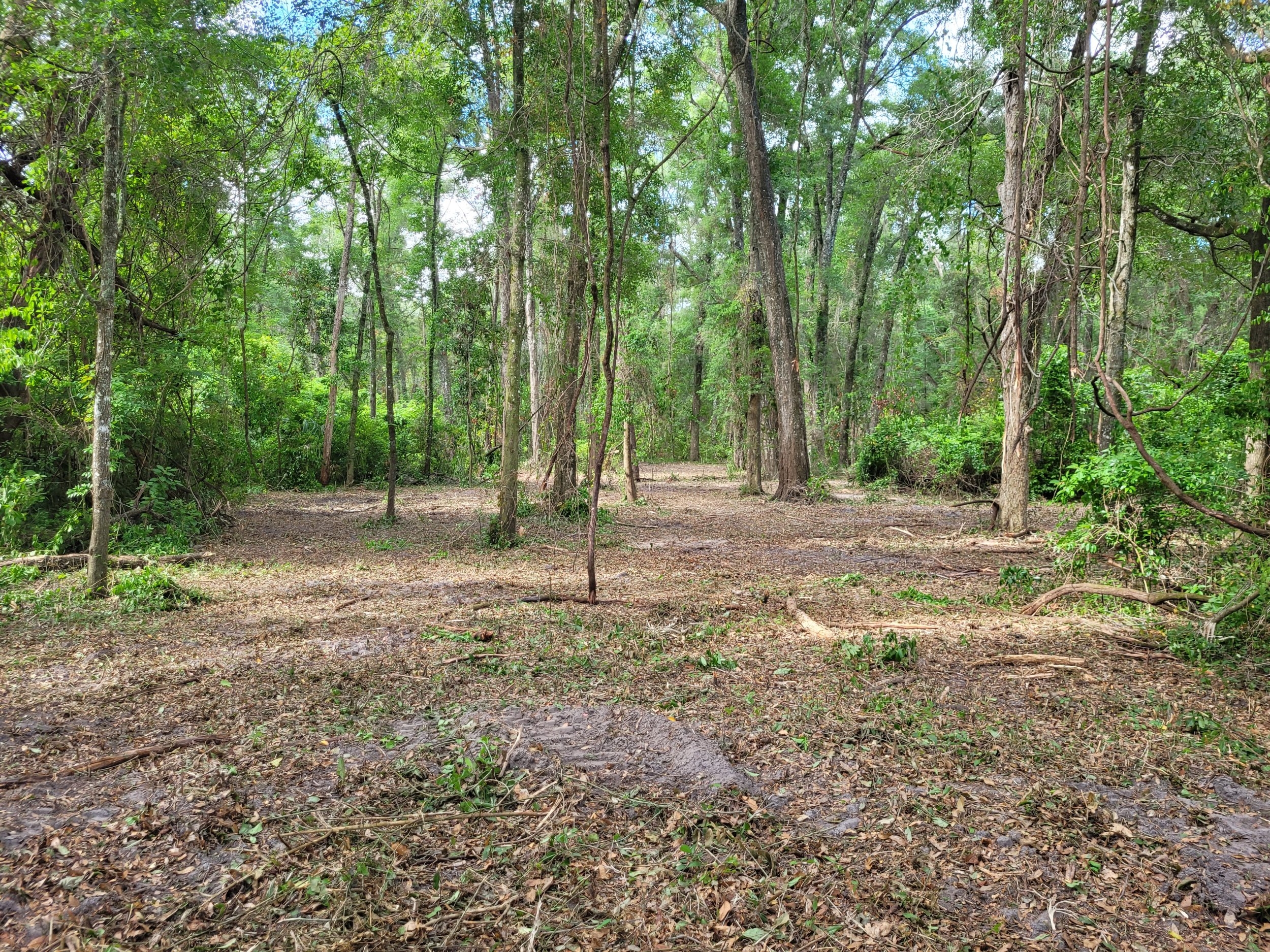

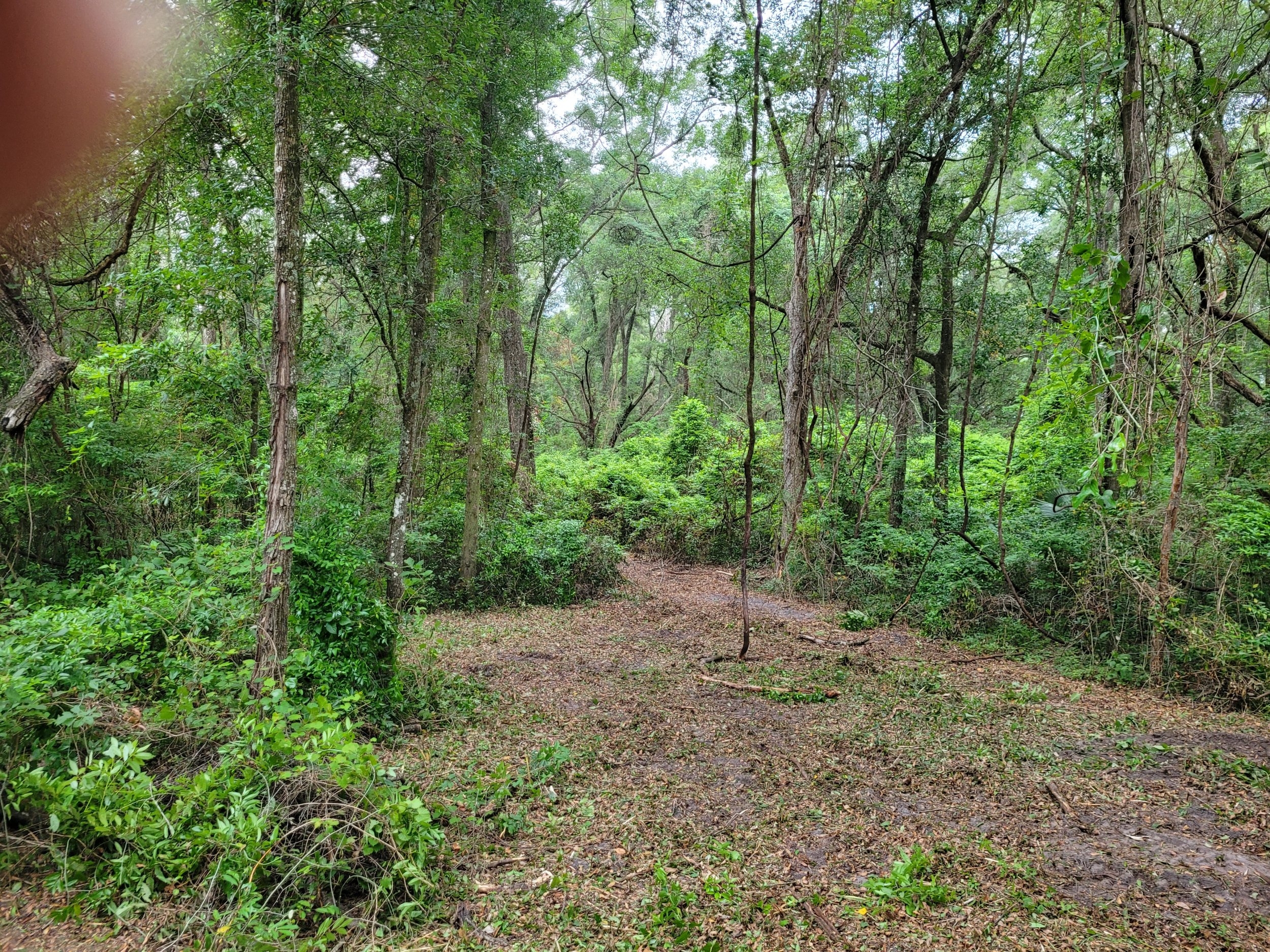

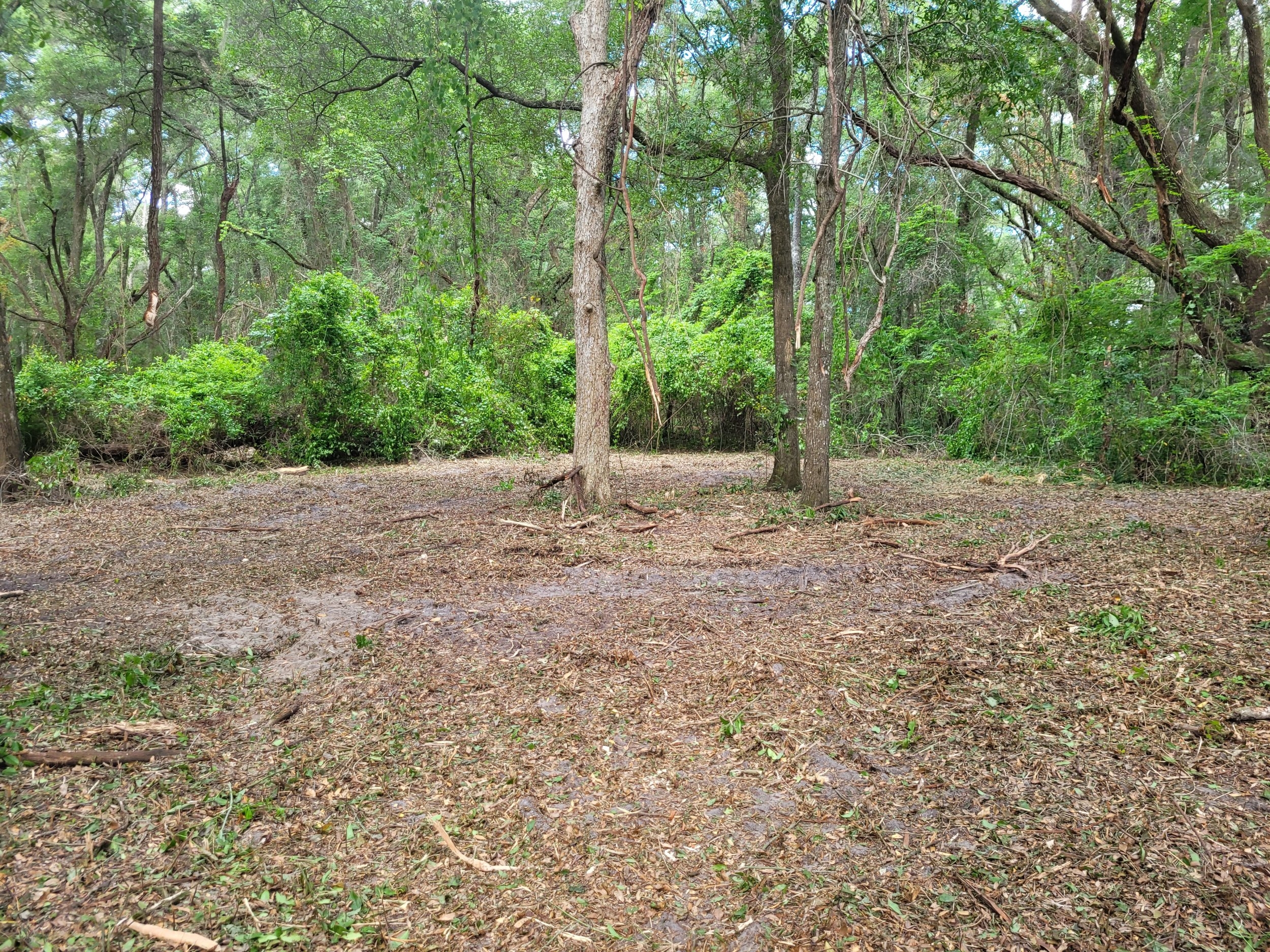

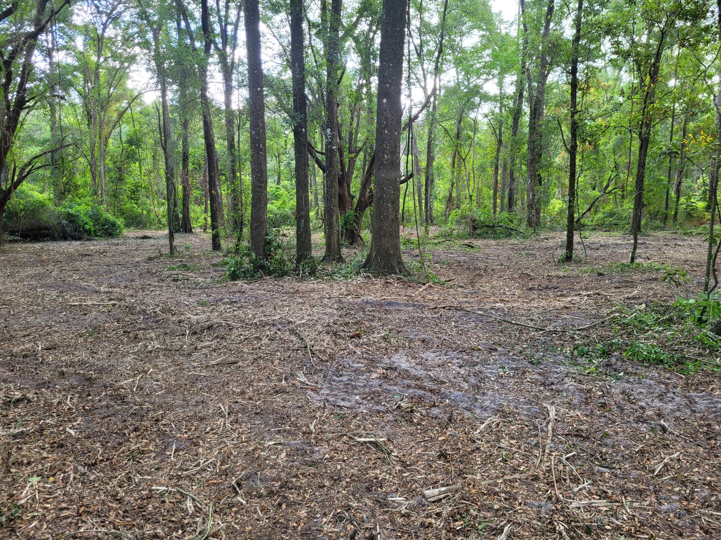

I really enjoy your before and after photo's, but where are the pics of your tractors?
I do most of the underbrushing with the skid steer and never really thought about taking or putting a picture of it in the post, I will try to do a little better job and make sure to include pictures of my equipment.:)

Back at it today. Cloudy & cool, but dray with a little breeze. Not the greatest baling weather. Good chance to make some organic feed hay.
Hooked up the tedder about 10:30 and went to town. Man is my back window dirty!
My son got there about 12 and we started raking. He’s doing well with the new wheel rake. The thing is lightning fast.
I started baling after he got a 5 minute head start. Had some problems getting the monitor to “talk” to the baler. Seems to happen about every other baling session. Have to re-boot it a few times.

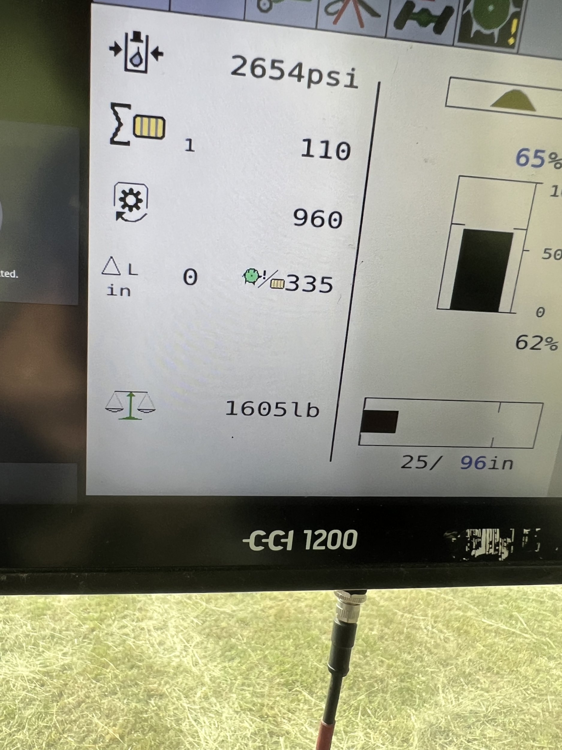

At 65% pressure, I can make a 1600lb dry hay bale. We were using 75% pressure Wednesday and they were running about 1750lbs.

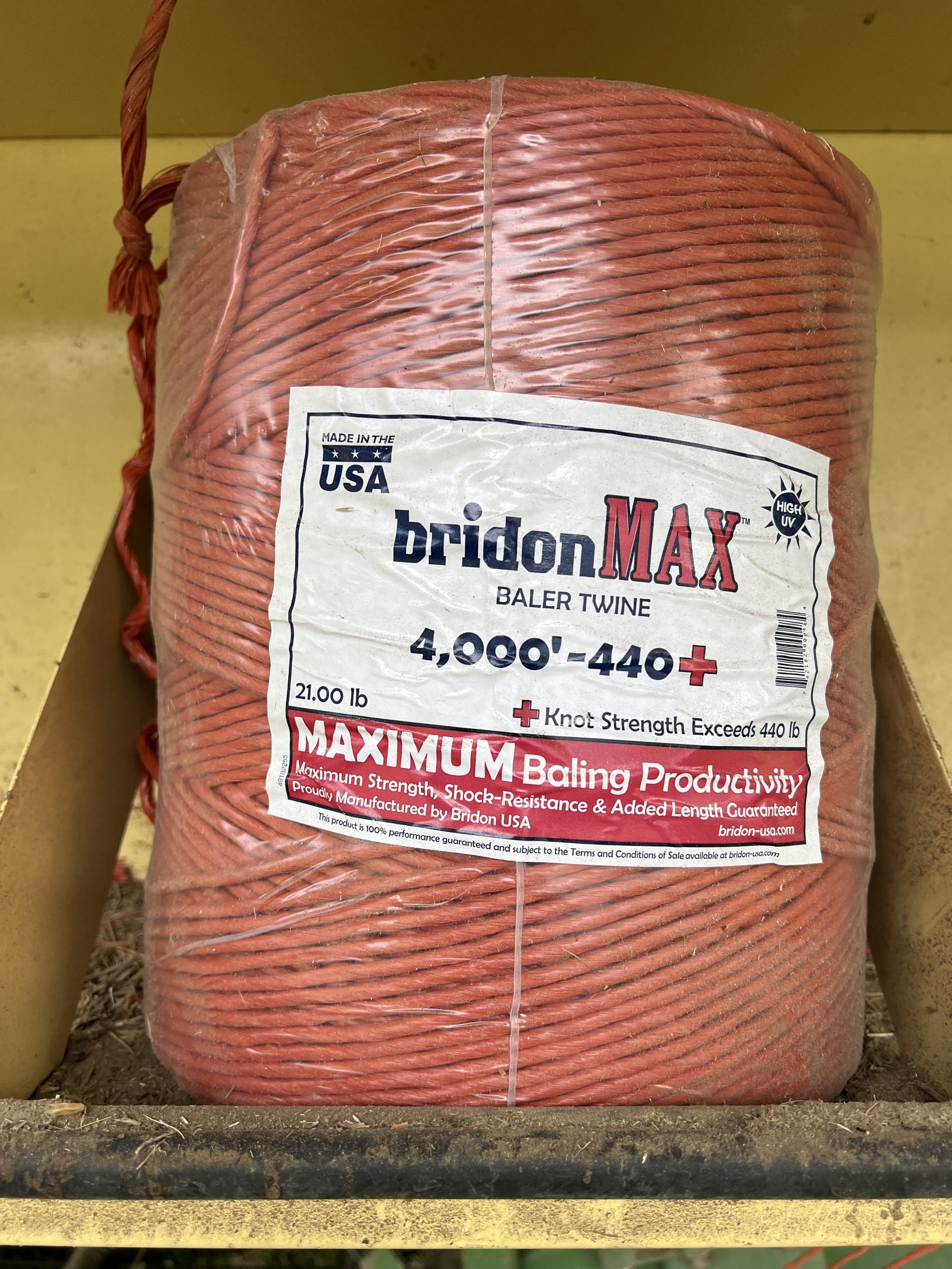

I was popping a string on about every 4th bale Wednesday and today. Had been using 440 rated twine, but I think it’s been in the baler since last year and may have deteriorated a bit. Not really sure. Had no string popping issues last year with same twine. Have had more than I expect this year.
I switched to the Bridon 550lb rating twine. Hoping that will help. 20 rolls was almost $1,000.
Prices for inputs are insane.

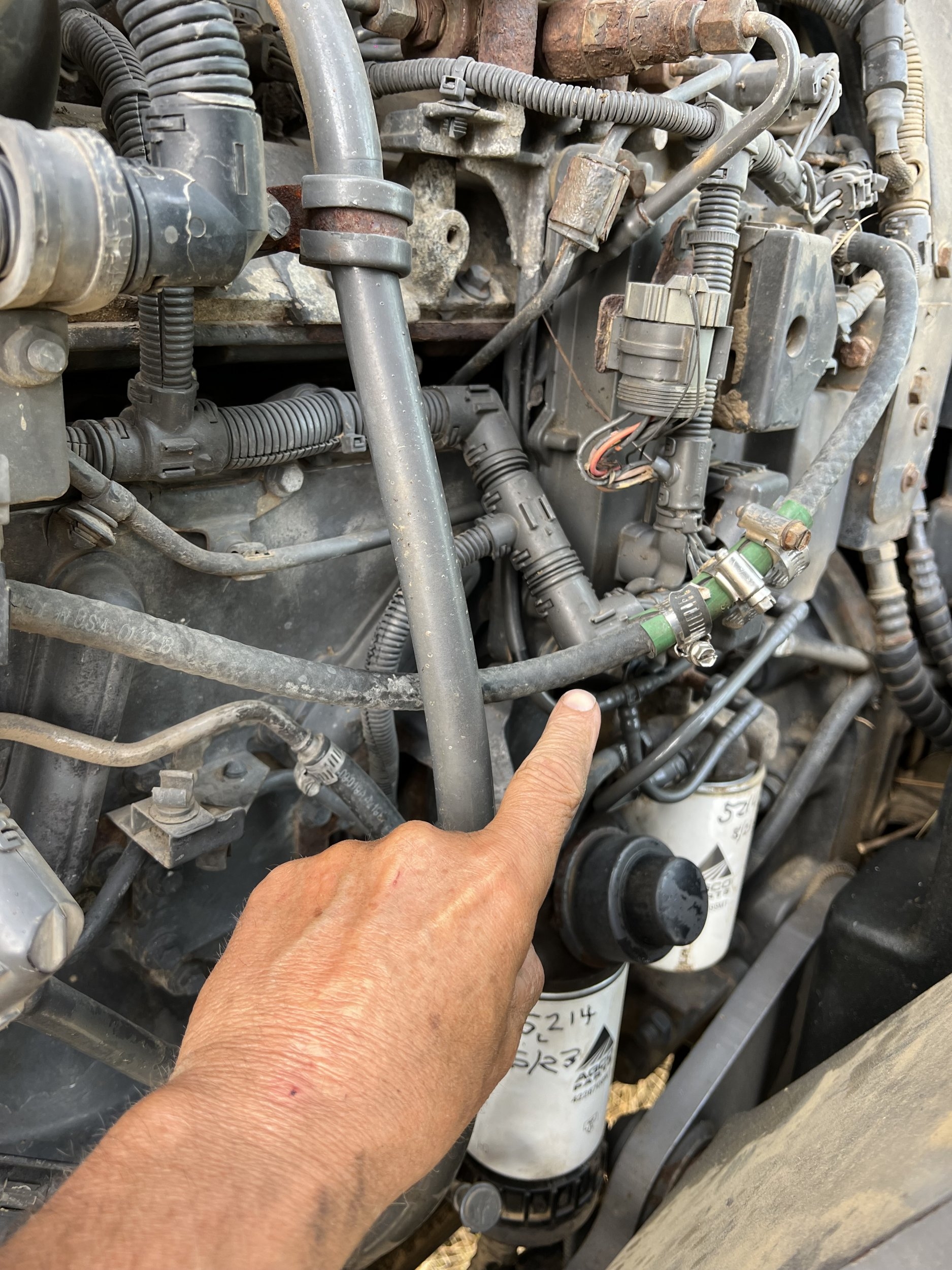

Wednesday, First time in my career I had 2 things break simultaneously. On the Challenger, I started smelling diesel fuel. Then it smelled like it was smoking. My fuel return line ruptured and started spraying the upper part of the engine block with fuel. Got it shut down before any kind of fire.
I had no fuel line and had to improvise. found some just slightly larger hose and slit it lengthwise. I wrapped it around the rupture and installed 3 small hose clamps over the hose.
Don’t laugh-it worked! Still holding now.

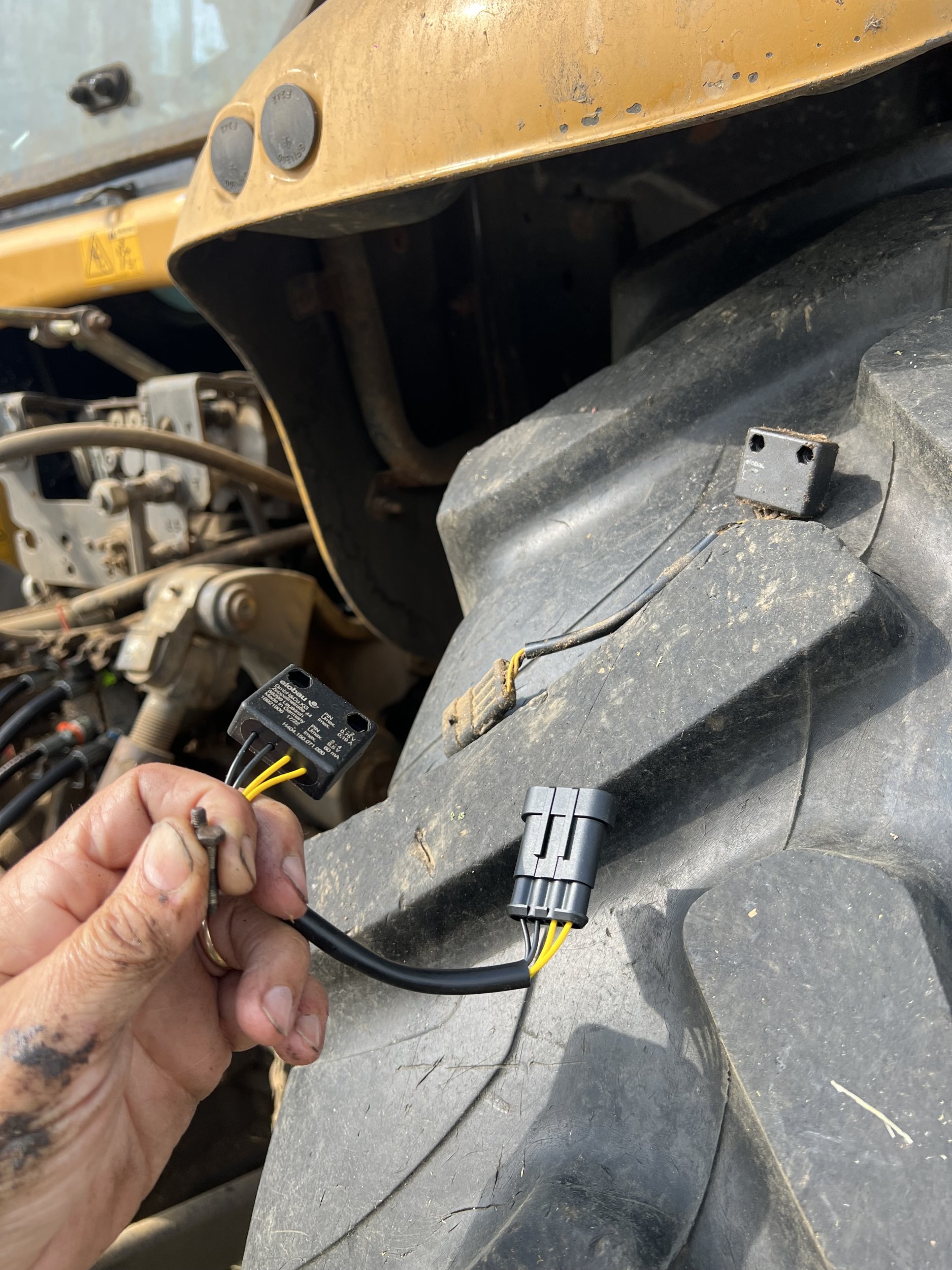

Jumped back in to start tractor and the reverser wouldnt allow me to move forward or reverse!! Turns out at the same time my fuel line ruptured, a tiny magnetic sensor that senses the position of the emergency brake lever took a dump. It sets off an alarm and renders the tractor immobile so you wont drive with your E-brake “on” and destroy your emergency braking system (very expensive). I had to disconnect the wiring harness from it to finish out the day without an E-brake. No biggie, but i lost 30 minutes trying to figure it out.
Agriteer mailed me the part and I had it on today.
