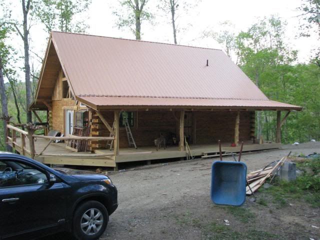

Porch roof is decked:
I got the insulation and purlins up there this afternoon. Tomorrow I will set the tin, then start spoke-ing the railings.

I got the tin and trim on today right before it started raining...pic's to follow..............

Thanks guys!.....here are final pic's of the front porch roof:
I went to town today and stopped by the hardwood flooring plant. I took a look at 4/4 sawmill cut kiln dried hard maple. I glad I made the trip, it is just going to be too much work to use. All of the boards are random width, so they would have to be trimmed. And I saw lot's of split boards, so the loss between damage and trimming would be about 20%, and a ton of work/time. Even though I have the saw and planer, I decided to switch to plan "B". I am going to look for flooring that is done, but un-finished. So far I have a price of $2.29 per sq ft...the scrounging begins.........
