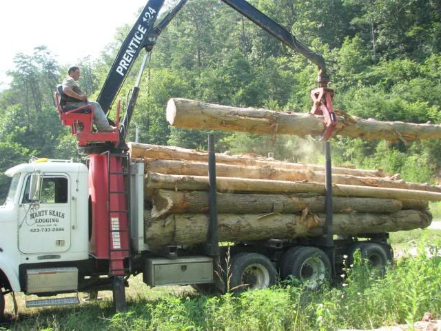

OK, a truck load of Hemlock arrived yesterday, and holeey crap they are big. 25' long and 5-6 of them were 24"+ on the big end. It looks like I am going to have my hands full milling them on my little manual LT15. Rafters will be cut to 5"x10".
I just ordered the biggest Cant Hook that LogRite makes...the 78" MegaHook to help in turning these logs:LogRite Mega Hook 78"
I have their 60" and I have to say it is the best Peavy Hook I have ever used..excellent product that really does not ever slip off the log.

You need another cup of coffee....the cedar is still waiting outside of Nashville for the 18wheeler. The Hemlock I just got are for the RAFTERS which I am going to mill myself. Comprende Senoire?:D
