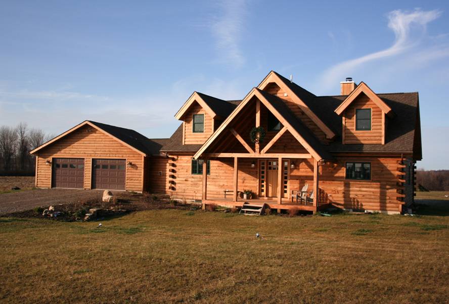

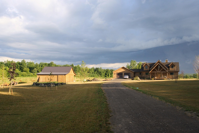

Great project, beautiful view. From someone who has built several log cabins (5 - 16'x20' cabins and a 40' x 80' pavillion) from scratch, I commend you! I'm curious what profile you are going to mill the logs to? After building the above mentioned cabins stacking logs and chinking between, when it came time to build our house, I chickened out and went with milled logs. The logs on our house are D shaped (flat interior walls) with a tounge and groove between each course. On top of the tounge sits a foam weatherstripping. So far (4 winters later) they still seal very tightly. I'm thinking you could manage the same thing with milling your own by dadoing out a groove on the bottom, and nailing a batten on the top for a tounge. Just curious what your plans are for sealing.
Also, excellent choice on the wood. I have to spray 4x per year for bugs and bees with Eastern White Pine. The cedar should be much more resistant.
Good luck with the project, and remember to sit back and enjoy it every once in a while. I was under pressure from the bank, and really didn't enjoy it as much as I would have if I had less time pressure.
