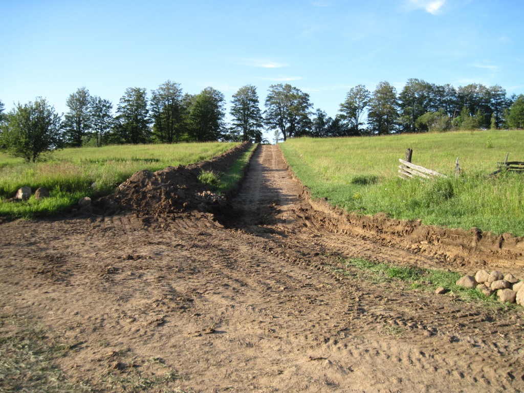

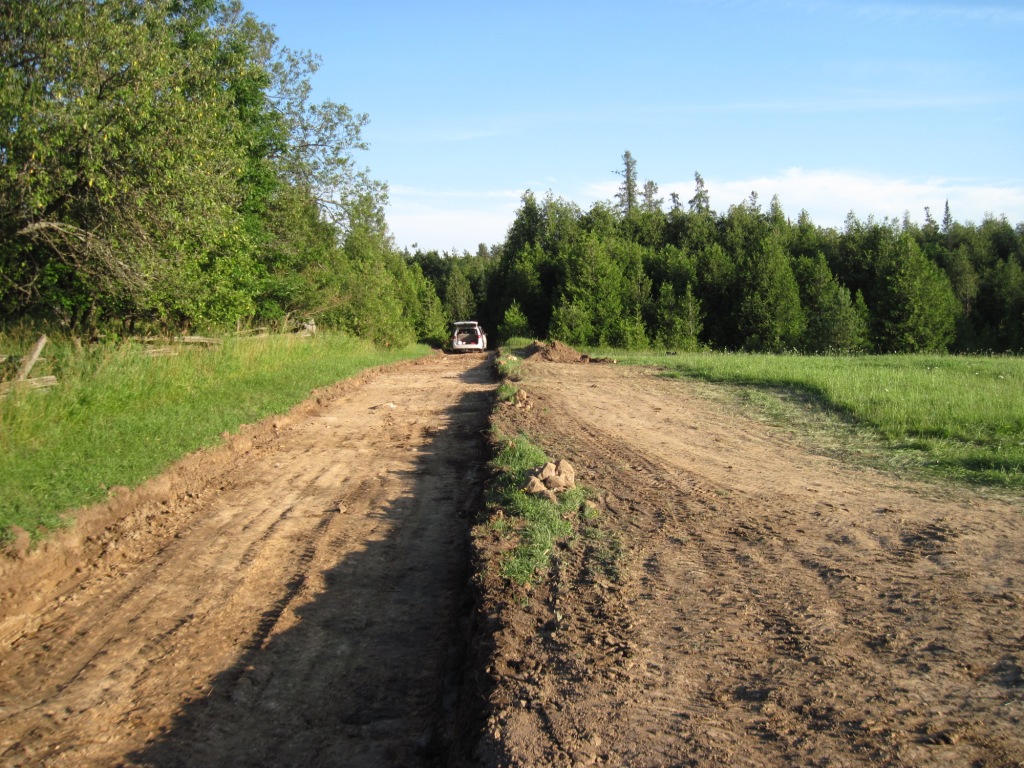

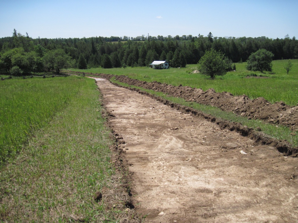

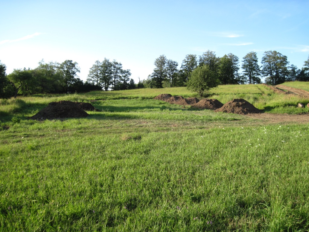

Just a quick update of the project. Taking the good advice from you guys I asked my neighbour to came with his toy and dig out the entire top soil. He worked for all day digging out 12" or more in some spots, so now the driveway is ready for the geotextile and gravel. Also, I got a quote for gravel (up to 6") at 5.5$/tone delivered.
My son is very happy as he already started to laydown the trailer bike with soil removed. I attached some pictures for reference.

You sure have some beautiful land. And so much dirt!! My drive is a mile long and may have as much dirt as in one of the piles -thumbnail, far right. I have rock & gravel resting on basaltic lava. Makes for interesting drive construction and maintenance.
   / The new 700ft driveway #14
Looks good. Got any side ditches in mind? Or will you keep a trench for water.:)

Yes beautiful looking land and by the way... where are the rocks???
