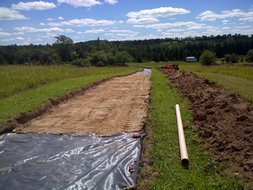

Just a quick update of the project. Taking the good advice from you guys I asked my neighbour to came with his toy and dig out the entire top soil. He worked for all day digging out 12" or more in some spots, so now the driveway is ready for the geotextile and gravel. Also, I got a quote for gravel (up to 6") at 5.5$/tone delivered.
My son is very happy as he already started to laydown the trailer bike with soil removed. I attached some pictures for reference.

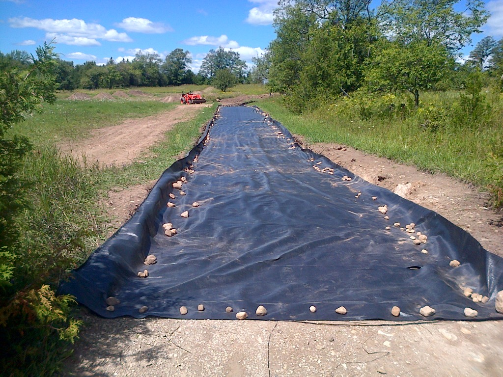

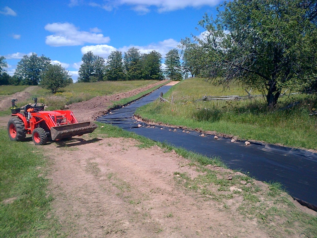

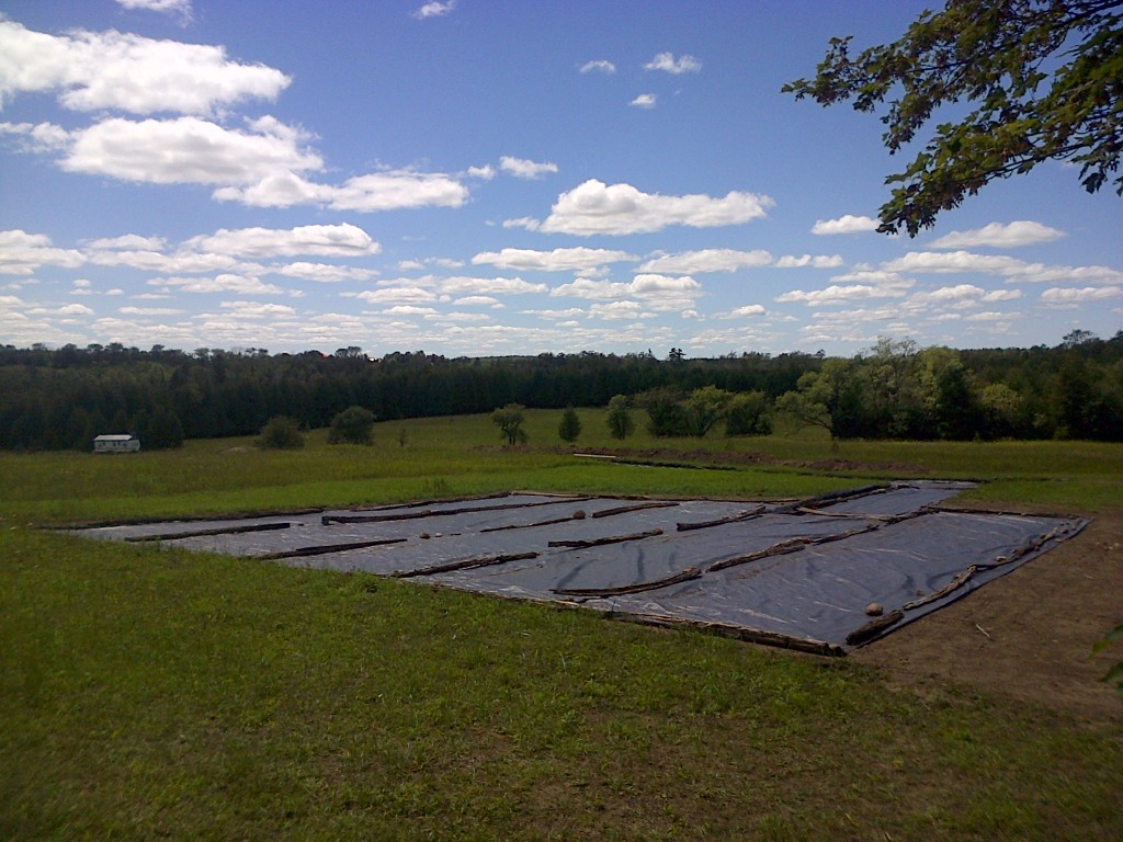

Just another update of the weekend project. I was able to laydown the geotextile material on the barn site and driveway but, I still need another 150ft of material. I think I will ignore it and not spend another $400 for a roll of 450ft; in special that portion is on the hill. To be sure the wind will not blow the material I used a lot of stones and some cedar logs (I attached some pictures). I hope the guy will bring the gravel next week and then I can rent a compactor to play with it and start using the road as is so annoying living the car at the entrance and walk with all the staff.

I've never seen anyone dig a flat trench and line it before gravel ,I'll bet it won't last a year with no way for water to run off it will turn into a mud pit , and why would you start laying the cloth on the flat section instead of the hill first ? I wouldn't have dug down at all instead I would have built up and added run off from the center with drainage trench on each side to carry water away from it ,The way it looks to me is the water will run into it and mud city here you come .I suggest you lift the geotextile and lay tons of crusher run gravel up to 3 inches above the grade dig runoff trenches compact it all then replace the geo material and another 4 inches of gravel compacted . I hope it works out for you .
