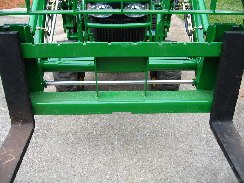

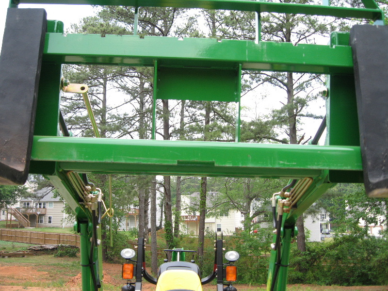

Hello Chris - would you mind posting a closup of the fork carrier from above. I have a set ordered, but nothing has arrived yet! I would like to weld a reciever to the carrier for a 2" tube steel boom pole and I wonder if the alignment would allow that tube to clear the grill above. How easily can the forks be removed from the carrier if they got on the way of a bit of "crane work"? Thanks.
Yes i will try to get you some close up pics of the carrier. yes the forks come off real easy. though the tines are heavy.....:)

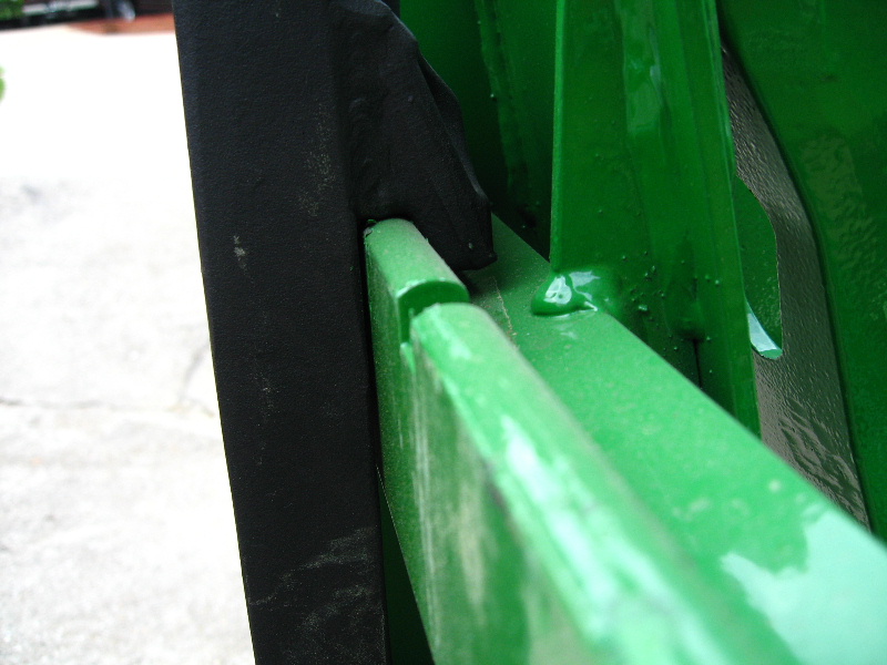

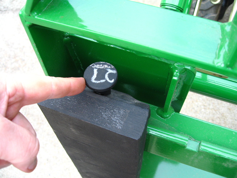

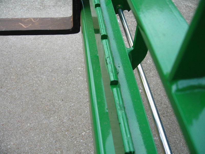

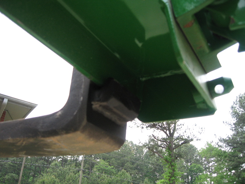

Here you go tuolumne.
here is a close up of the pallet forks. i have them in the wide setting. you can see the spring loaded pin i am pointing to you just pull it up and thay slide in or out. if you want to take tines off. slide to dead middle. and lift up.
i took some pics of the rails. these are rail fixed forks. you dont want floaters. or you cant get under stuff very good. i even posted the part number. and there frontier and made in the USA...:)
i took the bucket off and snag the forks to take this picture. all of 30 seconds.
see the duel carriers. the top pin is for 2000 and 3000. the bittom pin is for 4000 series.
notest my pins are black. i had to paint them. as i modified them. i did not like the slack in the pins , so i welded them bigger and reground the flat edge , for a perfect fit. i dont have that slop in the bucket no more . its a snug fit. but pins still slide out easy. :) JD could have done this. and made it fit right.....:rolleyes: but there not me. I want it right.....:D

You have been extremely helpful and done far more than I requested. You've restored my faith in the innate kindness of my fellow man! It looks like my plan won't work or I could never take the forks off. Maybe I can do something behind the carrier. I think I'll hold off fabrication till the machine arrives. Two more weeks :eek:
