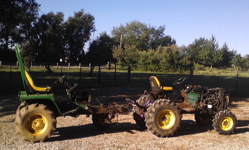

Although it's is still stripped of most of it's sheetmetal and body panels, the 955 was given its first task Sat. morning. I needed to move the 3-legged parts donor to a more permanent spot. I made a deal to sell it's wheels and tires, so it needed to be moved to more long-term spot since it was about to become a lot more difficult to move. Used a drawbar in the 3PH to pick up on the front end of the donor and tow it to the new spot.
Here's a pic of the "tow truck":
I got my new front tires mounted today. I must say it looks a LOT betteer with the correct size tires on it. It was too late (getting dark) to get a pic with the new tires on it.
   / The old girl is coming together.... #27

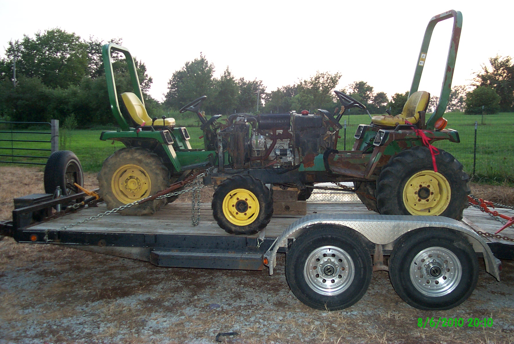

looks like fun pulling that 855 around. What really is left on that 855? i just see the frame, tranny, operator station, ROPS, and sheetmetal. Are you planning on using the sheetmetal from the 855 for the 955? :confused:
#28
What's left on the 855:
complete transaxle w/ rockshaft housing and SCV's
2/3 of the front axle
frame
steering clyinder
steering column and vavle
main driveshaft
misc. sheetmetel
ROPS
misc. other parts
seat
operator's station
steering wheel
fuel tank (front mount)
pretty much all the linkage and pedals/levers for everything
I have the ROPS for the 955 and all of its sheetmetal except for a grille and the engine side covers. I plan to sell off everything I can from the 855. The ROPS that came on the 955 is the extra tall version (for use with a backhoe) but since I have a lot of trees, I will be swapping the regular height ROPS from the 855 onto the 955.
I think the 955 looks kind of neat without the fenders, but I will most likely put them back on after they are cleaned up and repainted.
Here's a pic of what they looked like when I hauled them home:
