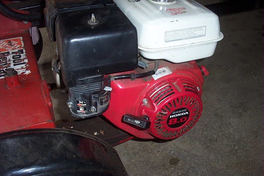

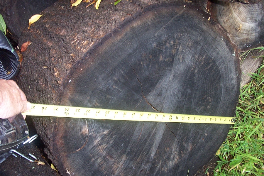

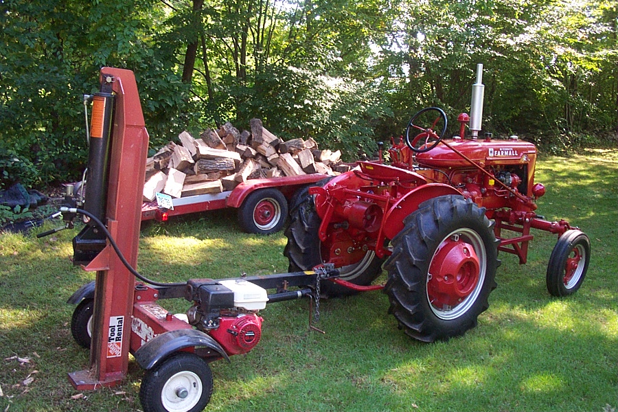

Good Mornin Acohen,
Im not really sure I should even be commenting on splitters because I have only owned mine for the past year ! So with that said Im certainly no expert and did the whole thing all these years with two mauls, 8 lb and 6 lb, along with some wedges and a 10 lb sledge :(
I bought my splitter from an HD rental locally. I payed about $735 used, although the unit only had 100 rental hours on it which I equate to about 70 hours of actual use. A friend that works there gave me the tip on the unit going up for sale and I jumped on it !:)
I really like the unit because of its vertical option, at 57 I cant lift 25" oak rounds, heck I dont think I ever could ! ;) What I find that works for me is, quartering a bunch of these monsters, and then tilting the splitter up in the horizontal to finish the job ! Im pretty a one man operation here so I have to go with what works ! In the horiz pos the splitter height is about 34", which is not bad IMO !
As a side note I really like Ductapes' work platform, and I might look into fabricating something like that, but make it easily removable in case it got in the way !
Back to the splitter, it has an 8 hp Honda and looking into the manual I believe it generates 27 tons of force, which honestly will split anything, and if it doesnt split it, it will just cut through it, crotch, knots etc...
Im also aware that if you bought the same unit new your in the neighborhood of $2500... ouch
Anyways, thats some of my feelings on this Speedco unit.....

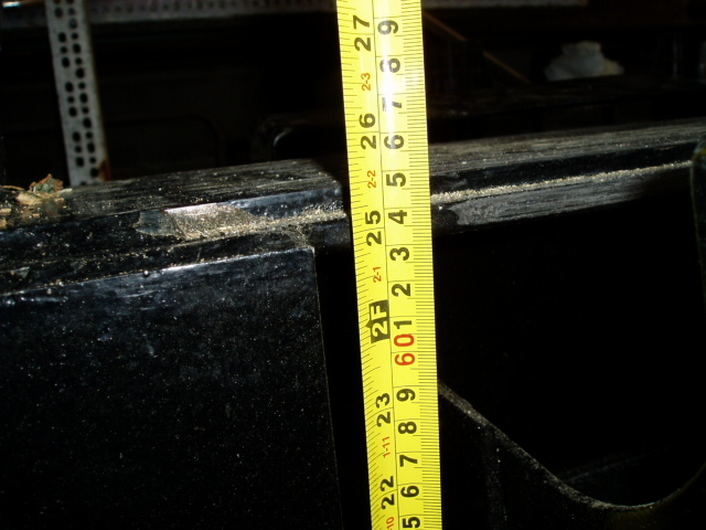

The Troy Bilt 27T splitter w/horiz/vert. rail has a working height (at rail) of 25-1/2" in horizontal position. I'd wouldn't care if it was an inch or two higher. (I'm 6'5") All in all, I'd think 1-1/2" shouldn't hardly even noticable and NOT having vertical position would be a deal breaker for me.

The wheels are the same distance from the rail surface in both vertical OR horizontal position. Not "less friendly" in EITHER position. The orientation to the wheels is all relative to the pivot point and where the axle is located front to rear. Done properly, like this one seems to be, there's no crowding issues at all. All things being equal, even if the wheels WERE closer to the rail in vetical position, that has no effect on the height of the wheels in regard to the height of the rail. As I mentioned, I don't like using the splitter in vertical position, but it's extremely handy to be able to do so when the need arises.
Another reason why I like the pivoting rail, it swings up out of the way of servicing the motor.
