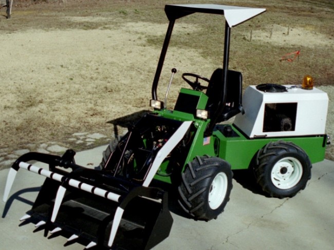

"" I find right foot down to go forward, and right toe lift to reverse is working just fine. Open for comments. ""
That method may be OK for mowing or just moving around on level ground, but you MUST learn to use both pedals!
When on uneven ground, both work best!
Quickly moving in, out, and around while mowing, both are best!
When moving in to pick up a load, both work best!
Moving a MiniHoe bucket into position, both work best!
I use both feet to slowly ascend and descend the stairs of my front porch. That would be impossible using your right foot method!! Just right foot might work OK going up, but backing down the stairs I must use the reverse pedal to move across the treads, and then quickly use the forward pedal to slowly and smoothly descend the risers!
Two footing was difficult for me at first, but now after 30 hours of practice, two footing has become nearly intuitive.
PS: Install a Suicide Knob to make your steering quicker, easier, and safer!!
Attachment: My PT-425.
/forums/images/graemlins/grin.gif /forums/images/graemlins/grin.gif /forums/images/graemlins/grin.gif /forums/images/graemlins/grin.gif
