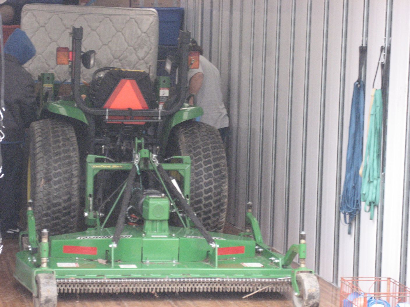

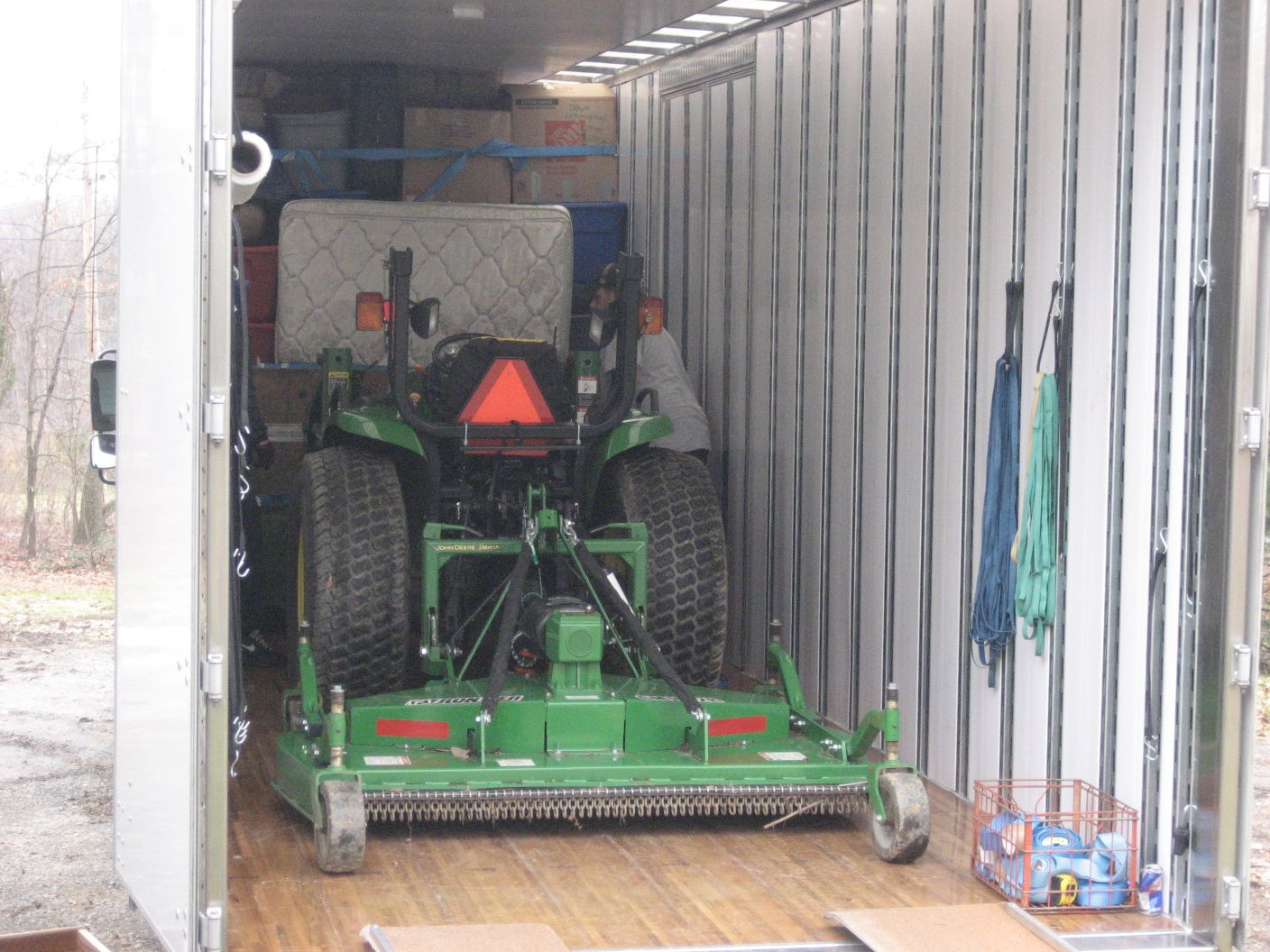

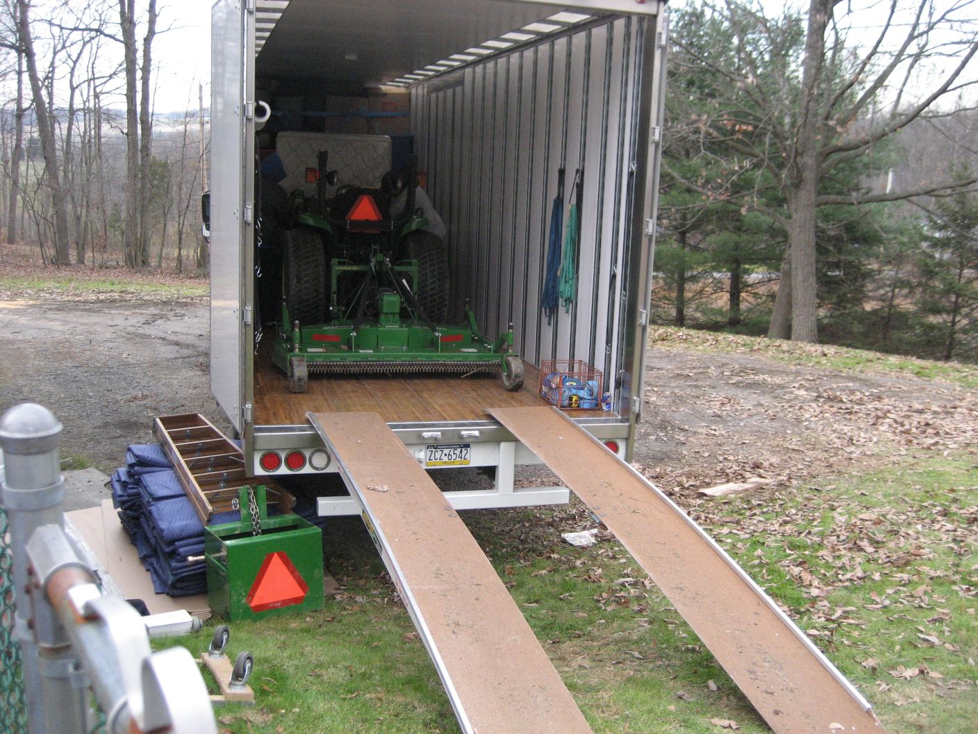

Just so ya know...
That was the moving van with a GVW of about 26000 lbs (or a bit more) when we moved to Vermont.
By the time they were done, you couldn't even see the tractor or mower.
