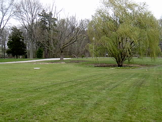

I use a TC18 with R4's and 60 inch rear finish mower as my primary mower on 3.6 acres. I think it does a great job (see attached photo from April 26). Even though the TC18 is no longer available, the TC21 and TC24 are essentially the same tractor, only with bigger engines.
I think it's the perfect sized tractor for my lot size, and it gets used for a little bit of everything else beside the mowing tasks. I can't say enough good things about it! /forums/images/graemlins/cool.gif
I have several wetter area on my property, and I think if I had turf tires, I'd be spending too much time spinning my wheels! /forums/images/graemlins/crazy.gif
