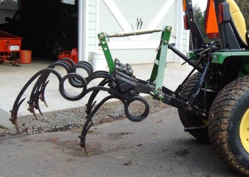

If you back off on the need for the BH (could drill holes with a PHD for plantings a lot cheaper than with a BH), I'd say to look at the JD 4010. It could use some of the old implements, as it has full Cat 1 capability. I paid $13,300 for mine with 410 FEL and LX4 cutter. If you bought a something like a KK cutter, you could get the lot for less than $13k.
The 4010 has 870 # lift capacity at its draft arms vs. 1,000 # on an old much bigger tractor, a JD M, of the same hp. It's wheel width, even with its hugely wide turf tires, is a right at 48". The LX4 at 4' 3" sticks out a tad on each side.
Here's a pic of my 4010 with the JD M soil ripper on it.
Personally, I wouldn't buy a PHD, just rent one. Might consider renting a BH if you really need that, too.
