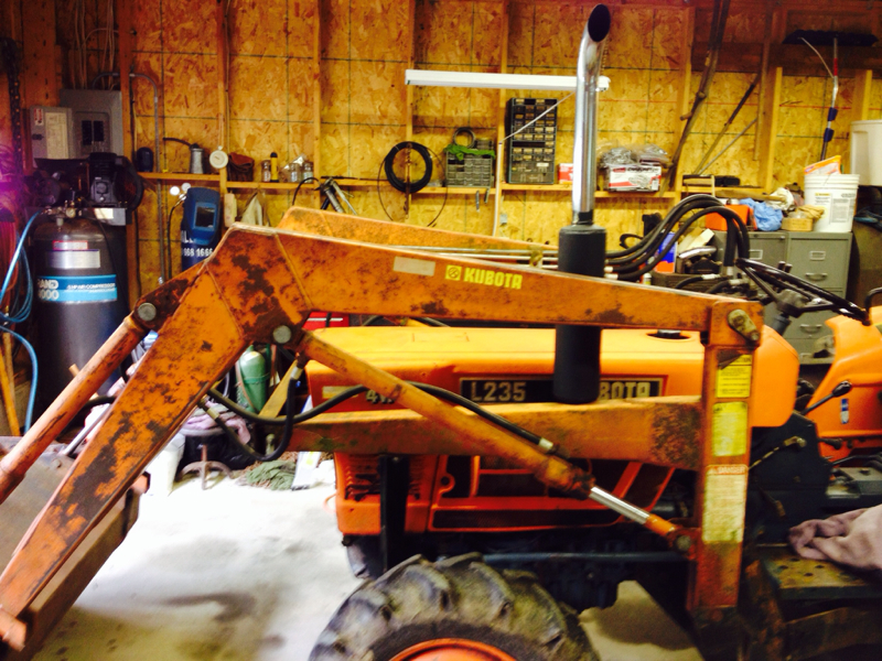

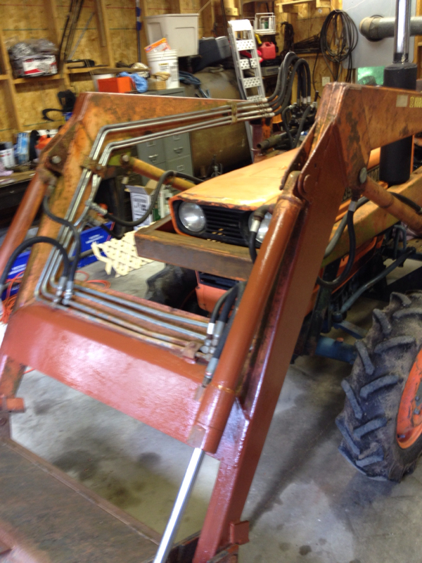

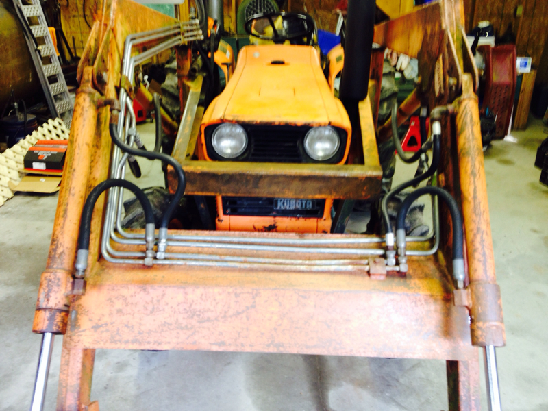

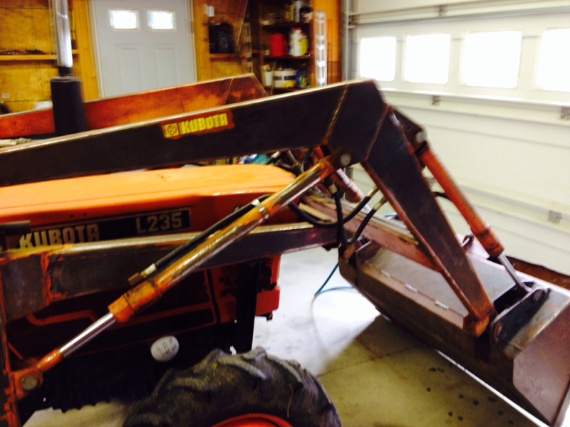

Thanks for all the suggestions so far - primed most of loader as seen in pictures will get the hood and fenders next tell me what you all think I used majic oxidized primer.

As you can see I still have some spots to get but I'll get there

Good start - you may want to unbolt your hyrdo lines as you will get a better paint job and it often saves time over masking them.
Yeah I was thinking about that I think I will then ill primer the, and paint the orange too I'm just happy to have most of the rust gone for now

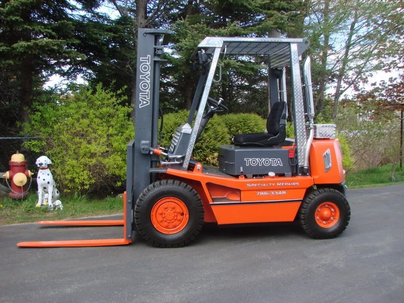

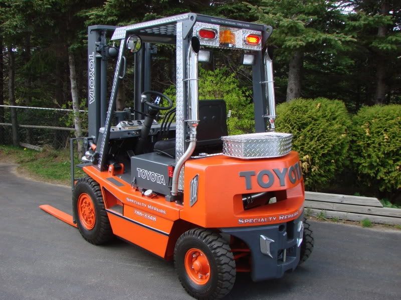

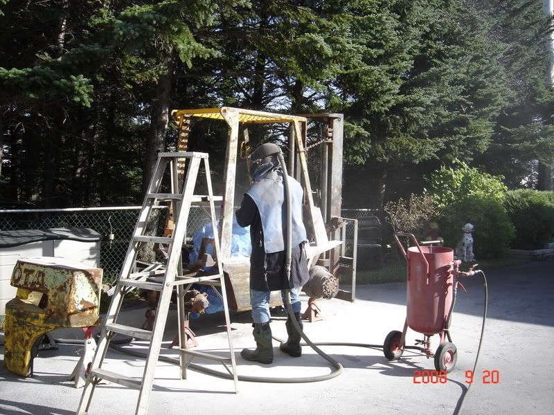

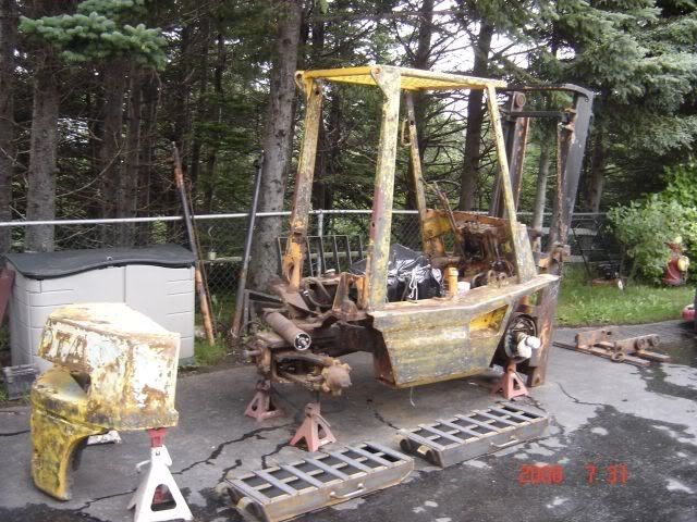

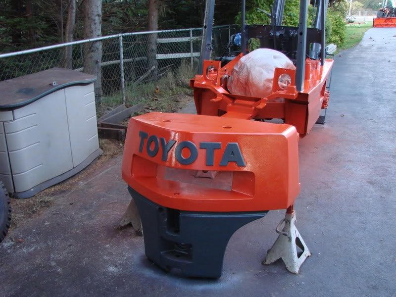

Cool thread. I'm enjoying it. I know you got way more advise than you need but I'll tell you that prepping is the most important part of a project such as this. Get the old paint off, get the grease and oil off, get a good quality primer and paint and take what ever time it requires to do it right but the most important part is "have fun doing it".
Here's a few photos of my ol forklift that I did. Good luck and enjoy.
