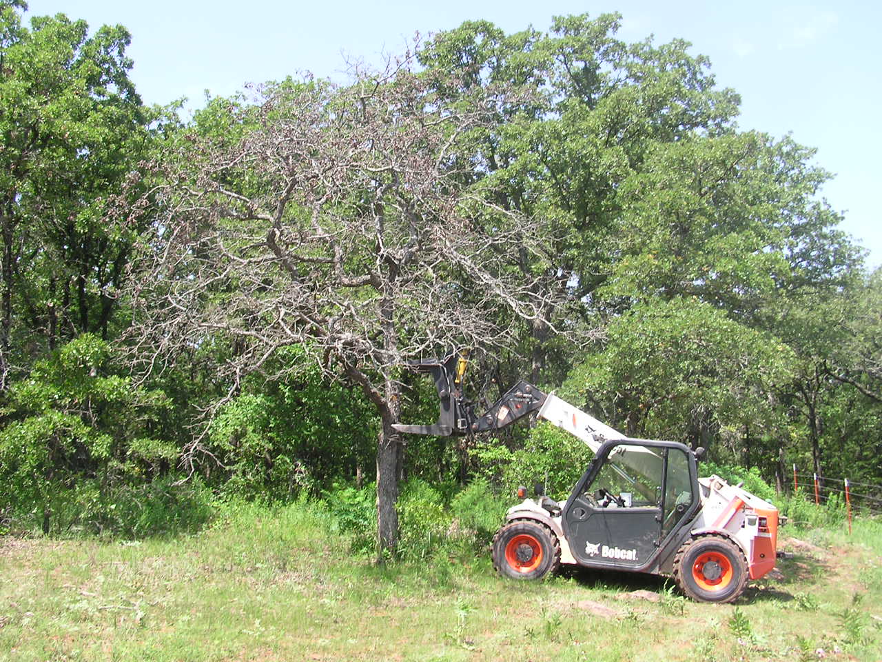

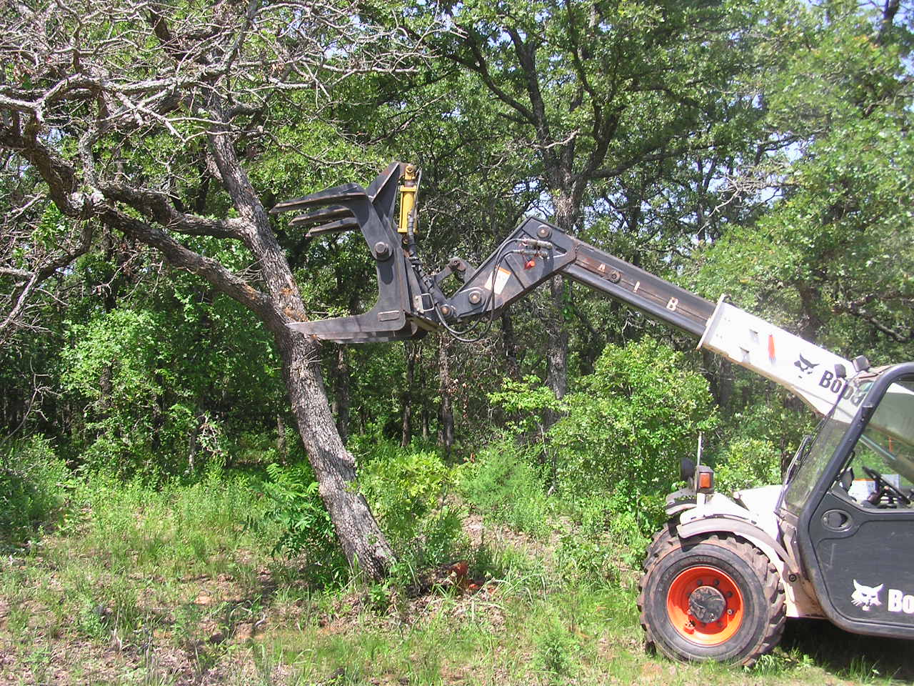

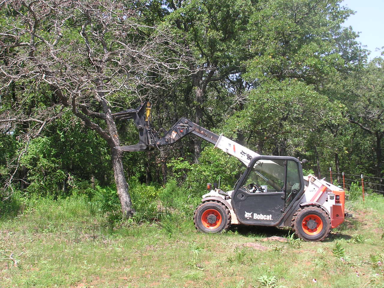

Good way to get killed. I was hoping to see something entirely different. Many people have been badly injured and killed doing just this. Push on the tree top breaks out falls on operator. NOT SMART!!!!!!!

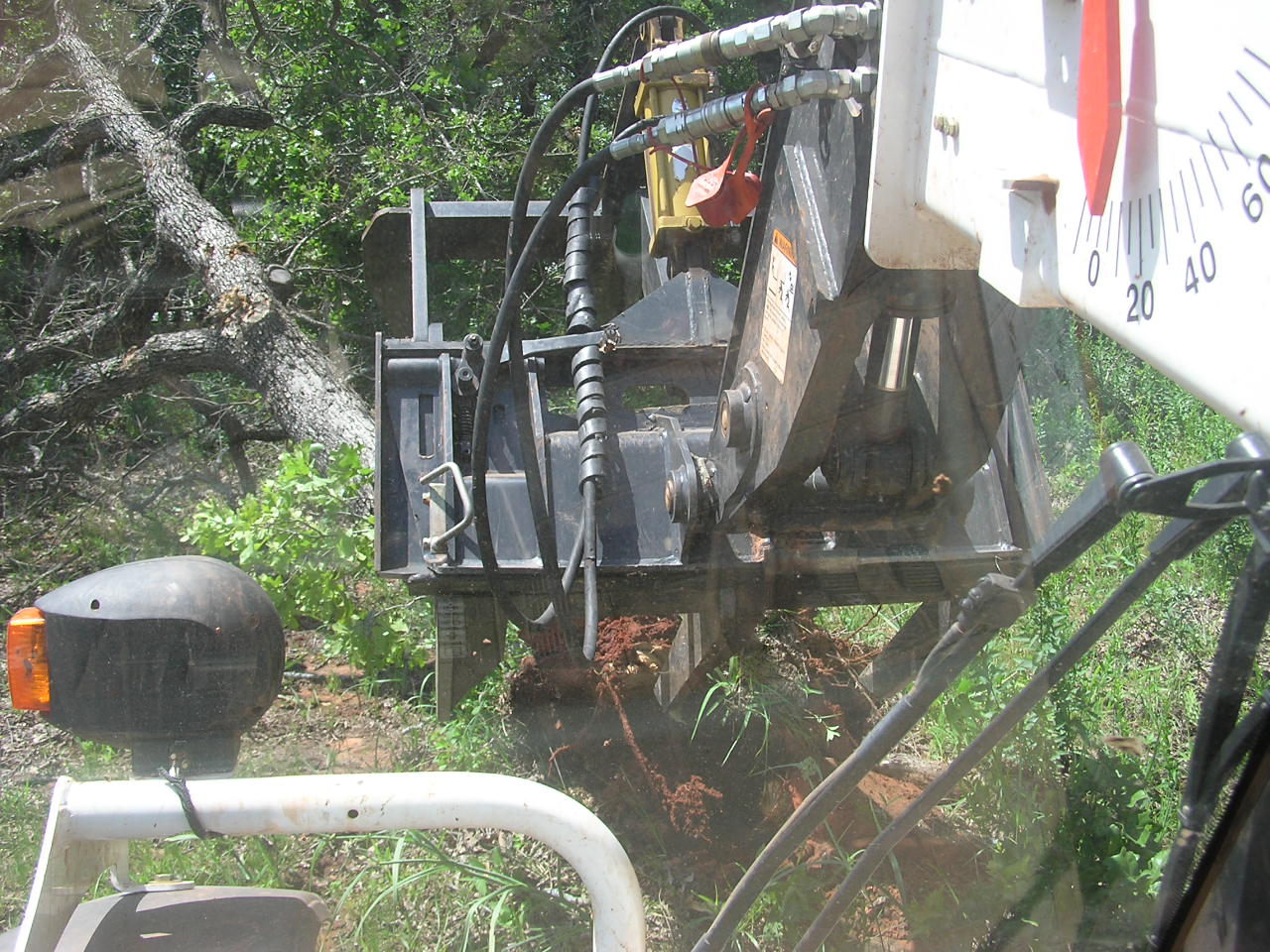

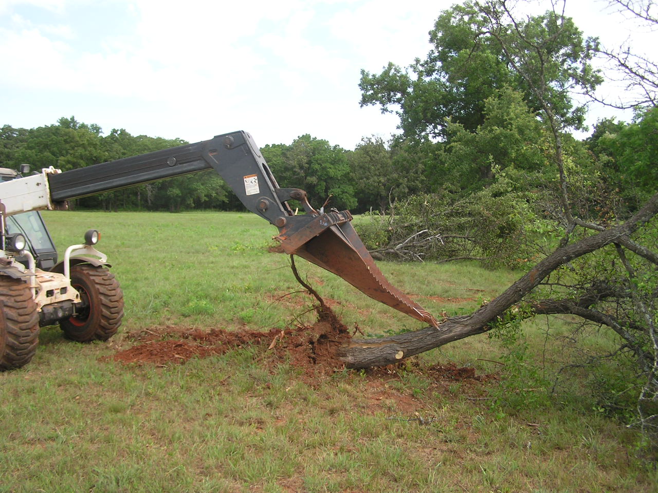

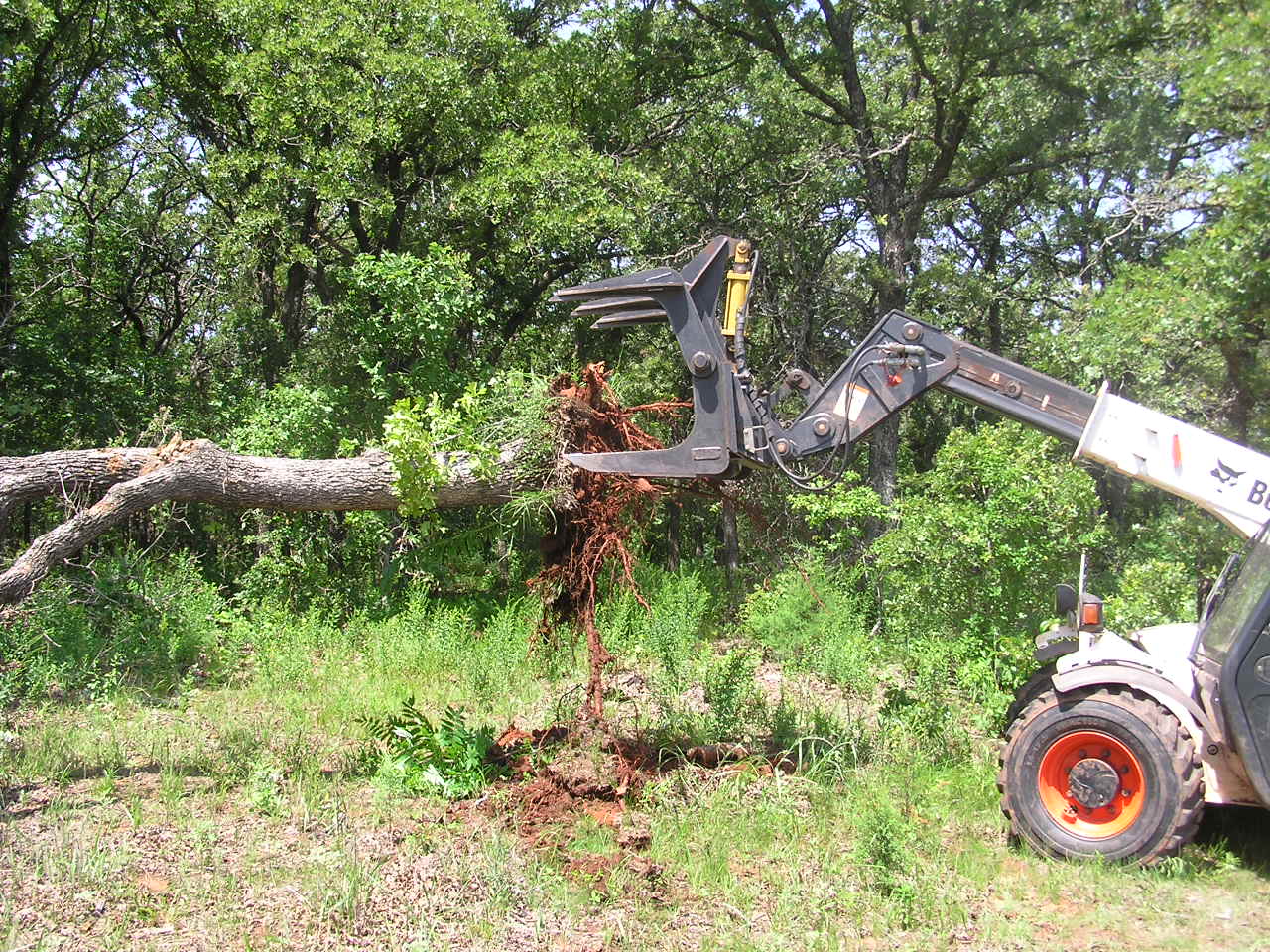

True for a tractor, but not true for my Compact Telehandler.
Couldn't get a side view picture of the 40' tree, so here is one with the shorter grapple pushing over a wider top tree. Notice that if the top broke, it would not hit the FOPS cab.

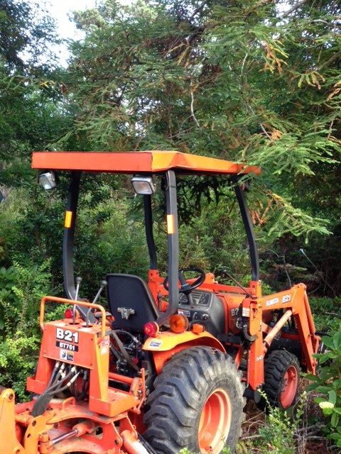

Top 30 feet of a dead pine broke off exactly as you say and clobbered my B21. Got off easy with bent FOPS. I left it bent as a daily reminder to be more careful and less dumb.

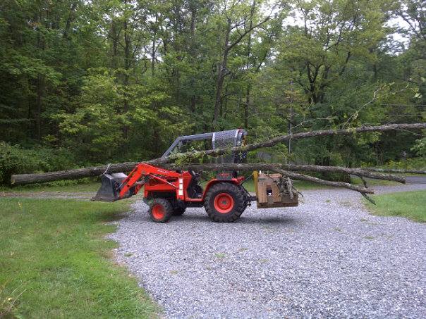

Messing with trees with a tractor can indeed be very dangerous. On the other hand, things that seem very dangerous to some, can be done with a high degree of safety. With that little 19hp tractor, I got in the habit of guiding the fall of small trees directly onto the tractor so that I wouldn't have to pick up the wood. Wood gathering doesn't get much more efficient than that. Never had an injury or a close call. Never did any damage to the machine.
So I agree... messing with trees on a tractor is dangerous. And if you have any difficulty assessing the situation, just walk away. There have been many times that I have walked away.
What the..? How the..? ...but why? Why did you do this? Why not just drag the tree? Hey if it works for you, okay, but seems like things could only go bad. :confused3:
This is how I react when I see someone smoking! :laughing:

Nicely done. That sure is the perfect machine for a lot of things around the land. How many HP is it? Do you use the wheels to push them over or by extending the boom?
