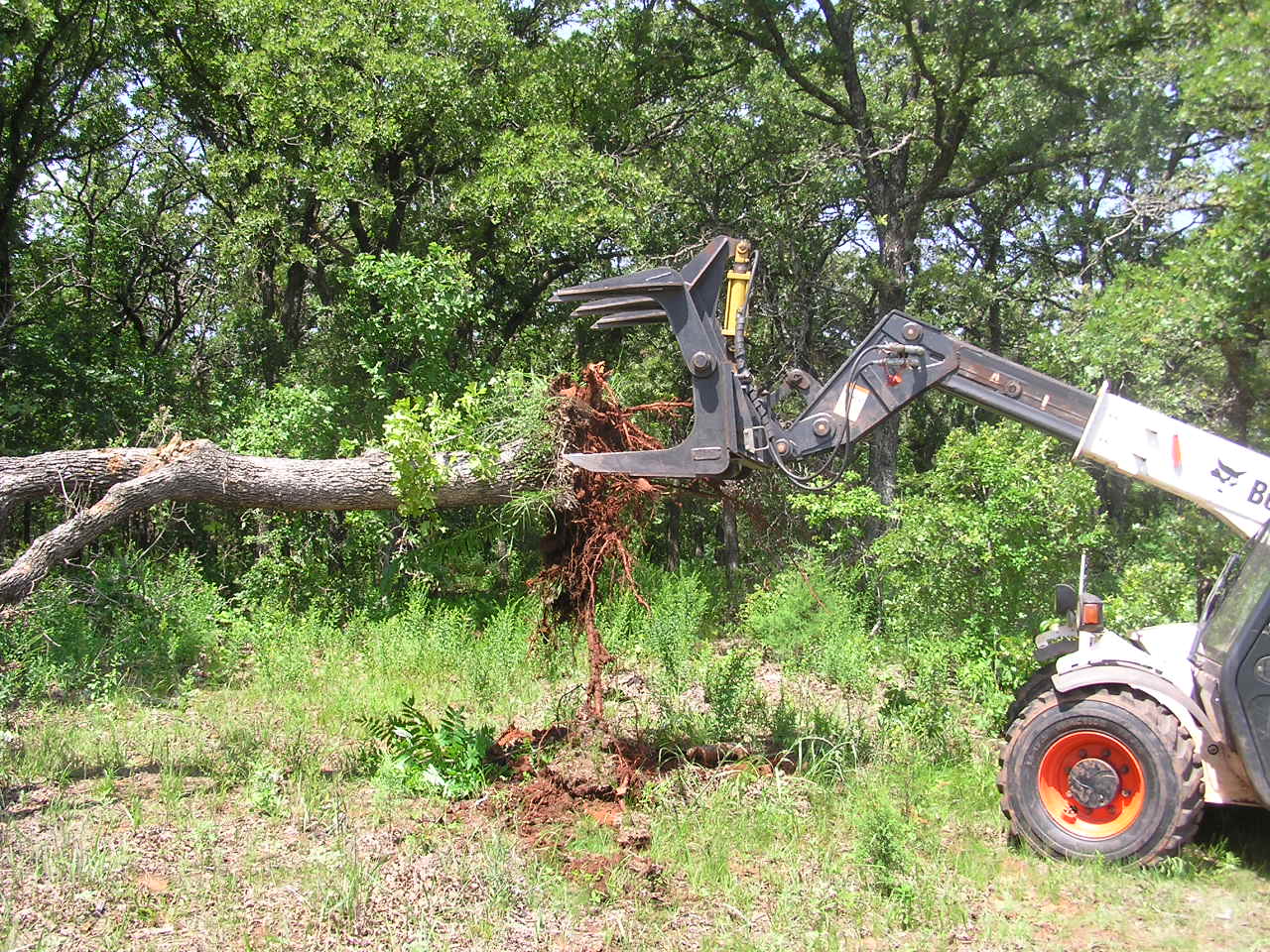

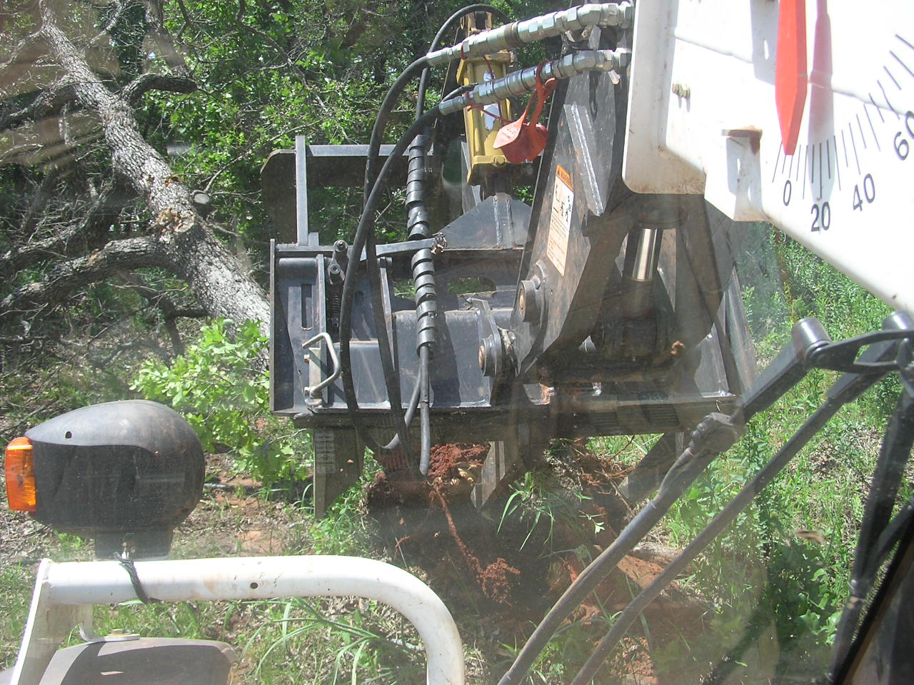

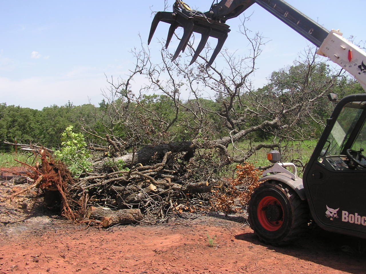

Thanks. It has a 75 HP 4 cylinder Kubota diesel.
Just extend the boom. After the the first push I got out to take the picture, from then on, with it idling, I stood outside, reached in and pushed extend on the joystick.
Pushing it over breaks the roots on one side, so I pulled it up and took it to the burn pile.
Notice it was balanced, so I didn't clamp it with the single lid. :D

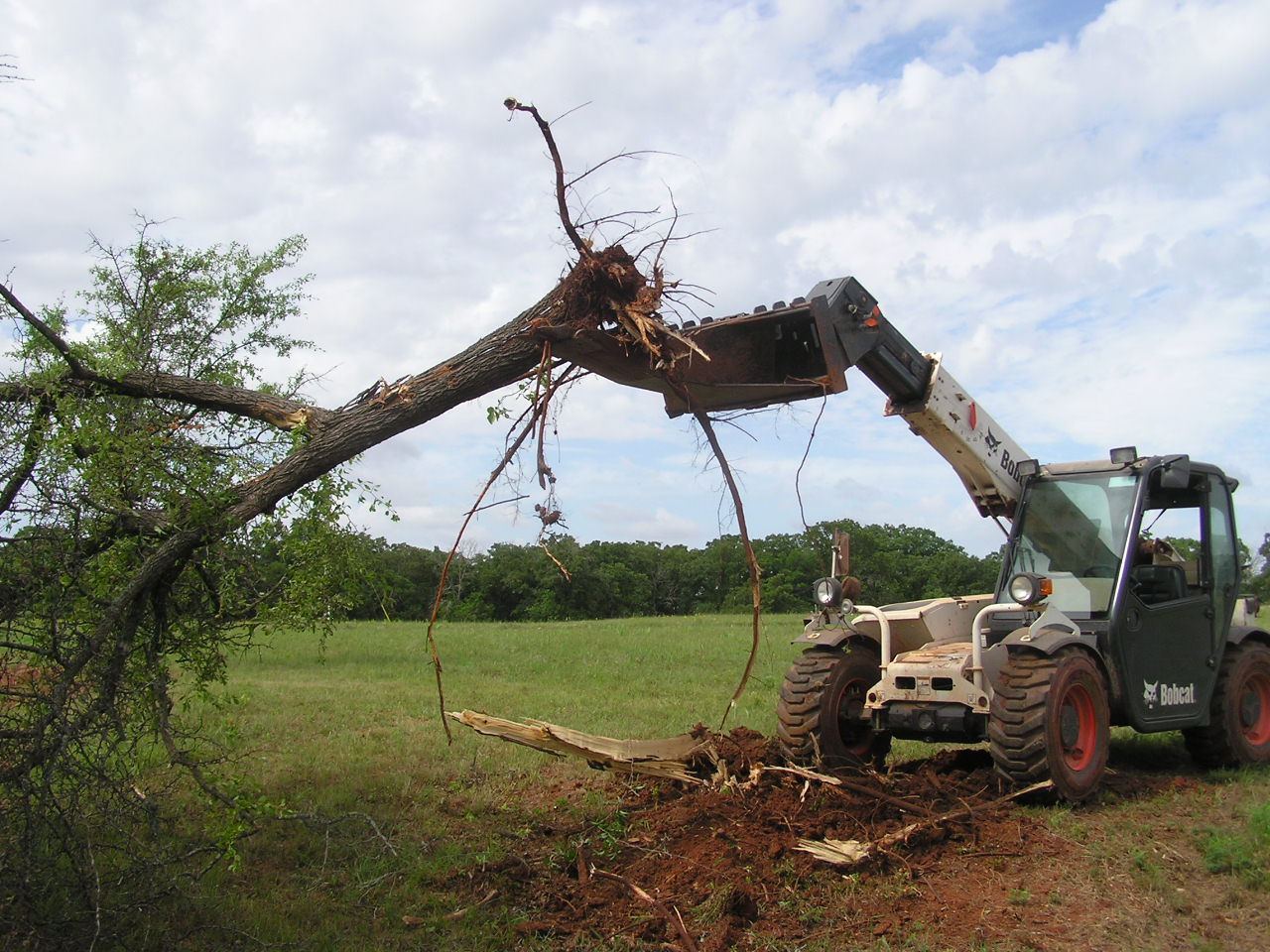

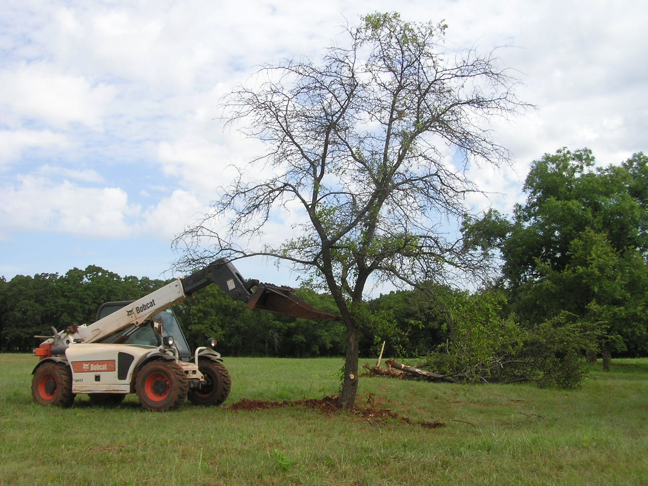

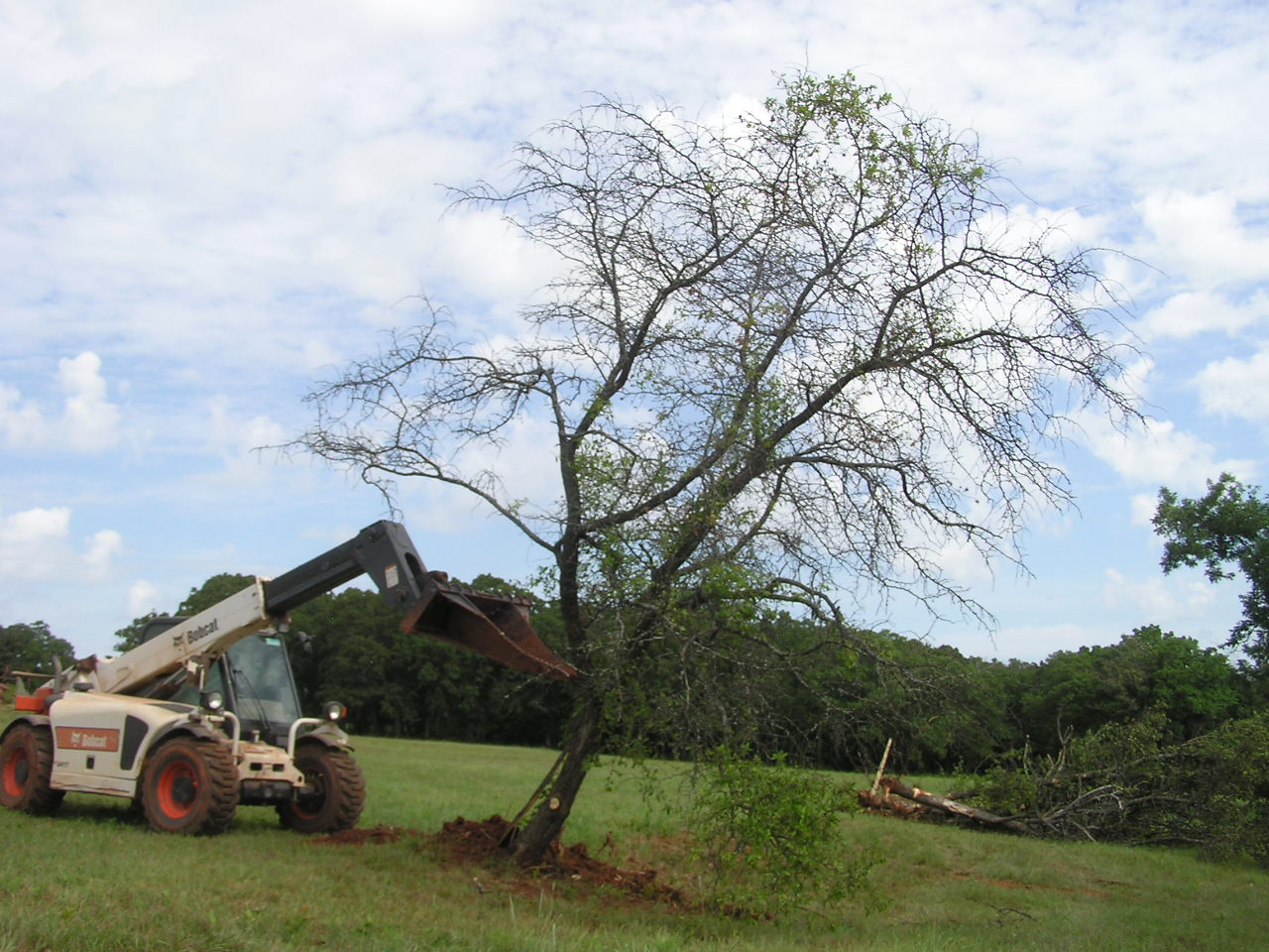

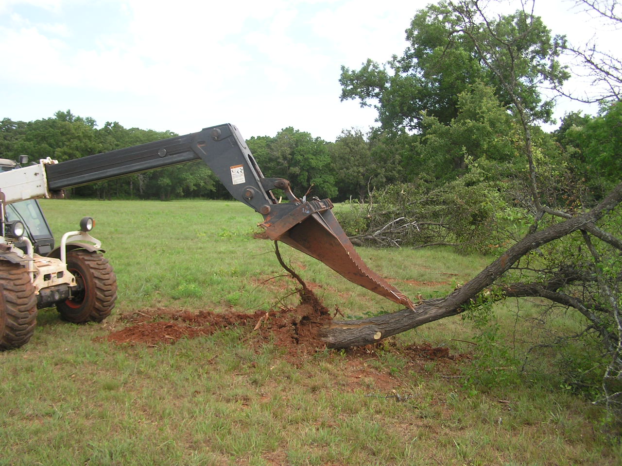

Due to all of the concerns about tree tops breaking off when being pushed over, I decided to update this thread.
I think the reason it doesn't happen with my machine is because there is no sudden movement from the impact of hitting it with the loader bucket or grapple on a tractor, like some YouTube videos I've seen.
I just put whatever attachment that I am using, against the trunk and slowly extend the boom.
Here is a live tree that needed to come out. Used the stump bucket on it:
