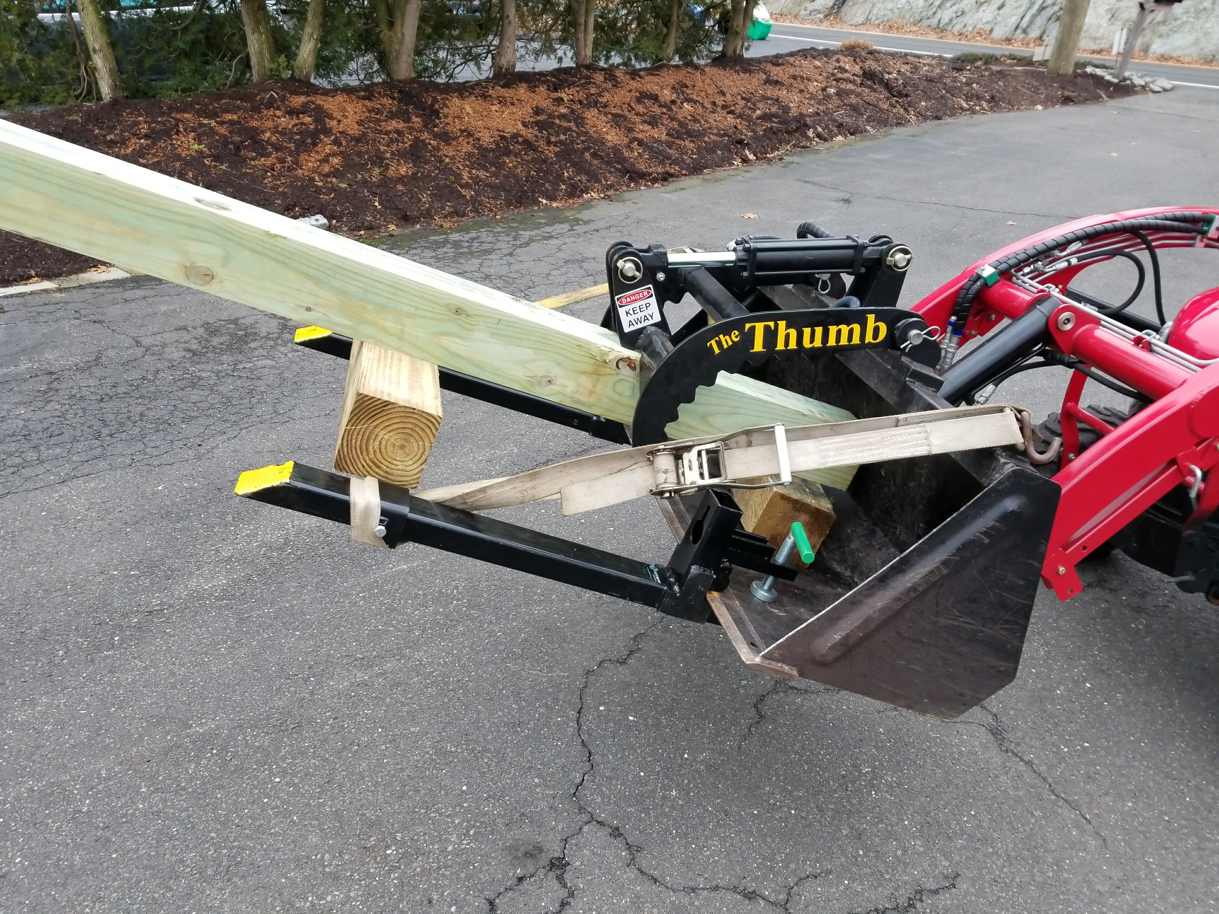

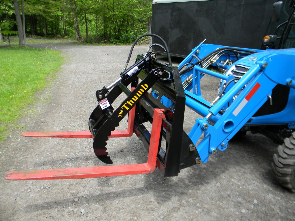

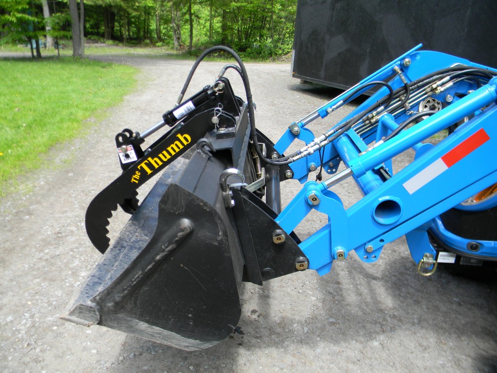

I have the thumb. I bought it with two base plates. mounted one on my forks and one on the bucket so I could switch the thumb between them. (05 of my thumb use has been on the forks. Somewhere in my posts here is pics of my install. At least two other members also bought and are happy with the thumb.

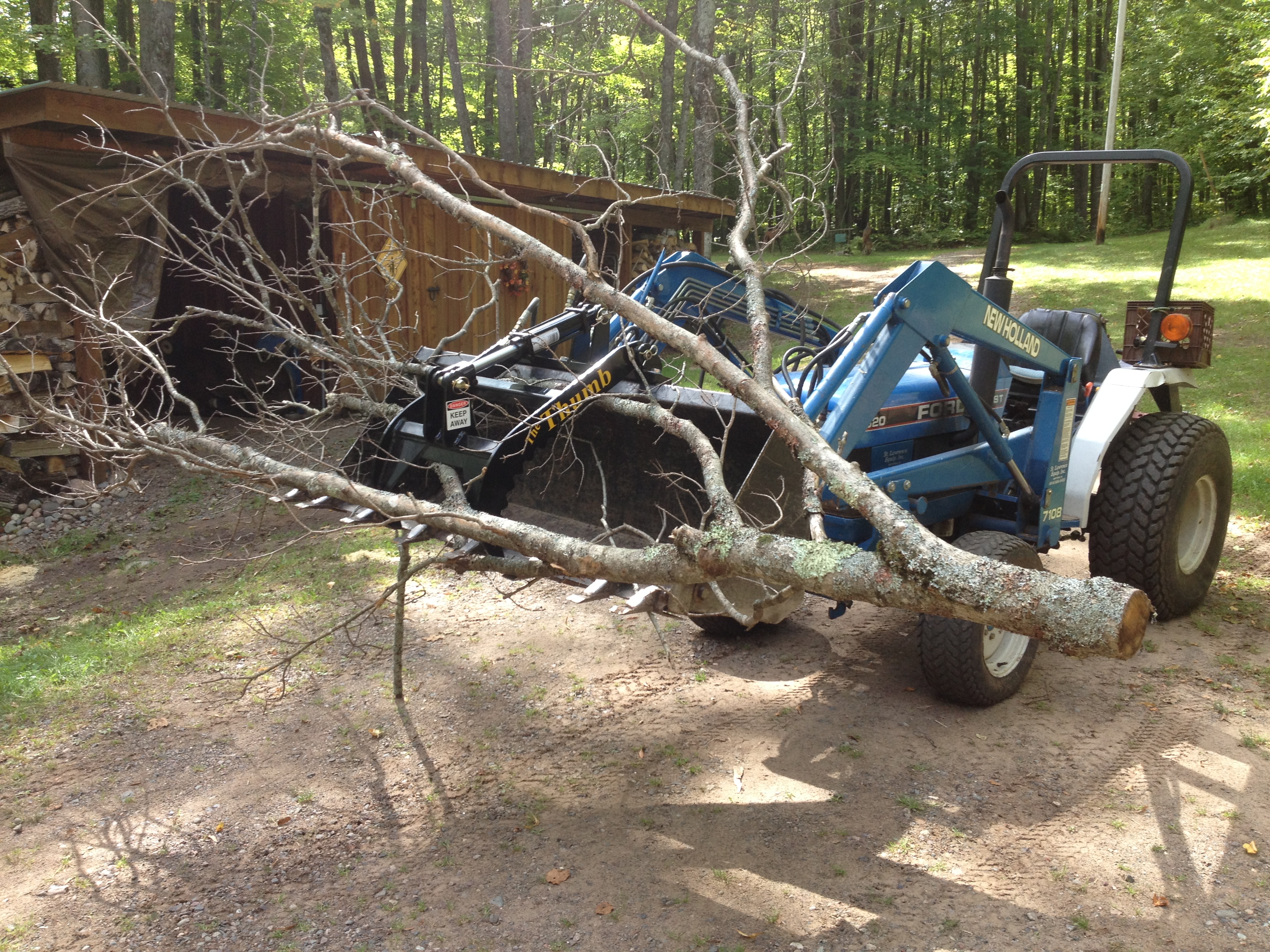

I have one on my emax its great. Built well. I will get some pics.

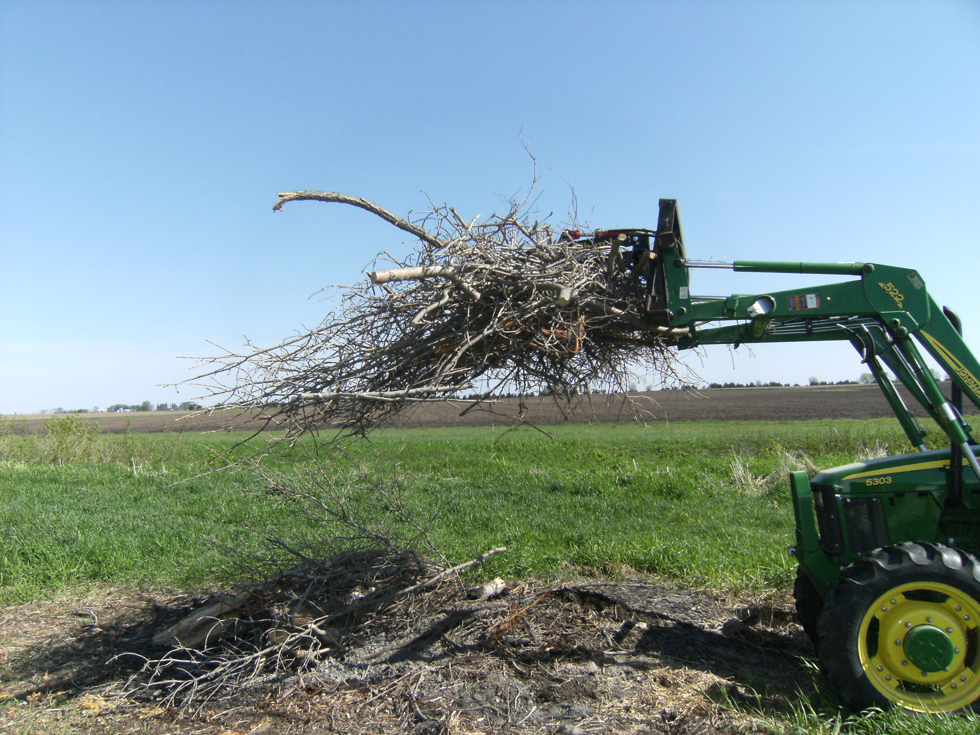

I have had mine + a tooth-bar for quite a while;works great.Easy removal(bolted) if needed.Cleared a lot of rock and brush with mine.

Thanks George , Chief and NY for the pics and reviews.
George, how did you choose the size thumb to get with your forks. My forks are similar in size and shape to yours.
/ The Thumb #7
I ordered the 36" thumb. Pretty much a guess with a tape measure and where I was going to mount the base plate. Glad I didn't get the smaller ones.

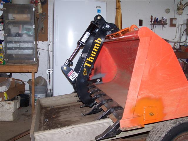

another Thumb fan.. as you see in some of the pics I also had to stiffen up the top of my bucket.. initially tried to just bolt it to the top lip and quickly found it was not near stiff enough..IMG_0755.JPG

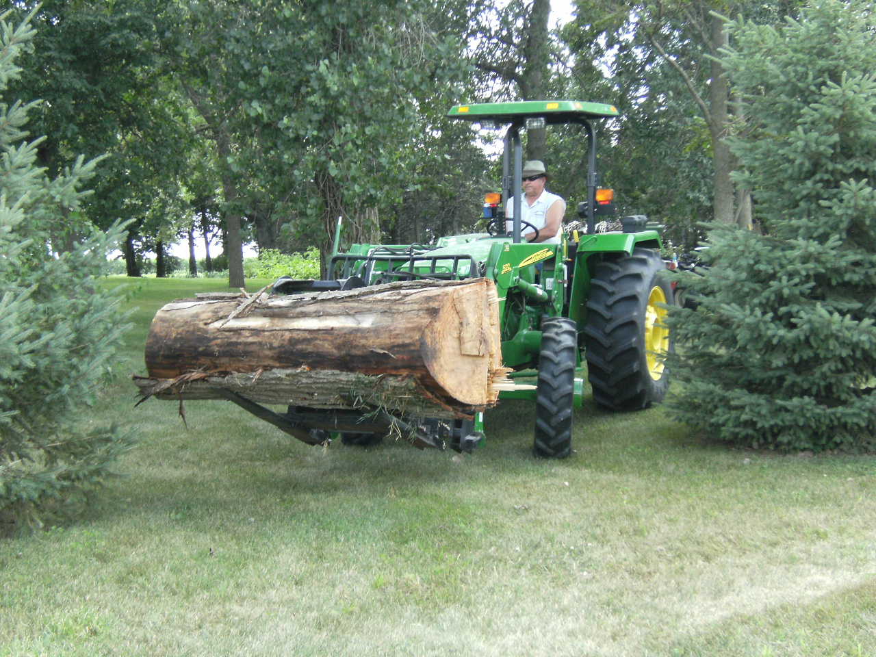

I stopped by their shop and picked one up a few years ago. It's the best bang for your buck for such things. I use mine with forks constantly. I can grab a 16' log, lift it to working height, and cut firewood rounds off very quickly. It's been great. The cylinder is well matched for size and power.

I have one and love it. I had a piece of 3/8 flat bar welded to the top edge of the bucket as reinforcement before bolting it on.
