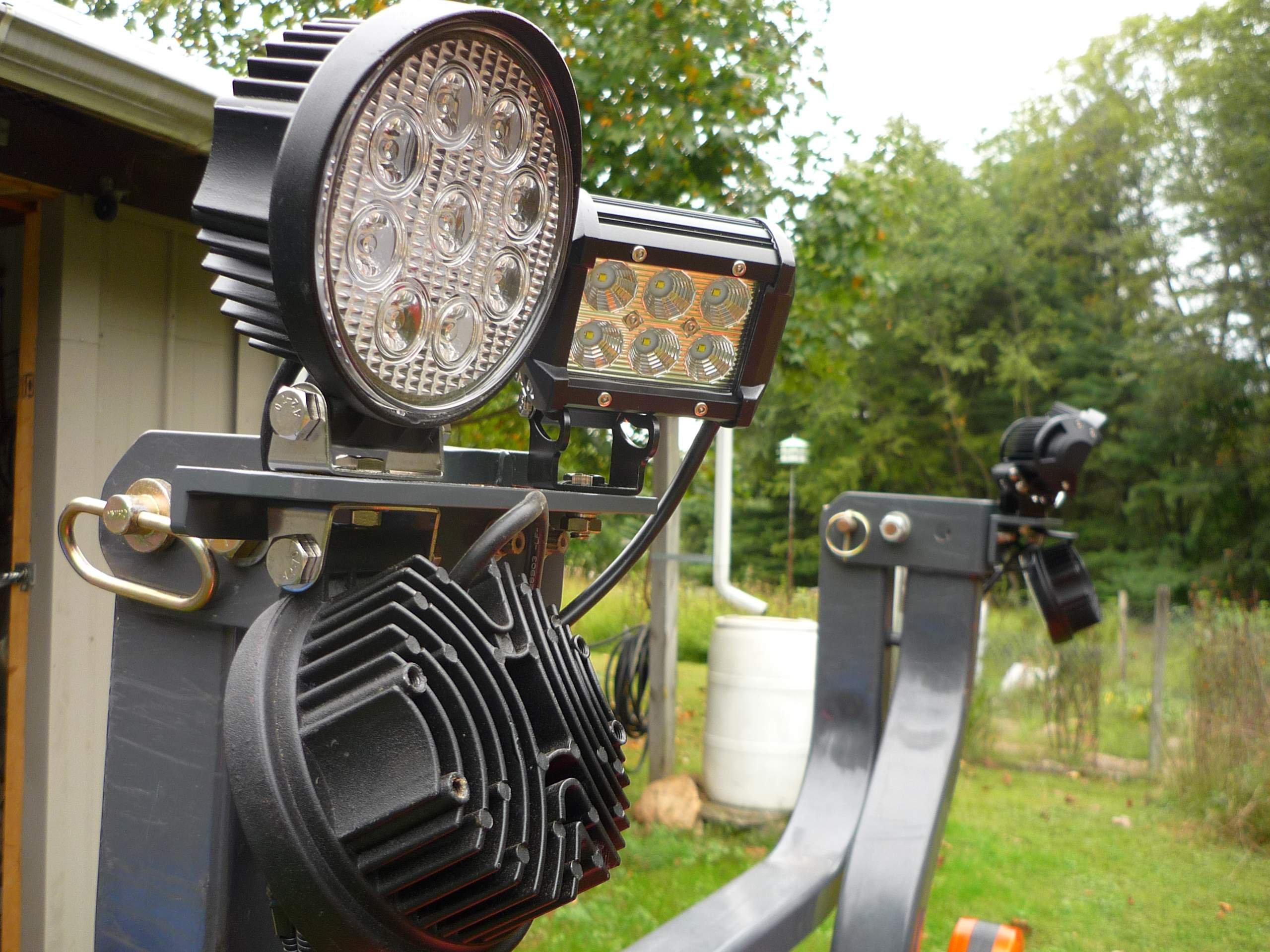

For LED lights, just pick a size, like 27W, spot or flood, and start looking at Amazon and eBay. I have purchased about 16 or so, mostly 27W floods, and they all seem about the same quality and so far, zero issues. Since you likely are moving fairly slowly, the 27W floods seem to work just fine. I did add some 18W side lights, so I could see the brush along side of me. My apologies in advance to guys who have seen this photo too many times over the years, but for newbies, maybe it'll give them some ideas?
I ordered the 4" 18 watt spots which looks identical to your side lights. I only need them for the rear as the front lights are pretty exceptional. I should have them here first of the week and I'll post photos after the install.

If you have good front lighting, they must have changed things. My headlights are fine, until the loader comes into the picture. The back side of the loader is well-lite, but that's about it. I like lots of light, since I mostly have to deal with snow removal on a tree/shrub lined lane, and at night, in a storm, I need all the help I can get to avoid getting a snow covered branch on the nose.

Well I got the work lights installed. Can't wait till dark to try them out and adjust. I didn't have long enough zip-ties to finish up the wiring but I'll pick some up over the weekend.Took several hours to install but alot of time was spent soldering the wiring. Not to bad for less than $20 for everything. View attachment 477112View attachment 477113
