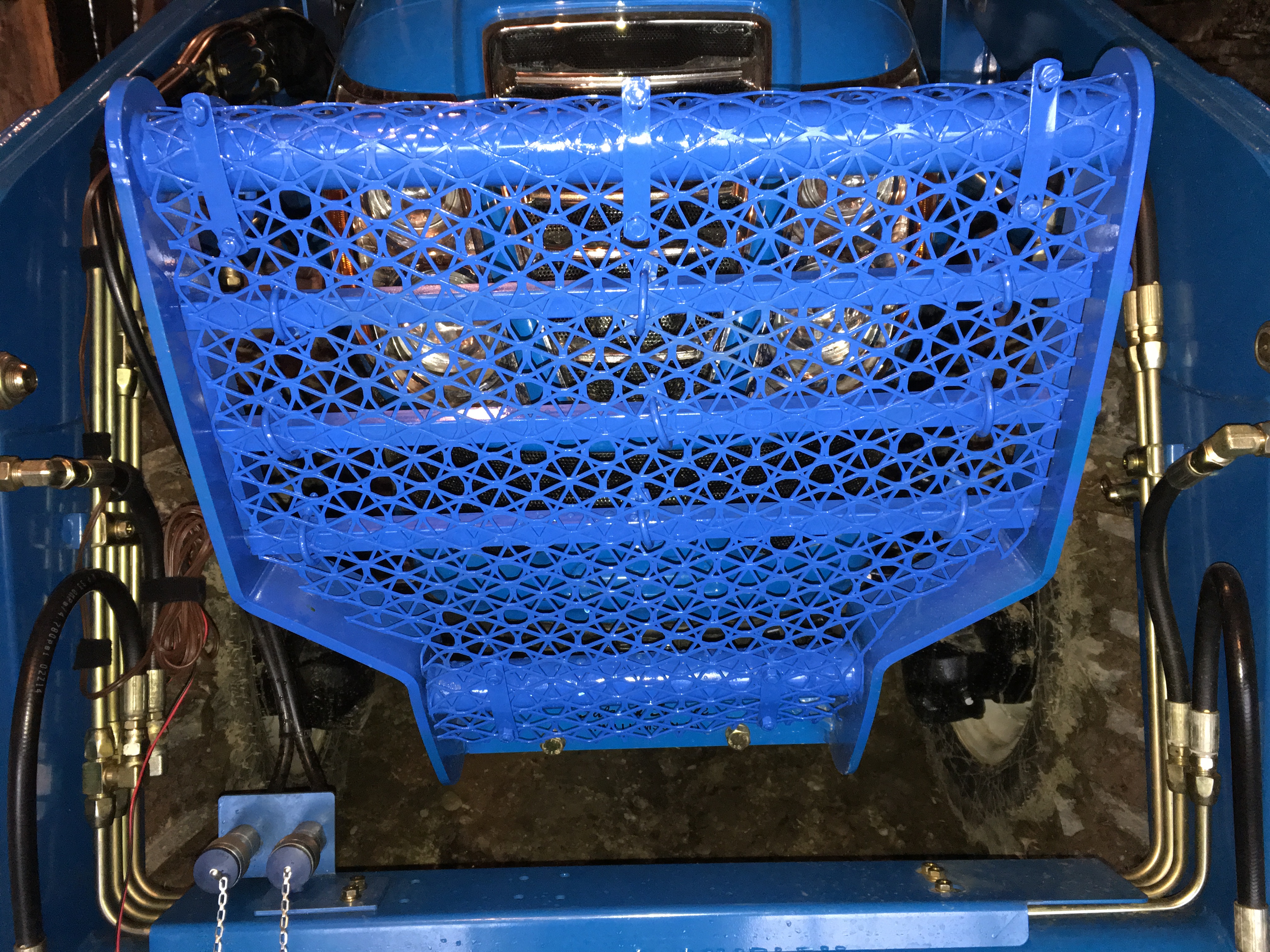

I'm sure that would work if backed up.
That's the key ...
I can tell ya - from personal experience - that 3/4" no. 9 raised expanded metal will bend fairly easily in this application unless properly supported/backstopped.
Figure on supporting it every 6" or so ...
The grating I favor would almost certainly withstand more abuse but would also block more view and is much more costly if purchased.
4 lb expanded metal grating is over double the weight per sq. ft. of the size I mentioned above, with a strand thickness that is not quite double.
Probably a good choice ... although ya could always go heavier ... :D

Rswyan,
I had similar concerns (but not personal experience) that expanded metal may not be very strong against a stick coming straight at it with a lot of force. I doubled it up with one sheet 90 degrees rotated from the other to make the holes smaller and put supports every 4 inches or so (Except at the bottom where it was harder to add supports there. I don't have it on the back of my grapple yet (it gets delivered next week) but I did the grill guard on the front of my tractor. I don't have welding experience/equipment, so i did it all with bolts and clamps. The expanded metal is supported by square box steel which has 1/2" threaded rod through the center and through existing holes/slots in the guard on each side with washers/nuts on each side.
Hopefully this works.... It hasn't been tested yet so I don't know how it will fare. It has way less bend/bounce to the expanded metal than it did with only one layer and no additional supports. Hopefully its enough to protect against branches poking through.
Your post gave me some reassurance that buying the extra parts and doing the extra work was worth it over one sheet of expanded metal without the supports.

That looks great. Well supported by the grill guard. Ain't nothin gonna get through that except grass fuzz.

Yeah, that should help keep it from getting bent up.
The deformations I was referring to on the expanded metal on the grapple were probably caused by fairly large branches and limbs (3" to 4" in diameter) ... either from me driving into a large pile or just from the force generated by closing the jaw.
On the brush guard on our Kubota I used flattened expanded metal with a much thinner strand thickness ... but one which had a much smaller opening than what I used on the grapple. Since the openings were smaller, the overall amount of metal was fairly high, which made it pretty stiff. Still, it managed to get dented in at some point, in at least one spot ... didn't break or get punched through tho' ...
