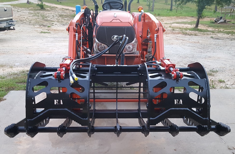

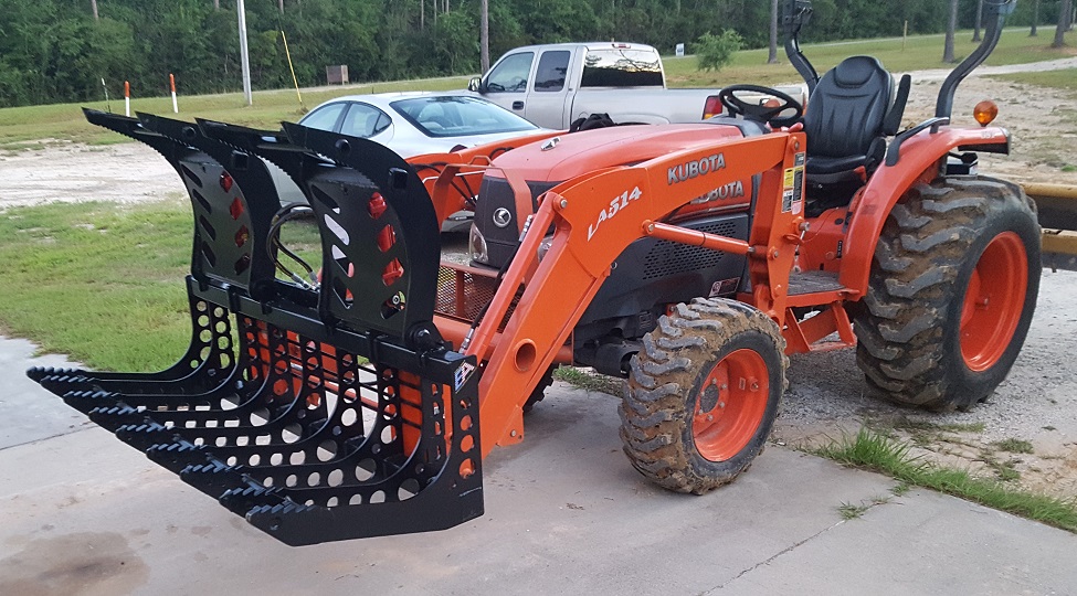

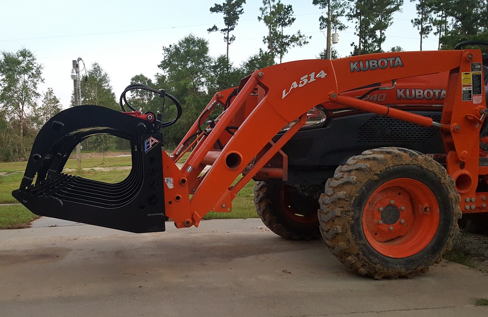

I think EA is going to have to look at something other than HP when deciding which implement to recommend. I understand the fear, but the reality is that half a ton hanging off the end of my loader BEFORE I grab anything is just too much. If I didn't already have 1800lbs of juice in my tires, I don't think I could use it at all. My tractor is just too light, regardless of the HP. I should have purchased the heavy duty Wicked of the same size and saved almost half the initial weight. Ted/Travis... I really think you should look into this issue.

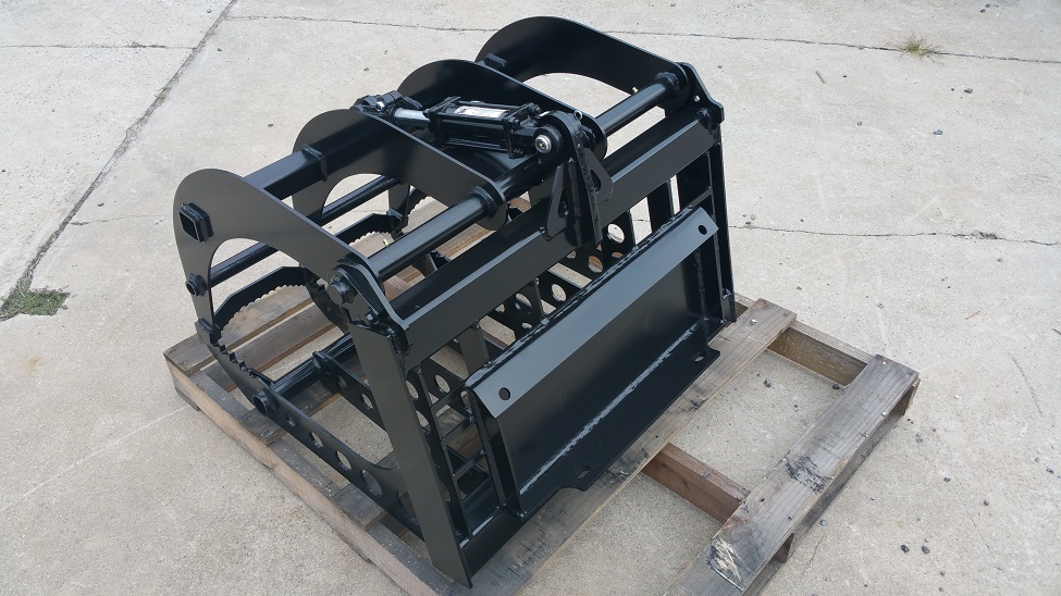

Island, you'd love this one. Brand new and fresh, BUT, it has a Universal Mini Skid Steer mount on it!
Travis
