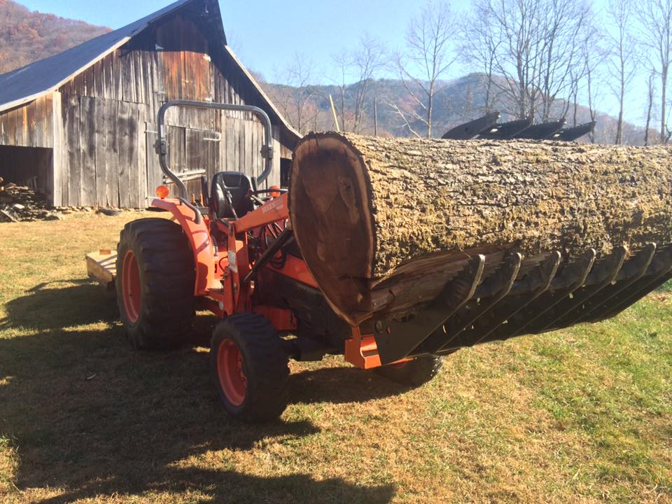

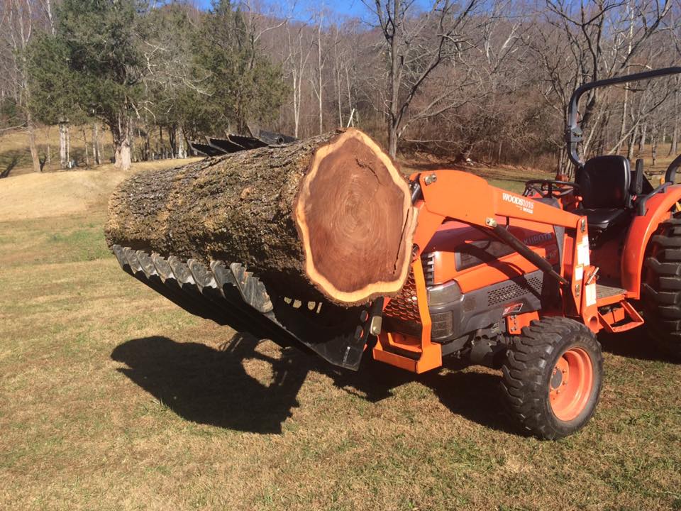

The analogy of hand and grapple assumes you use your hand palm up to scoop a load and simply hold the load in place with your thumb. That is how the most common type of grapple works. Gravity does the work for L shape or "open bottom" grapples like those sold by EA. The load sits on the bottom tines so there really isn't a need to have more than a single thumb to secure the load.
Rotate your hand so palm is facing down when you grasp an object is like using a clamshell grapple. A clamshell doesn't take advantage of gravity but rather fights it as the load is held only by clamping pressure. Open a clamshell grapple and the load falls out immediately. Open an L shape grapple and the load just sits on the bottom tines....unless you move or have a load that's center of gravity is outside the grapple.
Throwing a split fingered fastball is an example use of the remarkably flexible human hand that allows us to use the same implement to swing an axe or hold a baby or pick up a pin without needing SSQA.
Bottom line is that grapples and humans do well with one thumb.
   / The WICKED Root & Debris GRAPPLE!!!!!!! #1,493

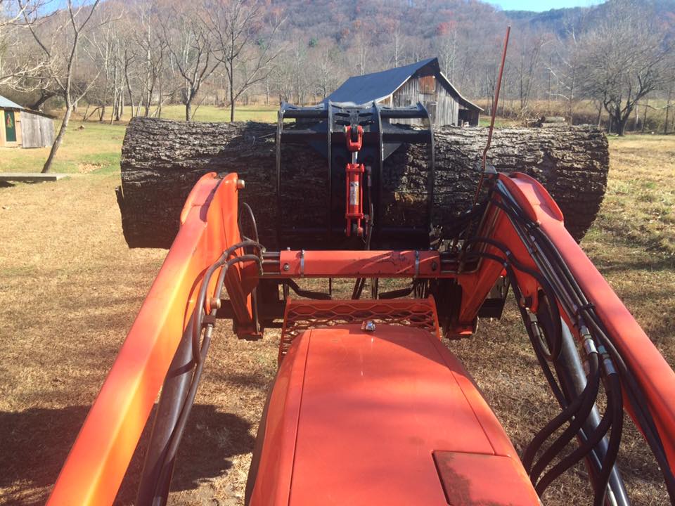

That's how I see it as well, I can't haul much in my Rake grapple. My two lid L grapple takes more time to close both lids than my one lid L grapple takes to close the one lid. So not only can the one lid lift and haul more, it is faster,
   / The WICKED Root & Debris GRAPPLE!!!!!!! #1,494
Let me ask about this time to close the lid or lids. With my single lid on my Kioti I can snap it shut in less than 1/2 a second from full open to fully closed if I pull the rear remote lever fully and rapidly. Now my flow rate is over 9 gpm and I did run 1/2 inch hoses to the front, but is this what you guys are experiencing? I can feather the valve and make it close very slowly and gently if I want, but If I shove the valve all the way open it will close the single lid with a bang! Of course If I had two lids, it would likely take twice as long, but it would seem to still be pretty fast. I am not bragging or complaining here, I would just like to know how others are working, since it was brought up about closing times.
   / The WICKED Root & Debris GRAPPLE!!!!!!! #1,495
I don't know how large your cylinder is but if it takes a 1/2 gallon of fluid, wouldn't that take a 60 GPM pump to close it from full open to full closed in 1/2 second? 1/2 a second is awful fast. Maybe it takes a quart, but that would still take a 30 GPM pump.
Mine takes a number of seconds to close both, depending on the tractor.
   / The WICKED Root & Debris GRAPPLE!!!!!!! #1,496
My grapple lid takes roughly a couple of seconds to go from full open to closed. I wouldn't want it any faster.
