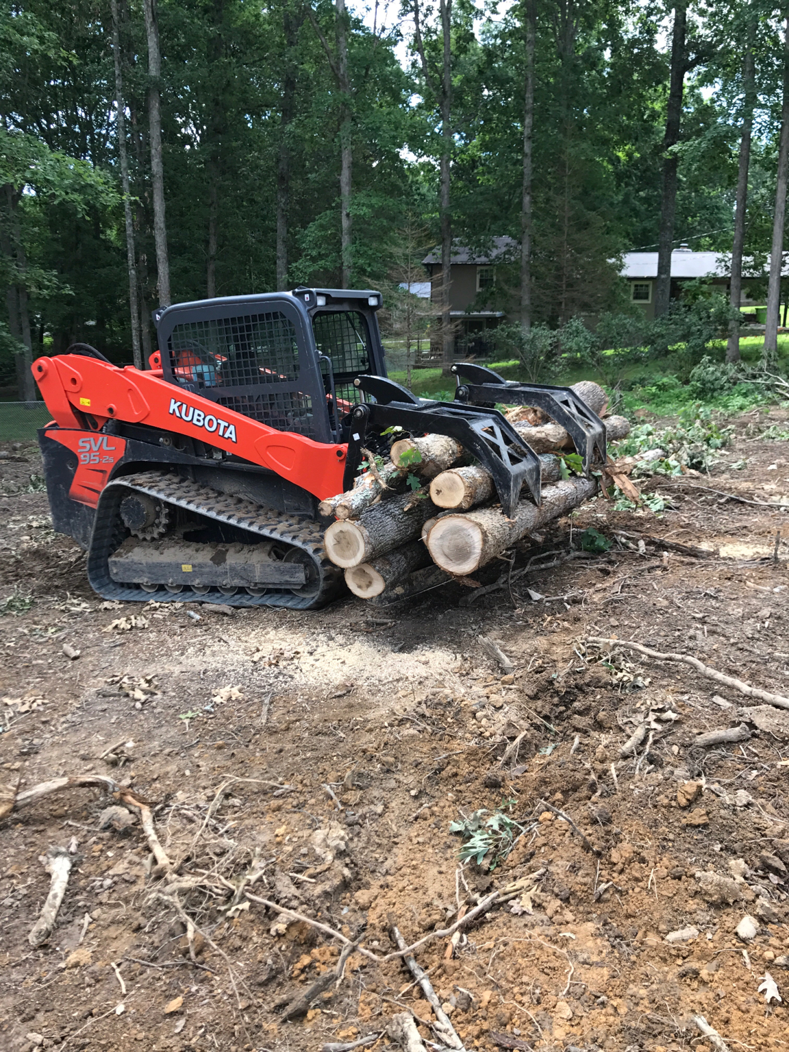

Big grapples are awesome. Just not on small machines. On this machine I think duel lids are a definite advantage. Compact tractors, not so much. IMG_0004.JPG

Big grapples are awesome. Just not on small machines. On this machine I think duel lids are a definite advantage. Compact tractors, not so much. View attachment 512798
Absolutely. That is the machine the big dual lid grapples were designed for. With few exceptions, like the EA 50" single, grapples used on CUTs are simply grapples designed originally for skidsteers. Look at the size of the loader arms on that puppy. Looks like it has been on a steroid diet while CUT FEL arms look like 99lb weaklings in comparison.
