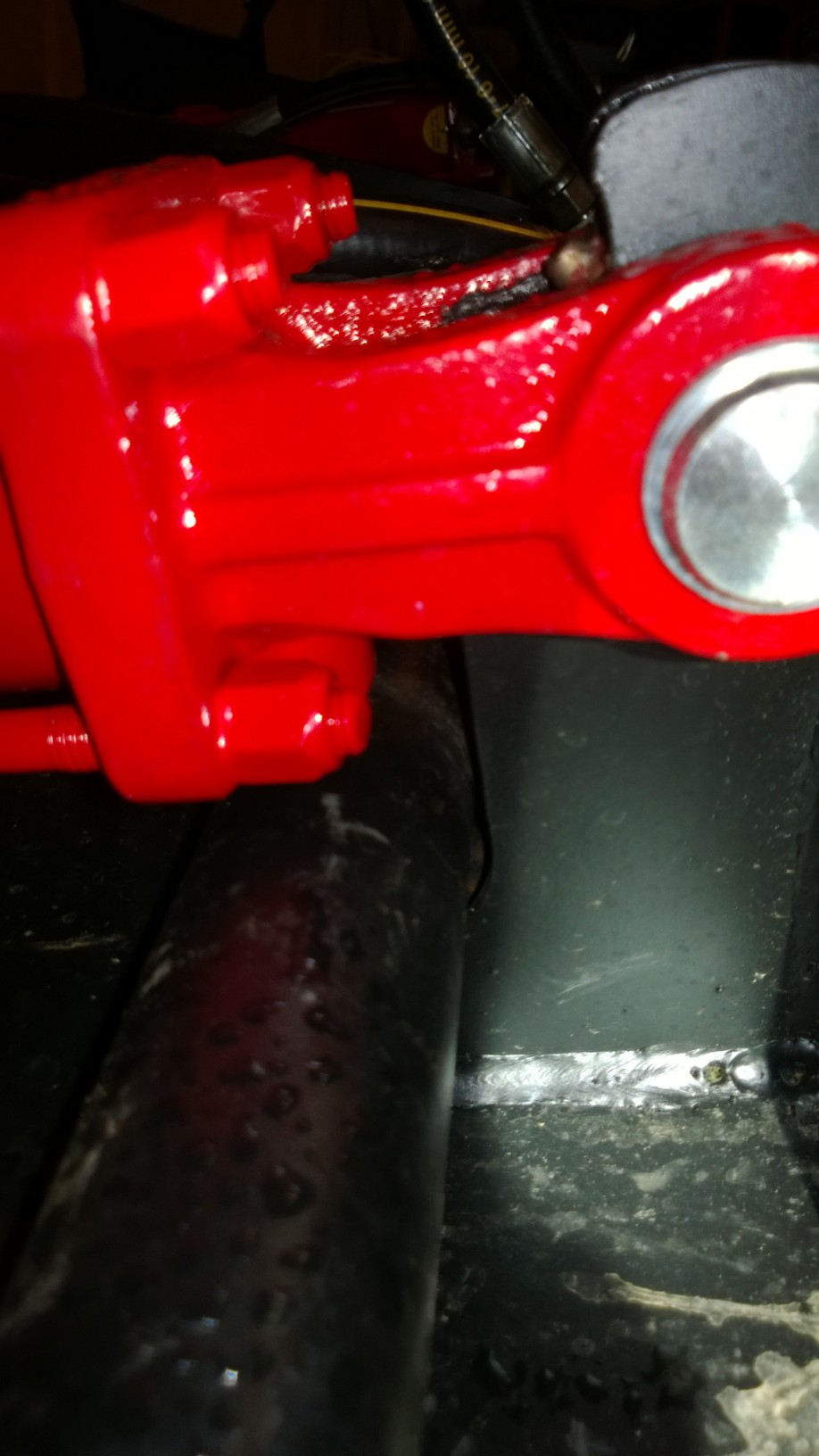

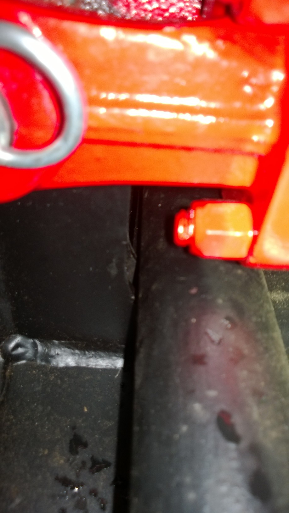

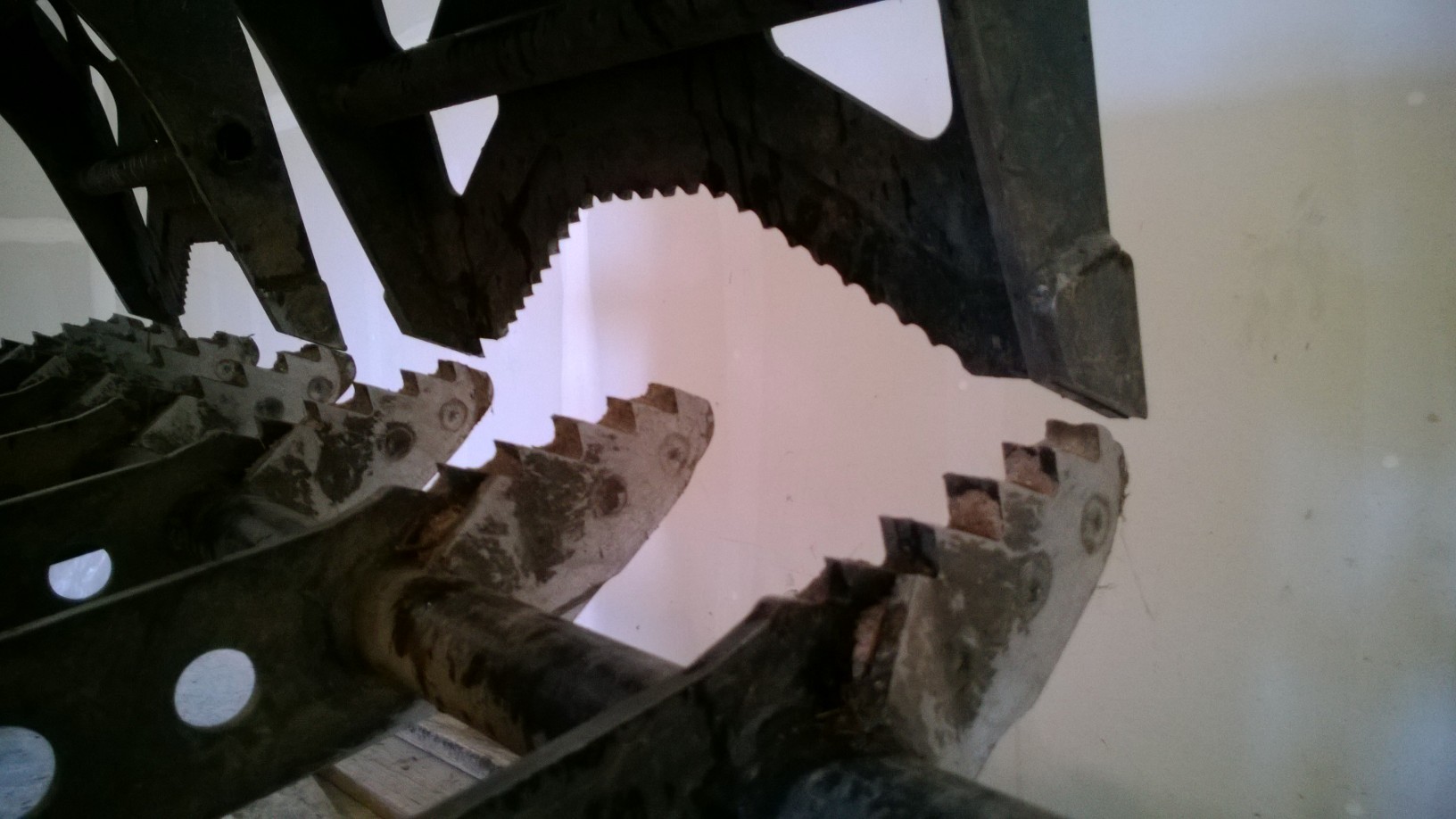

I am having a problem with my new grapple, one clamp does not close all the way. Seems like it did last week, although I could not swear to it.
I called EA this morning and talked to Rick who must have been pretty busy as he did not want to hear what I learned in inspecting it last night. He just said send a picture and they would troubleshoot from the pic.
What I wanted to tell him was that
My guess is that both sides were closing last week (new) but I can't swear to it
Turns out there is no physical interference on lid, when I detach the cylinder from one end it closes fine.
So it's the cylinder itself that is not reaching far enough to close lid.
Would have guessed a wonky cylinder, but an initial measurement of both cylinders shows them to be extending pretty close to the same amount - so not conclusive.
To confuse the issue, upon closer inspection it looks like the upper cylinder bracket on that side was welded on further back than the "good" side. So if the cylinder is at the limit of it's extension it might explain why the lid doesn't close.
Anyone have any thoughts on cause, cylinder or bracket mis welded? I attached some crummy pics that attempt to show the different spacings between the round pin housing and the top cylinder bracket themselves.

Just looking for ideas and sharing. I'm new to the tractor game and going through my thought process and in fact based on what I figured out, bullet straightened me out immediately on adjusting the cylinder.
