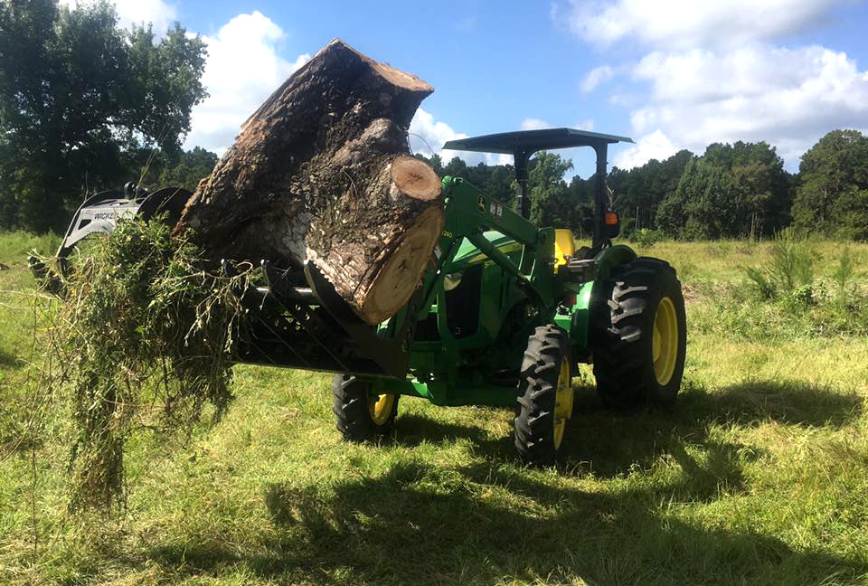

A couple guys were bragging on their Wicked Grapples in the EA Facebook Group over the weekend!
The color was GREEN, too!
Travis
First is a 73" Dual Lid for tractors up to 75hp. It is installed on a John Deere 5075e Utility Tractor, which has a lift capacity of over 2,000 pounds and a breakout force of around 5,000.
"I really like how the double lid will grab hold of any odd shaped log. This piece is over 1000 pounds and the grapple has a tight grip on it."

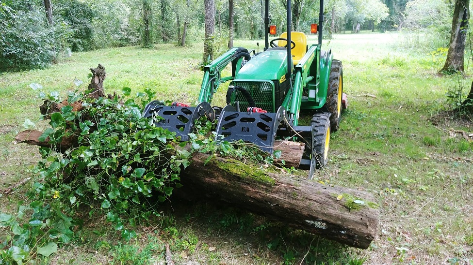

Second is a 60" Dual Lid on a John Deere 4300 compact tractor. It's loader is rated at around 1,200 at 30" in front of the pins.
"This was an odd shaped stump that was right at the lift capacity of my loader."

Why are your clients always bragging about how a dual lid made it possible to lift an odd shaped tree or stump? Is that part of the sales pitch?
I have NEVER met a stump or tree/log that I could not clamp securely with a wide jaw single.
Why does this unsubstantiated myth about dual lids persist??
Maybe you guys need to design a test to compare your 37" opening dual versus a 42" opening single...
We need scientific data not Facebook posts from novices!

I post with no favoritism and do not push my customers either way. I also speak to everyone about their application if they're open to it. If their mind is made up, I may give them other's opinions as to what is best, but refuse to argue.
I would recommend you to post all of the user pics and experiences you could find concerning a Milozonieus(ah) grapple, but that guy already posts them in here. :laughing:
