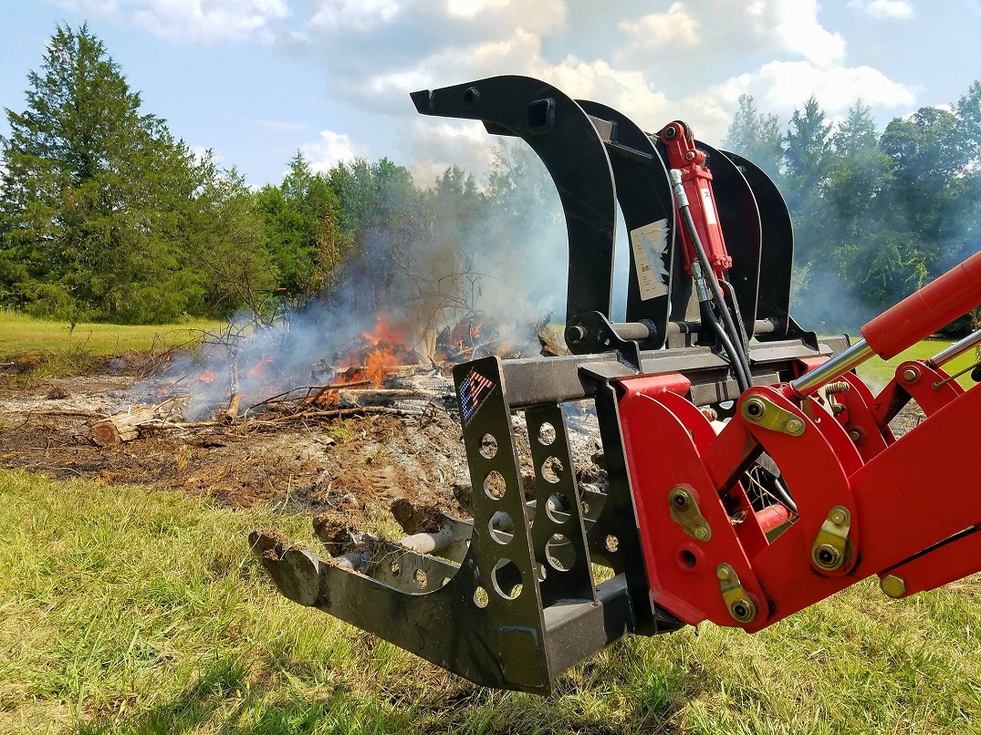

It's not a Wicked Grapple, but it's interesting in it's own special way.
Anyone care to explain what's going on here? I've noticed the design on a few brands. :anyone:

It was probably working fine until Ted tested it:rolleyes:
Seriously though, the geometry of where the cylinders are make no sense. I'm sure island will be along shortly to explain why it's a superior grapple because its lighter:laughing:

While it might not be the best design I've seen several grapples that had the cylinders like that and worked fine. The lids are junk is the source of the problem.

No need. I already have. IMG_9315.JPGIMG_9317.JPG I also bent both cylinder mounts backwards and the lids were bent and the bottom edge was bent.

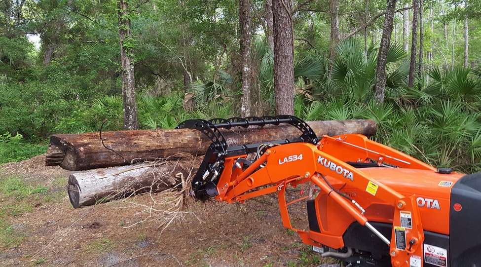

Maybe I am blind. Does that grapple have invisible cylinders? Or are they completely behind the backplate and on the outside upper tine?
Yep, the upper lid is wi-fi, or Bluetooth, or something?
The cylinders are back there. It was difficult to get everything crammed into the back of this 55 because the cylinders are on the outside of the QA mount. TIGHT, especially with the John Deere QA, which is wider than SSQA.
We got it done and kept it, horizontally, as compact as possible.
The lower cylinder mounts use the lower tube for strength, staying tucked in, which also creates a stronger rod pushing angle for max clamping force! The strong clamp is something Ted was very impressed by right off the bat after plucking some limbs right off a tree!
Land Pride extends the cylinders back further with tabs, which is weaker and also leaves no room for a JD mount as shown above on ours.

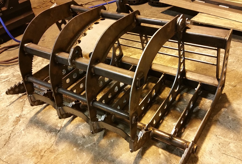

It's hard for me to post without adding pics, so here's a naked Wicked 50! :laughing:
