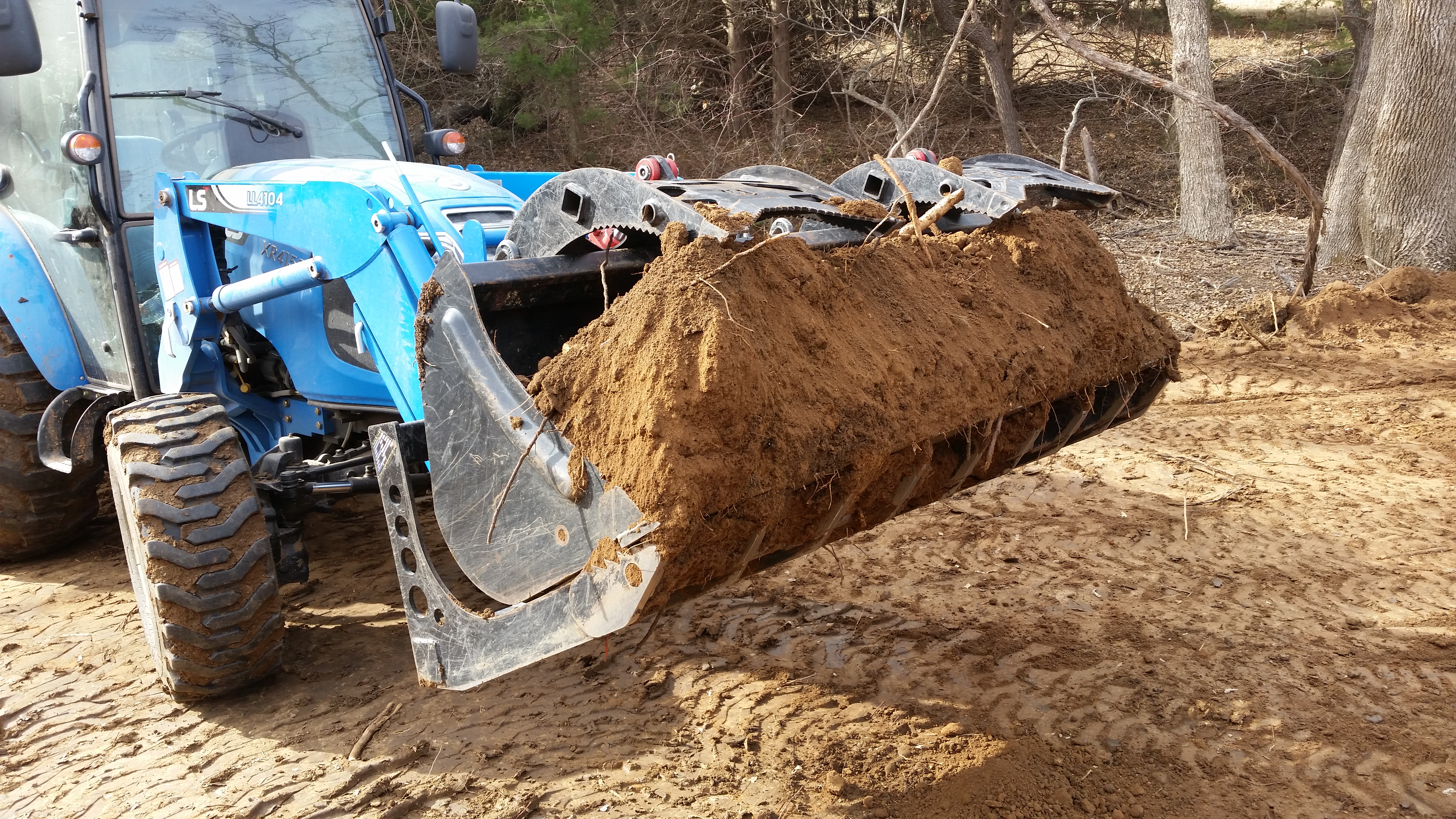

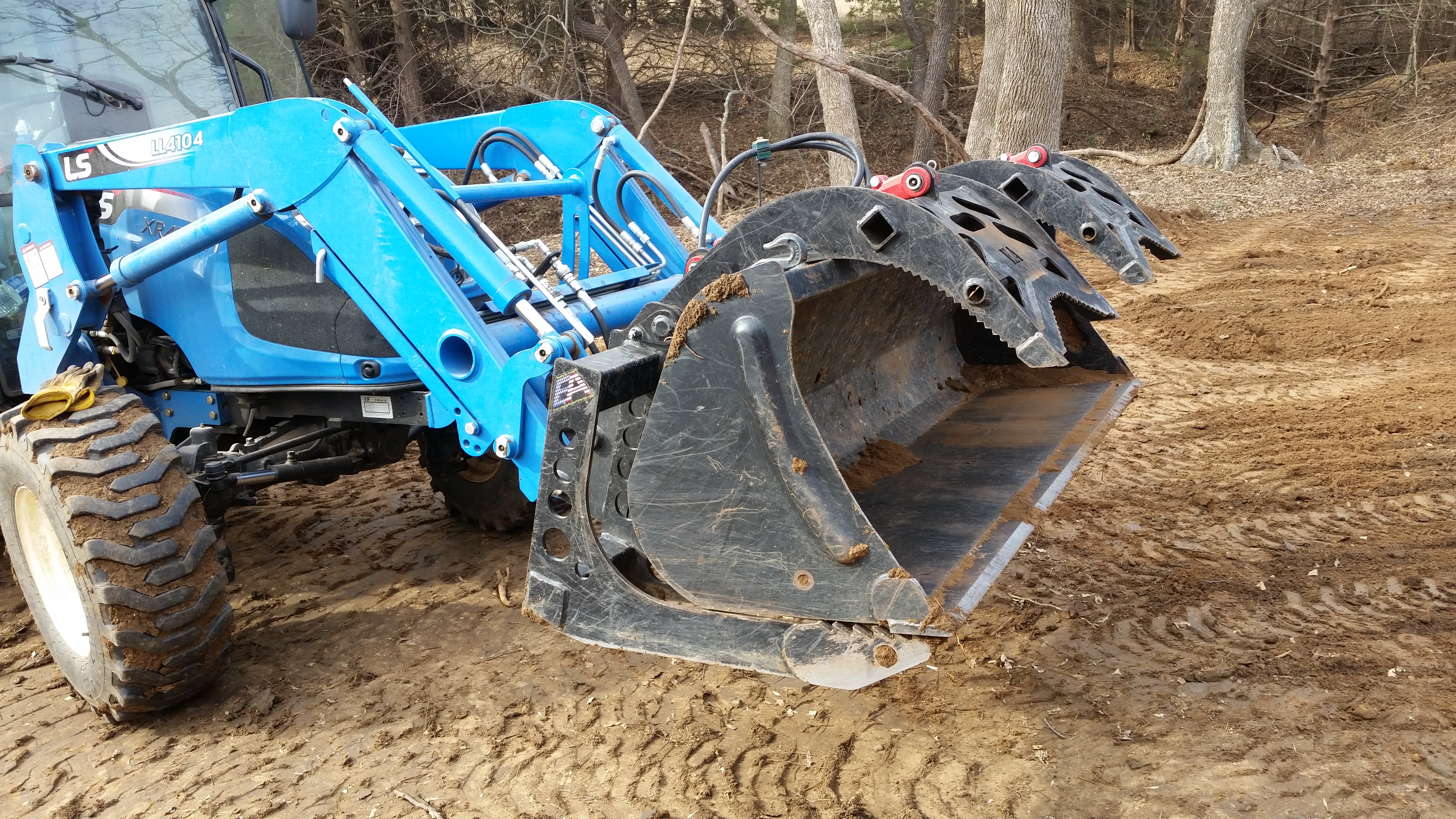

I've been busy at work and haven't had a chance to post here in a bit. I found a new way (to me anyways) to use my Wicked Twin. Instead of getting off and changing bucket/grapple/bucket/grapple ect doing a back fill the other day I just grabbed the bucket in the grapple and gave it a try. (insert epiphany here) It was a cold, blowing day so I didn't mind staying in the cab as much as possible.
Turns out I can scoop/haul/blade loose material really well by just grabbing the bucket in the grapple and using it almost like it was attached normally. I say almost because the bucket does move around some in the grapple. There is also an advantage in back dragging with this set up. The tines in the floor of the grapple hold quite a bit of loose dirt similar to a mini land leveler. If there is a little loose dirt it does a faster/cleaner final grade. WIN-WIN!!!
In this instance I was having to back fill and level a bit then drop the bucket to pickup roots/limbs that were coming to the surface and getting in the way of a good final grade. Just grabbing the bucket made the job go faster and easier on me. Smarter not harder!
All these uses for the Wicked Twin makes me wonder what else it can do!
