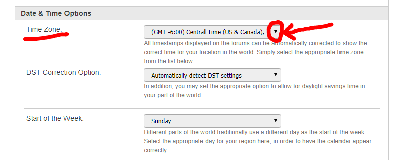

"All times are GMT." Never saw that before.
So to define "so out of whack" in the Eastern time zone, 4 hours ahead.
Now I know!
It is GMT + or - x You have to set it to your time zone on the My Home page, General Settings link:
All post times show my local time, not the poster's local time.

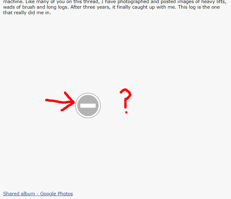

I am not seeing the pictures ^^^
   / The WICKED Root & Debris GRAPPLE!!!!!!! #3,479
I added links to the images. Anyone else having trouble seeing the images originally posted?
I couldn't see pictures then, now the links work fine.
This is what shows on my computer screen:
   / The WICKED Root & Debris GRAPPLE!!!!!!! #3,480
I can't see the original photos but the links work.
