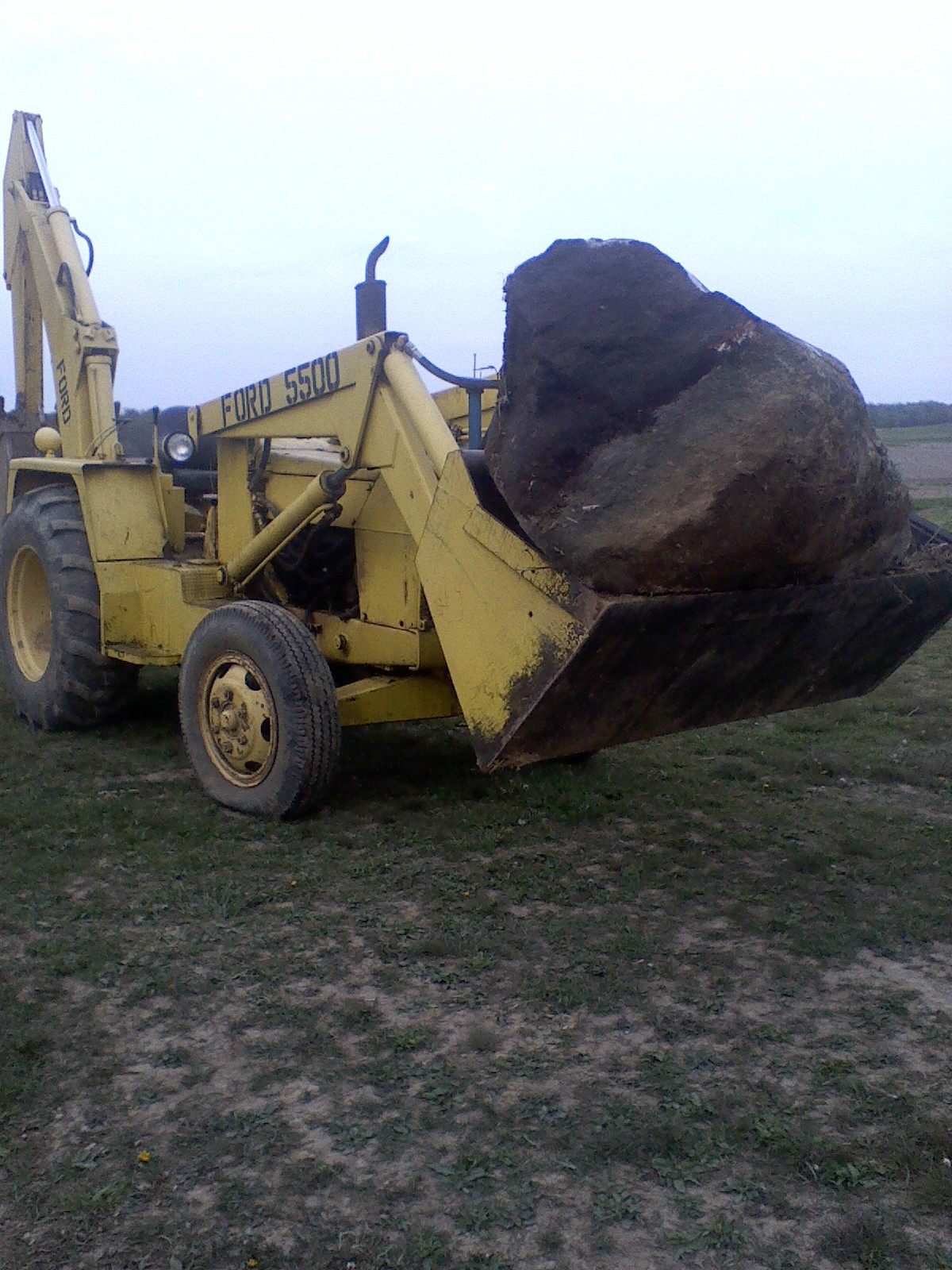

That's a good sized pebble!!
edit to add; I use my loader all the time but seldom at max capacity. Having the tire filled makes it easy for routine work.

You need to do more loader work :thumbsup:
Dig out some stumps or find some more big boulders, or lift some large logs with some forks. IF you are able to lift everything you try, you arent trying hard enough.
Only time I never find something I cannot lift is when I am sitting on my backhoe.
Your right front tire looks a tad low there LD ...
:laughing:
   / Theory of rear ballast? #76
It was a little low in that pic. Down to ~70psi.
They are supposed to be ~110
