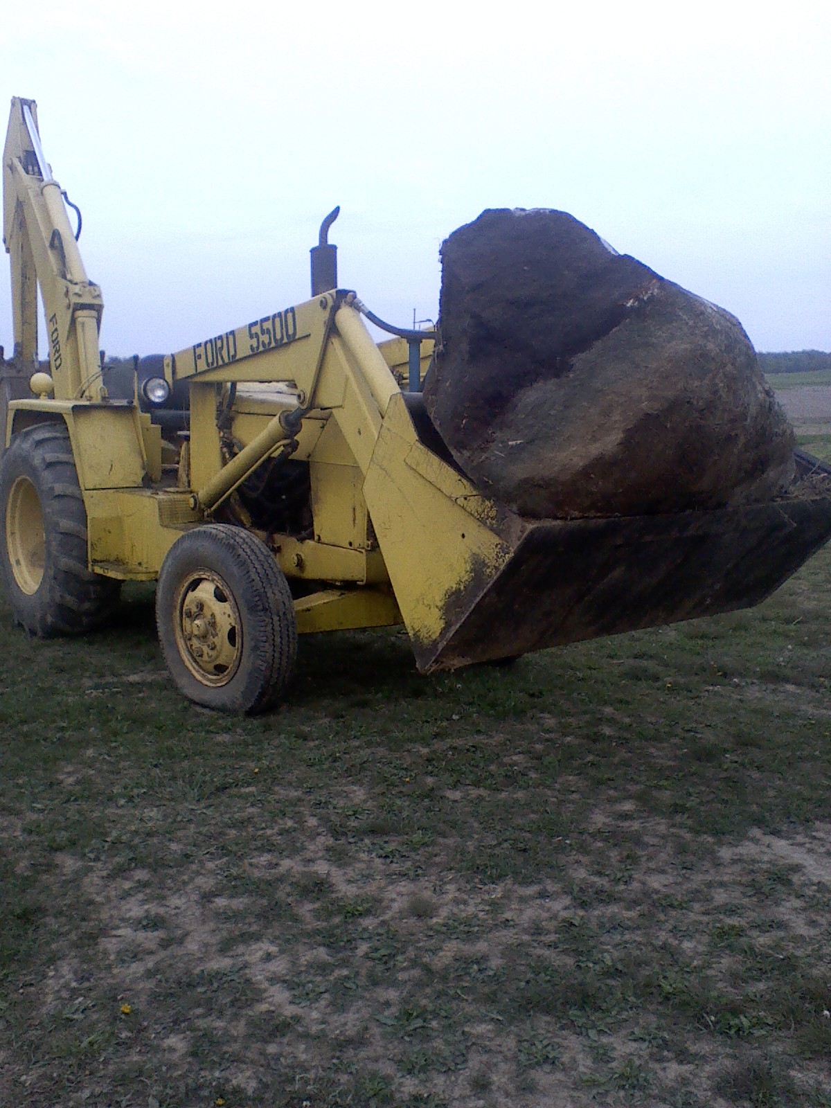

I haven't done much heavy loading as yet, that rock in the picture being the biggest thing I've pulled out and up. That day I had the frontier 72XX cutter on the back and that was enough. The only time I've lifted a rear tire I had the bucket wedged under a Chinese rock (the other end sticks up in Tiananmen square) and no amount of balance would help. Loading snow , fire wood and logs the beet juice is enough. Right now if I had to bale a lot of heavy stuff I'd put on my case two bottom plows and not try to over fill the bucket each bite.
   / Theory of rear ballast? #68
sufficient ballast would keep the rear planted. Thats the point of ballast. If latched onto something you absolutely cannot lift you want to max out the relief on the loader and keep the back tires on the ground.
If the calculated 1600# or so that you figure does that for you, then yea its enough. But if latching onto that rock and you can still lift the back tires, it isnt enough.
