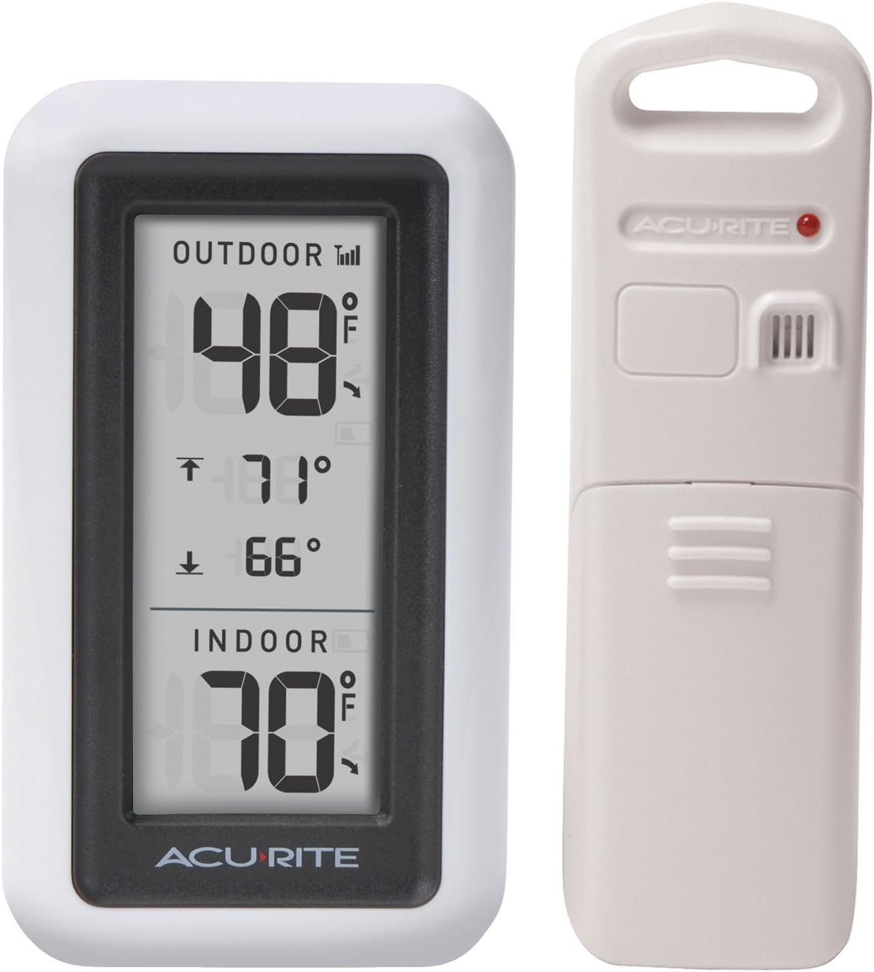

I'm often curious about what the actual air temperature is when I'm on the tractor. I tried putting a regular outdoor thermometer by the dash, but the sun always messed up the reading. I wonder if there is an automotive style thermometer that could be used, and where you would put it's sending unit for an accurate reading.

VDO has/had 2" gauges. I'd put the sensor up front and in a spot the sun can't hit. As in low.
   / Thermometer For Tractor #4
I use this one from Accurite:
I glued a magnet to the back of the display and stick it on a metal surface inside the cab. No wires to run and it shows both inside & outside temps.
I zip tied the transmitter under the cab roof overhang out of the direct sun.

Seems like a good trick to find a place for an air-temperature sending unit that's always in the shade, and away from the heat from the engine. Even in the seat area it's affected by the engine's heat. Although, our car and truck have thermometers, and I think the senders are under the hood somewhere.
bdhsfz6- That's a good idea. I'm going to go that route. We have that same set-up in our house. I like the no wires aspect, and I can experiment with where to put the sender. Why didn't I think of that?
Thanks, Jim

Whoops - I just remembered that those Accurite sending units have a really long reach. When I bought a second Accurite thermometer for a room on the other side of the house, I found that the original sender also reached the second display unit. As much as I like the Accurite units, I think I should look for a different brand for the tractor to avoid cross-contamination confusion...
   / Thermometer For Tractor #10
Yes, they all use the same 433 MHz frequency. Unfortunately many other brands do as well. Best check before you buy.
