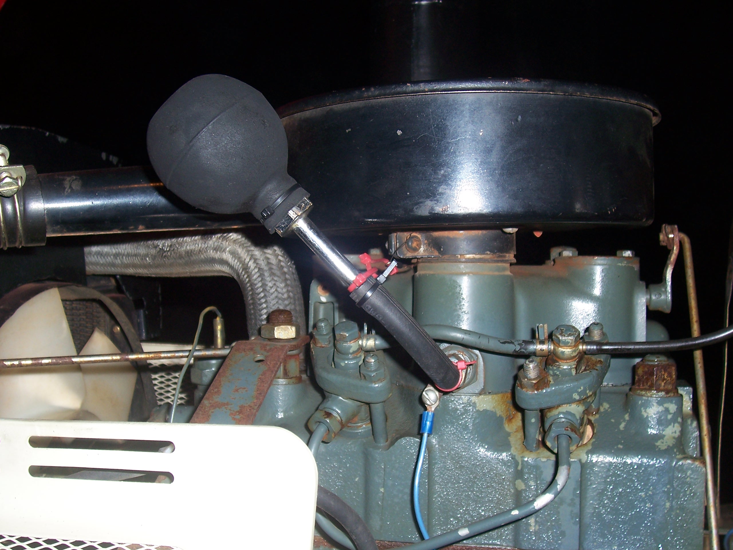

I don't have the mounting bracket either or the cup and very Rarely ever use it here in Ga. My TS.Igniter worked after running a test lead to it and then I wired it to the Ign. switch and this is all I used. It's off an old Antifreeze tester and a old fuel line. What really works good and to fill it just give it a squeeze and stick it in the the Fuel Can or Tank. I leave it off most of the time.;)
