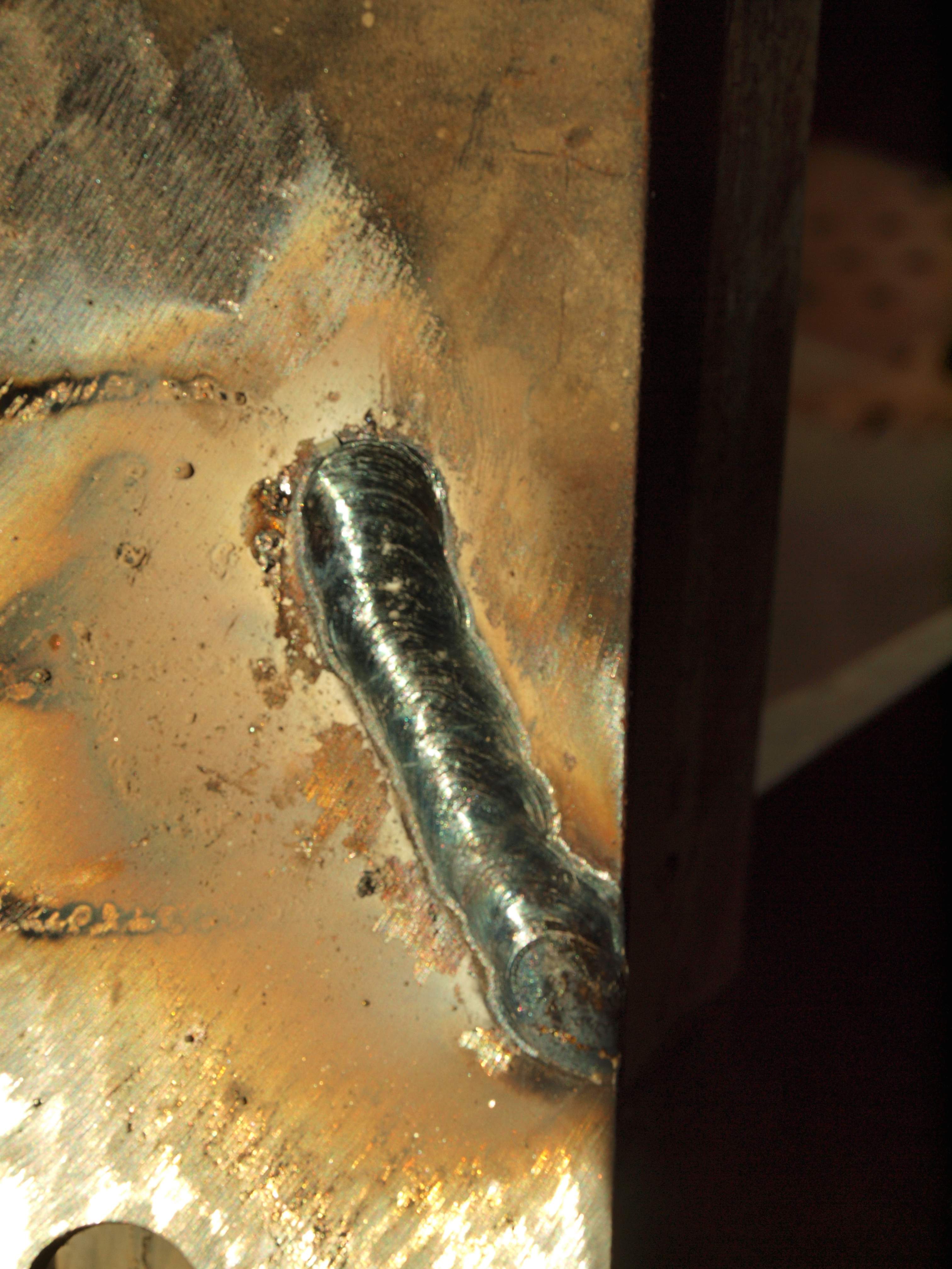

I'd say the numbers are off on my PA-300. My Lincoln V350-Pro does the same thing with 20 to 25-amps less on the read out. Personally I don't pay a lot of attention to gauges, I just use them as a reference. I do what ever the puddle requires. ;)
First SA let me say it is a pleasure to have you back. I believe you are correct that different welders have differentiated "controls" I ran this bead at 122 amps on my little SW 140. It looks to be a bit undercut as well so I throttled back to 115. Seems to run best at 120 on my machine.
   / These thinhgs I have..this project I have..."Advice" I need! #20
Along with the welder dials not being exactly calibrated from machine to machine, you also have the fact that each persons household supply voltages likely to vary. Some households are connected at the high end of the tolerance (240 volt and 120 volt) and some households are at the low end of the tolerance (220 volt and 110 volt) and then the majority is somewhere in between with an average of (230 volt and 115 volt).
At simplified level; a welding is nothing more than a voltage converter that converts your household input voltage to an output voltage that is suitable for welding. Or in other words, take a given welder to someone else's house and you will likely have to adjust the dial a bit from where you normally run to account for their household voltage being slightly different than your household.
