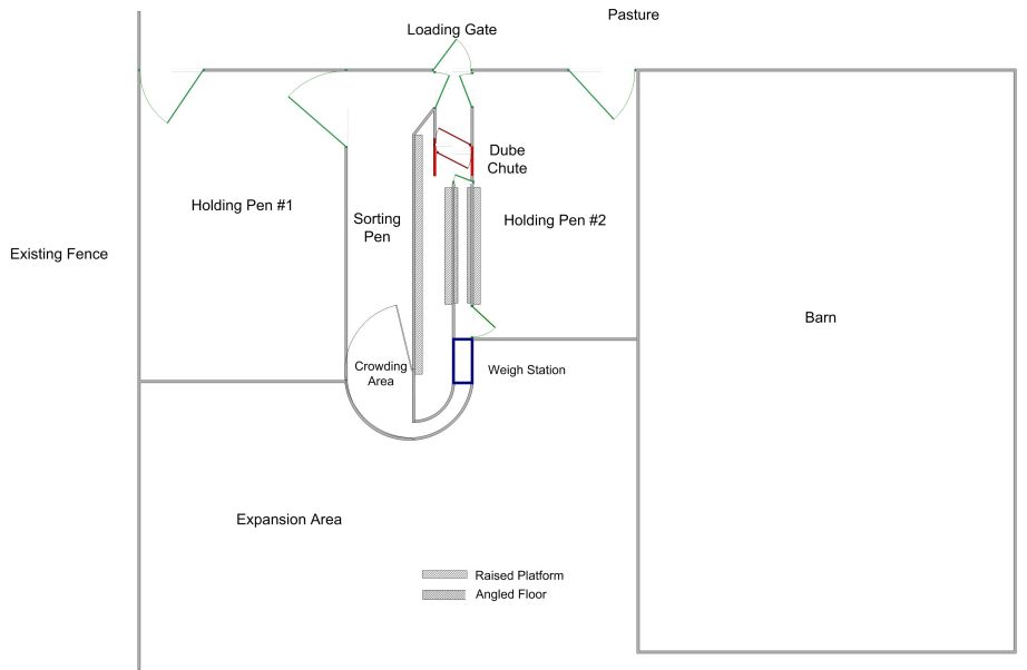

I do agree that we should start a cattle handling thread to resume this, but I did want to post a couple of things. We talked to a guy who designs WW systems. He was nice enough to lay out a small system for us. The price tag was over $10K!!! :eek:
In the mean time I started drawing one out to serve our purposes. Here's what I've come up with. It's not to scale, this is just a rough sketch. It may be a little hard to understand the function of the Dube Chute and loading gate if you are not familiar with them.

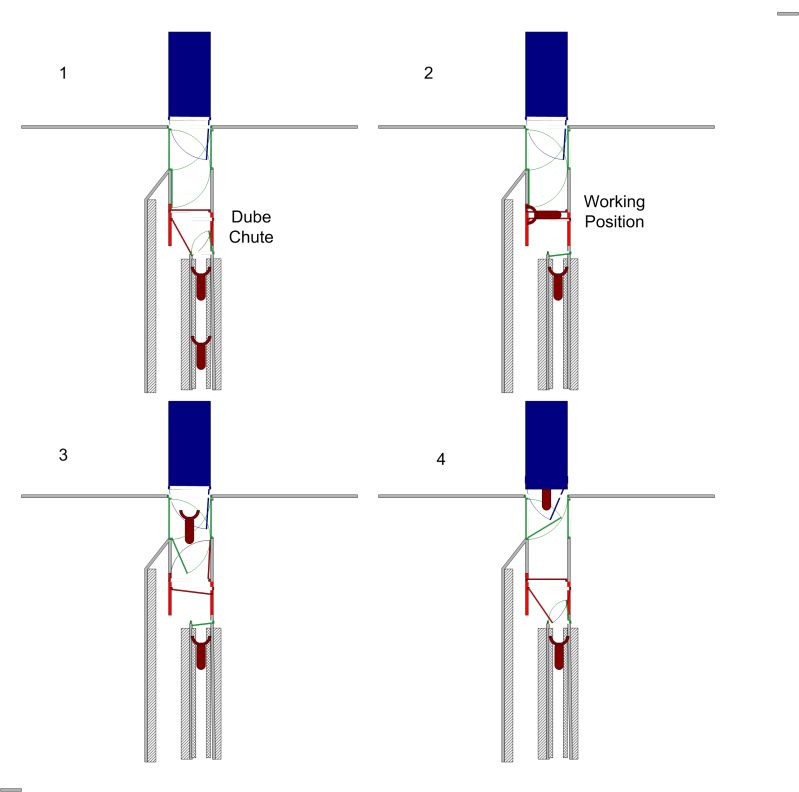

This might help, threw this together to show how the Dube Chute squeezes with opposing gates. I think they call this a meranda hinge (not sure on the spelling there). And also shows how we'd load out through this system. The blue thing at the top is the trailer. It gets a little busy with all the gates drawn in there, but we want flexibility.
