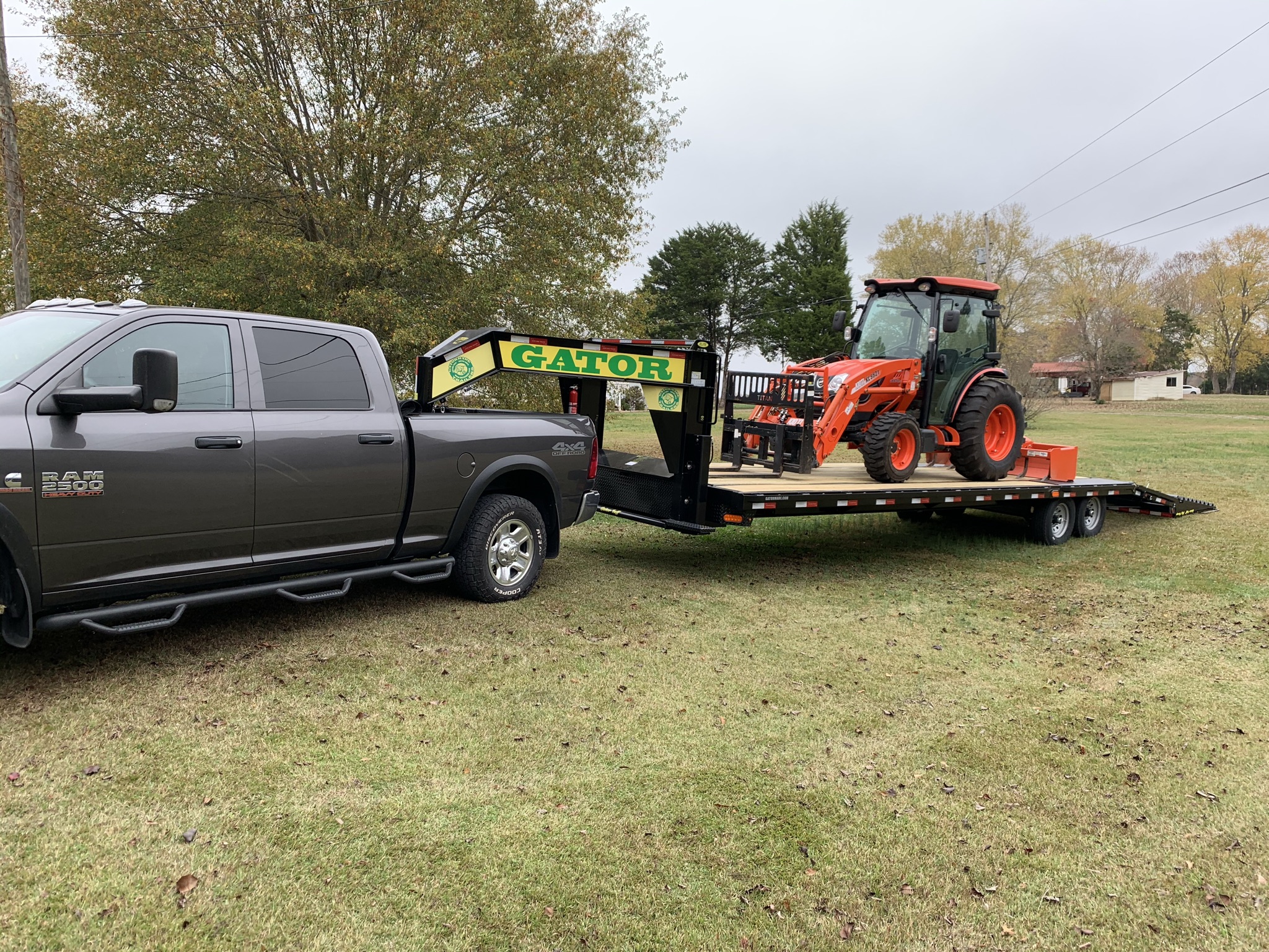

Got my trailer yesterday. Had to load the tractor to see how it fit.
