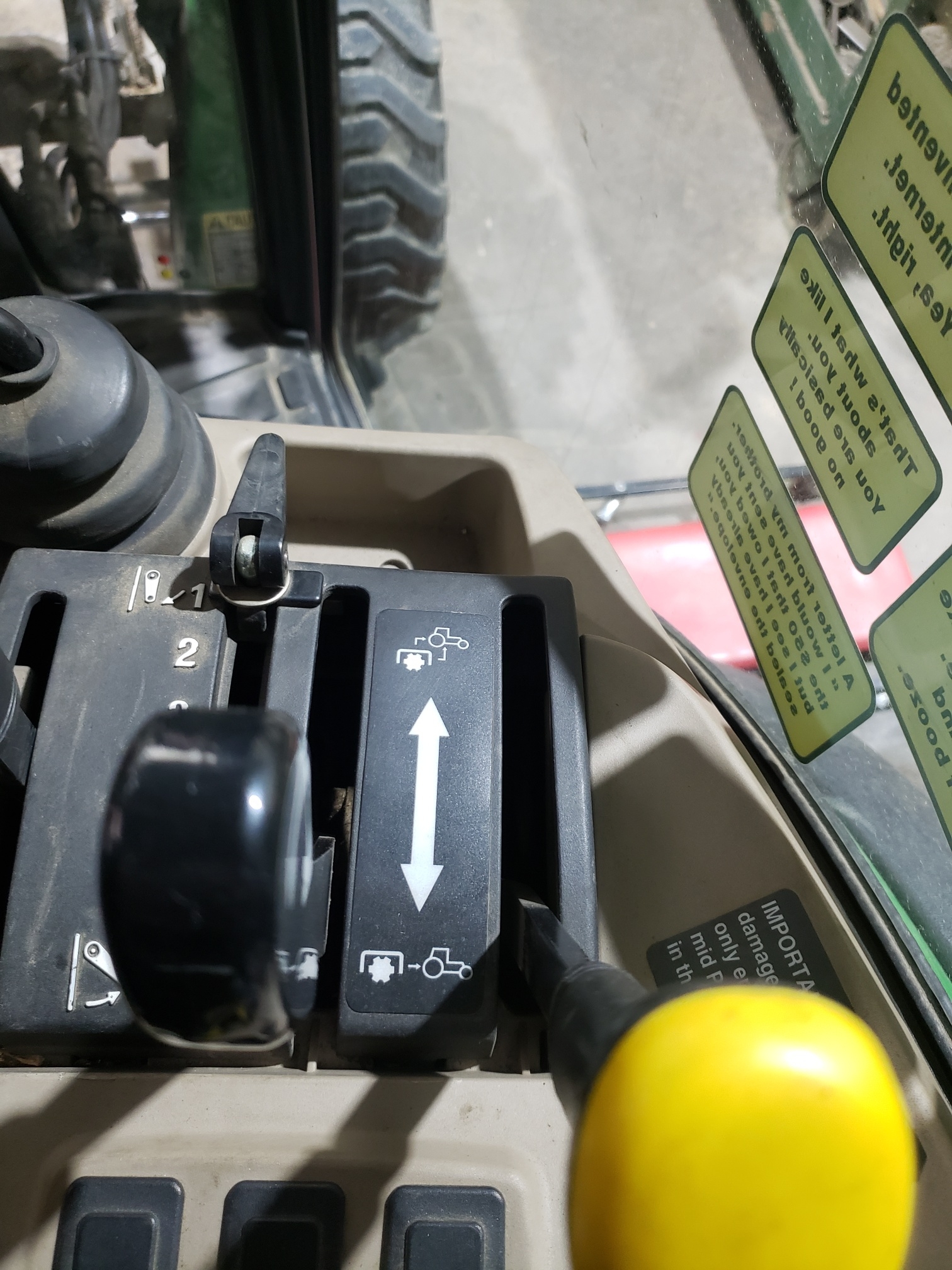

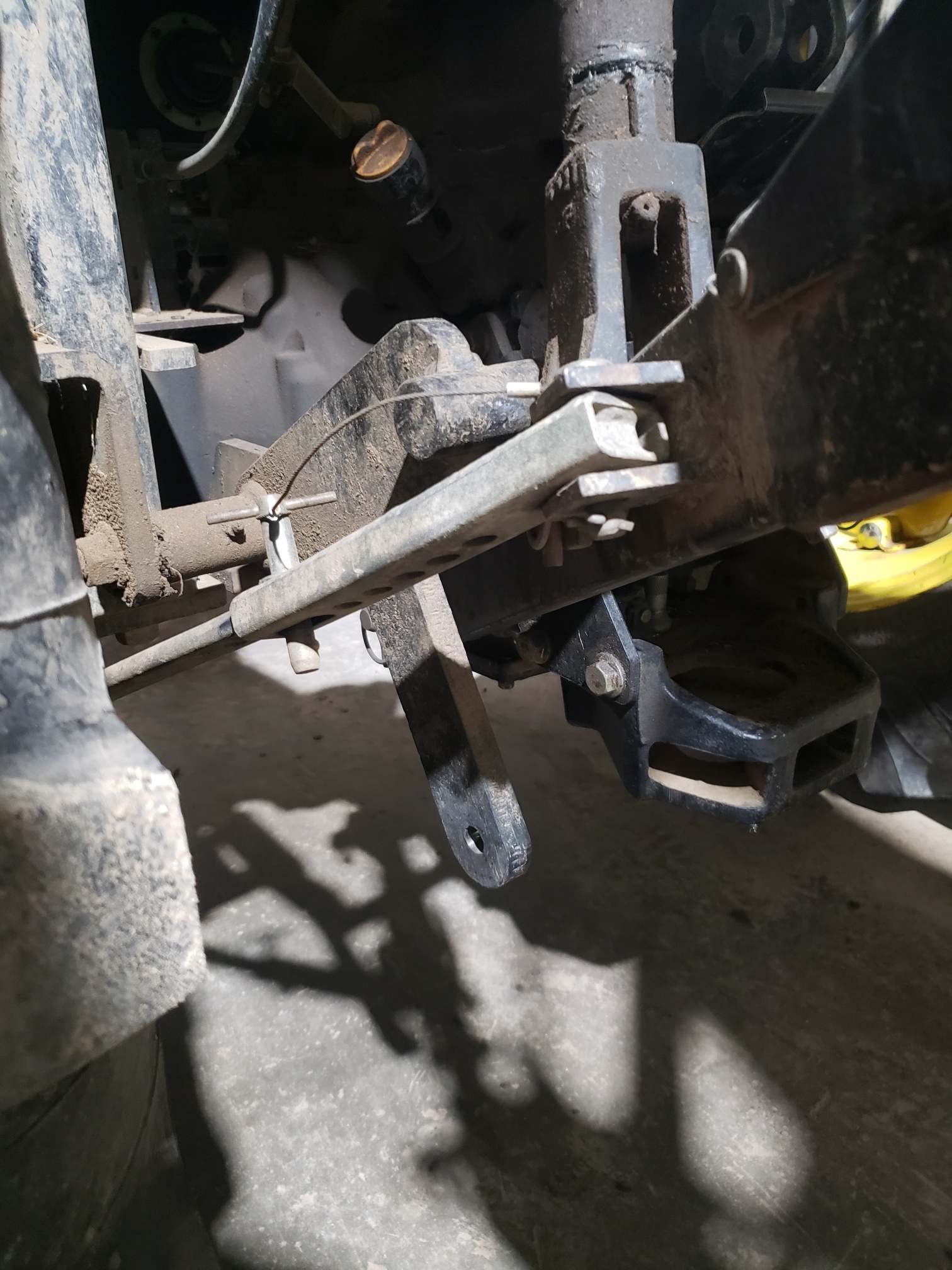

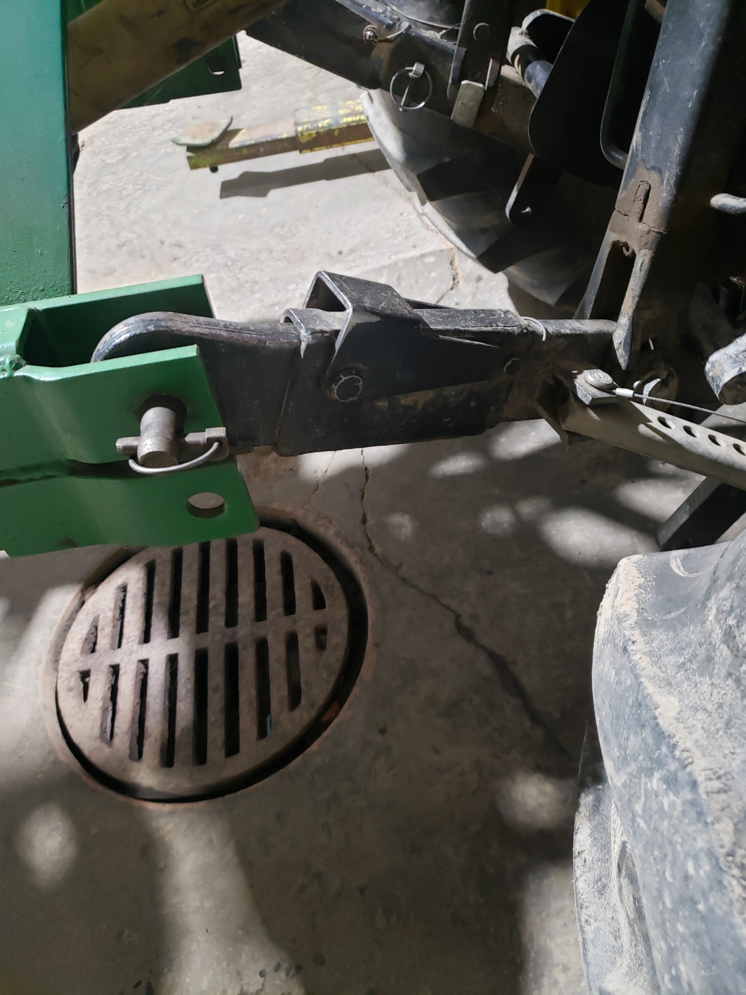

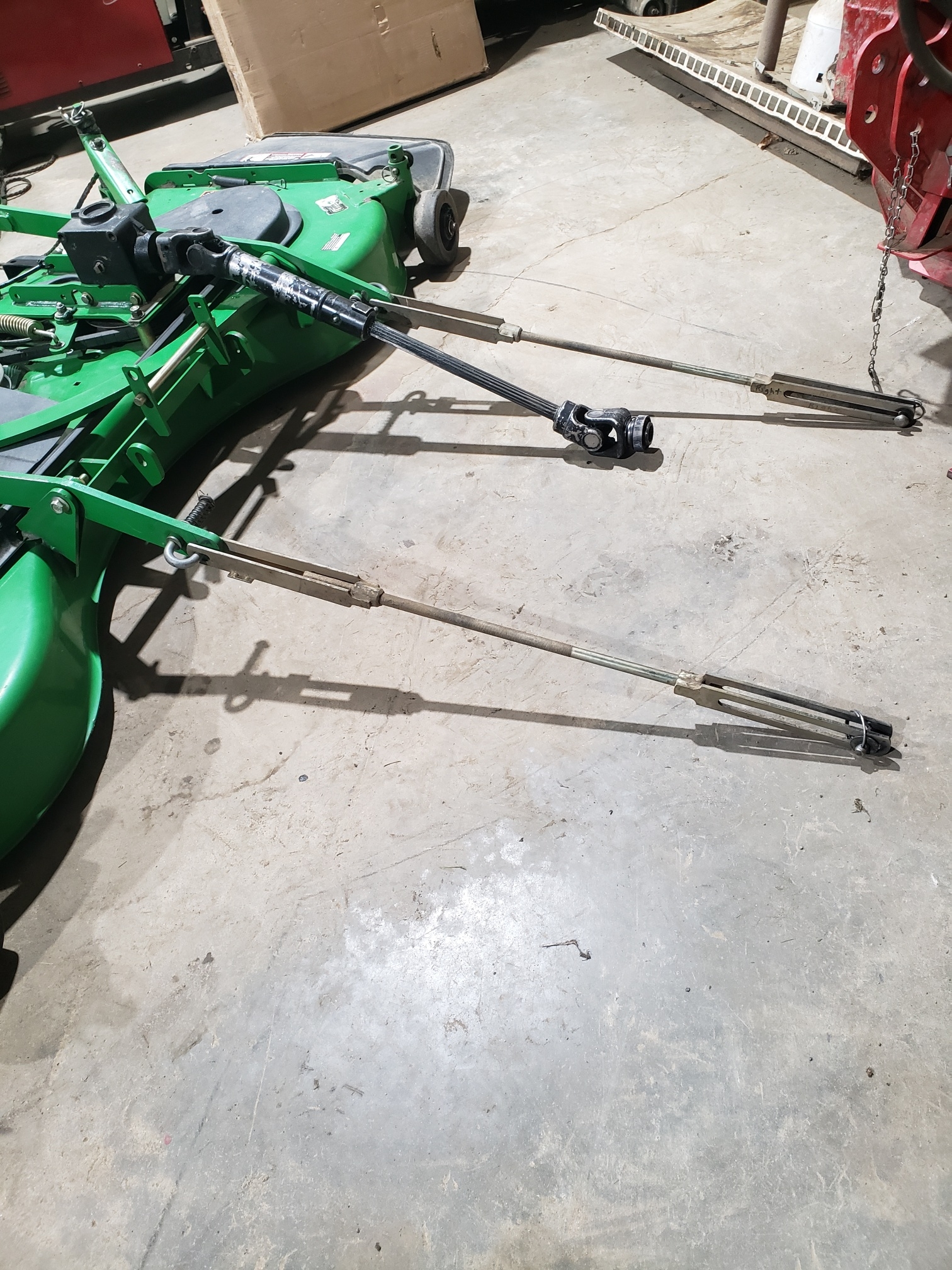

Rear mower connection points with adjustable links on rear of mower deck20241123_110453_resized.jpg

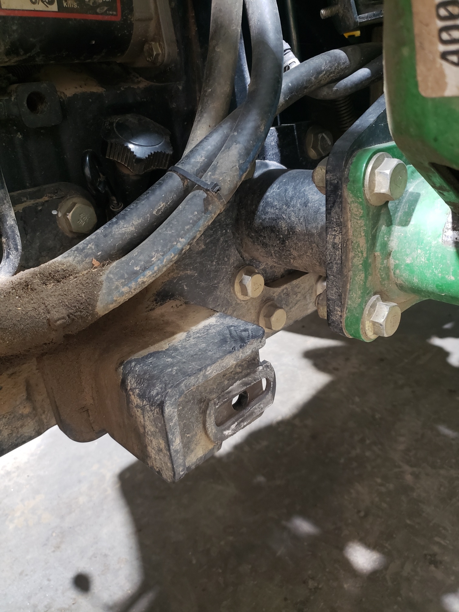

Mid mower connection points, bolts with/ to/ loader mount20241123_110314_resized.jpg

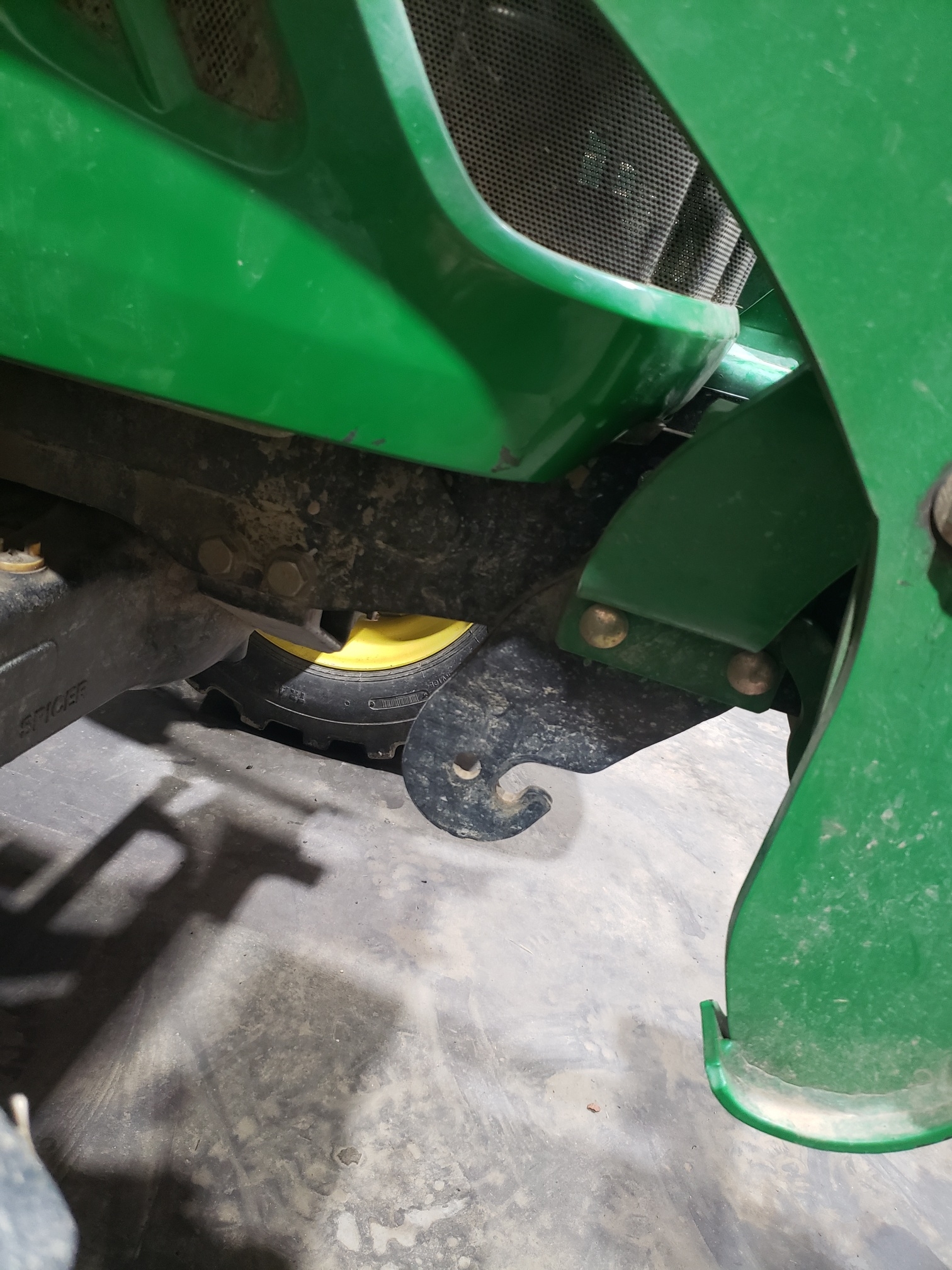

Front mower connection point, connects to bracket on front of mower20241123_110250_resized.jpg
Mower deck with attaching brackets front middle and rear20241123_110153_resized.jpg

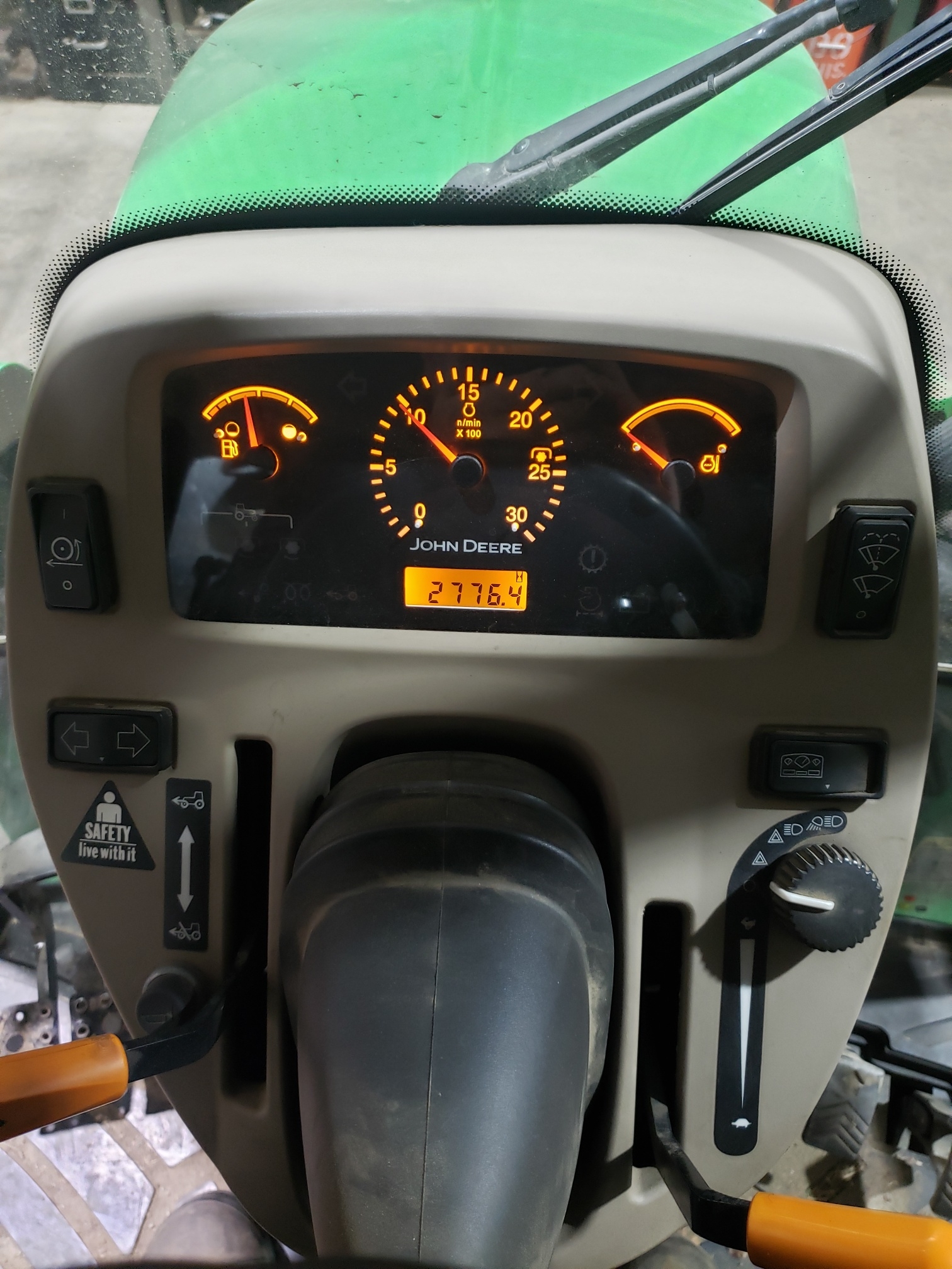

One more picture and it is of the dash. The top left rocker switch is for the load match. The horz. rocker switch just below the windshield wiper switch is for accessing the diagnostics. 20241123_111425_resized.jpg

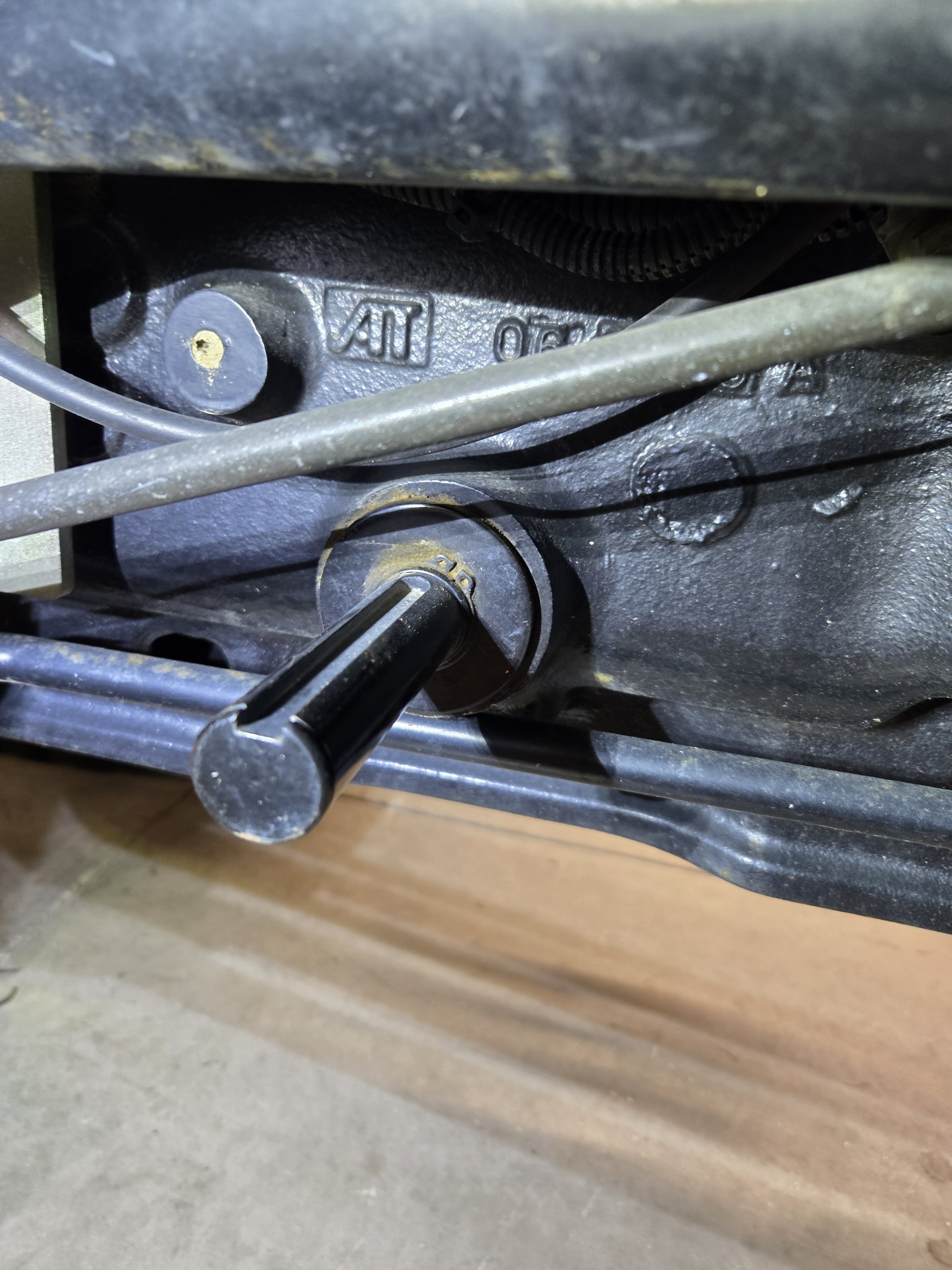

I sent you a pm the other day, just wanted to follow up and see if you received it. Also, I had a couple more questions- have you installed a 3rd function? I have 1 set of rear remotes and am wondering if it can be done. Also, do you know what this shaft is for? It spins freely. Thanks

. In the maintenance cd that I am sending you shows the factory 3 functions at the rear of the tractor and maybe they are still available. That shaft with the keyways is a "i don't know". I always thought is was something for tractor assembly. Here is the part # LVU801256. Later
