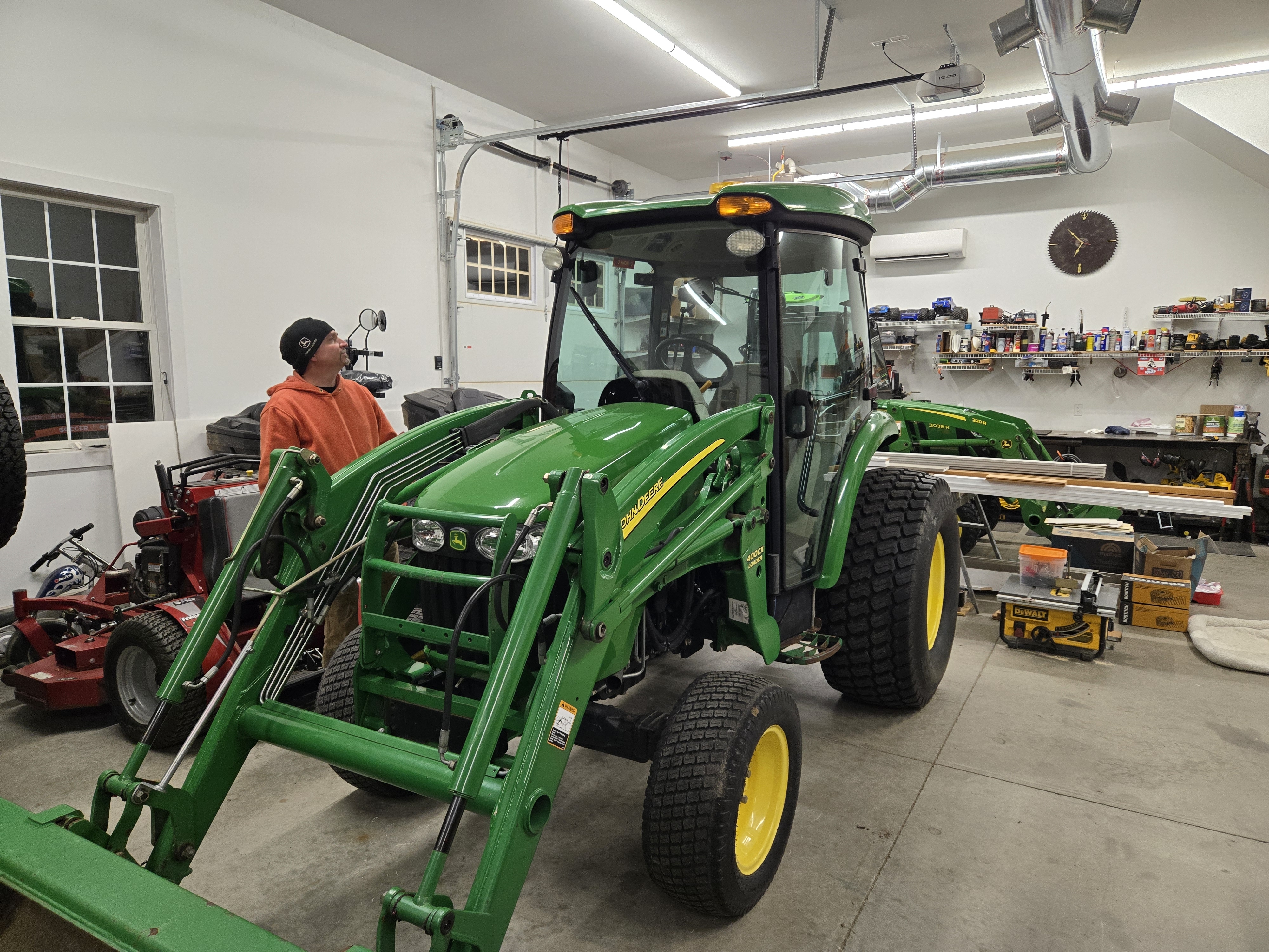

Thank you oldtimer66. It was your write up that got me wondering about the prevalence of this issue. I decided the risk and cost was worth it. I purchased an 06 4720 with 410hrs similarly optioned to yours. The thing it is missing that I want to add is the belly mower (possibly 3rd function).
Did you add the mid pto and associated lifting hardware for the mmm? Do you know if the 7 iron deck is specific for the 4x20 or if the same deck is used on other 3 and 4 series?

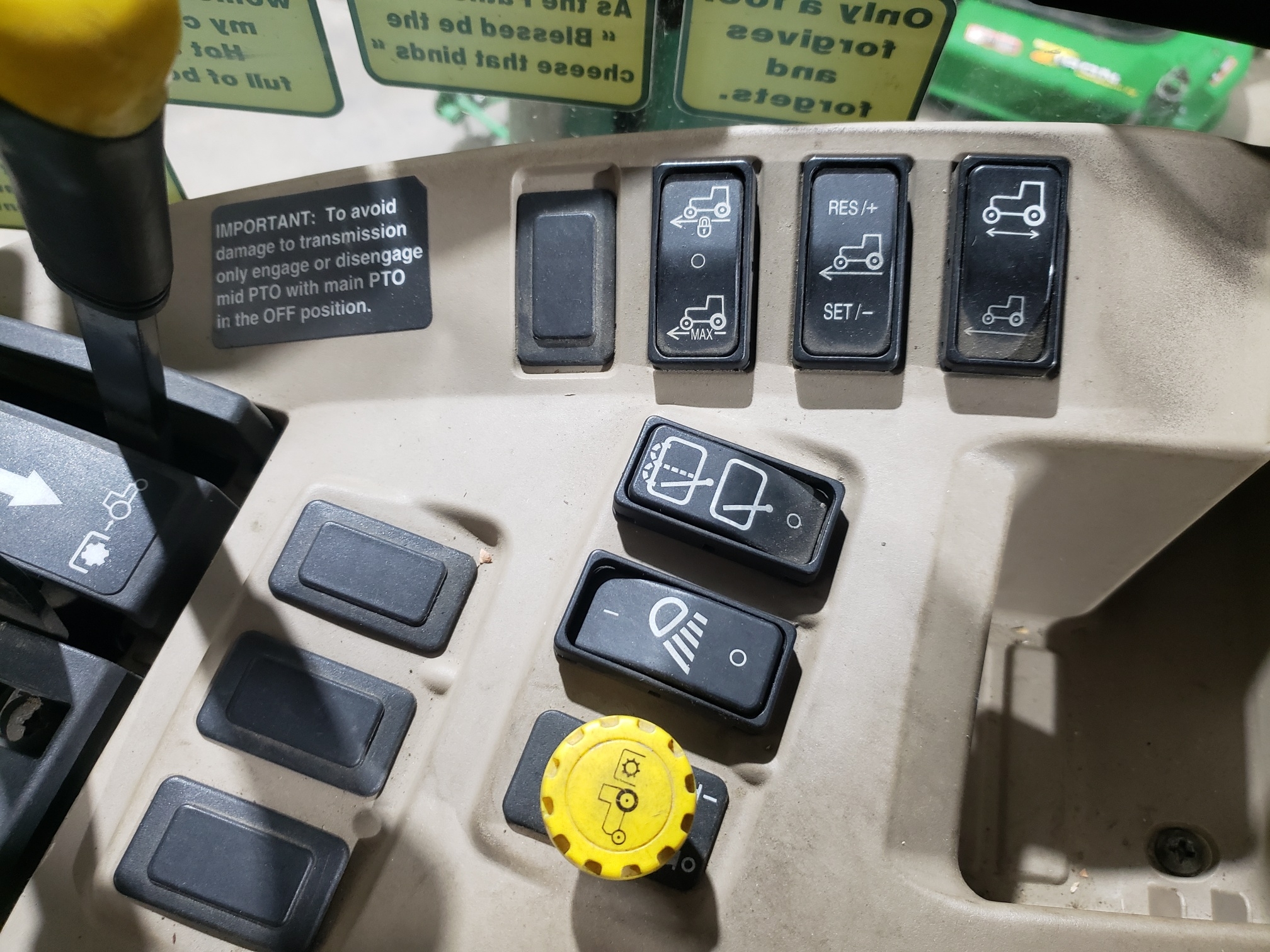

Nice tractor with only 400 hrs. It should be 59 engine H.P.. I ordered my tractor with the the mid mount mower, aka "7 Iron". I don't know if it is specific for this tractor, but maybe because of the mounting's. The dealers quotation was off by some amount/ low/ because of the way the MMM was listed in the catalog but the dealer did not charge extra. I have the manual on the mower deck/ assemble etc. I will get you the parts number for the instructions. It's very detailed on the parts you would need picture wise. The mid PTO/ rear PTO has the yellow on off pull button, live, along with a selector arm to switch between the two PTO's. You can activate the rear PTO with the parking brake set, from outside the tractor. I don't have any details on the physical mid PTO assemble itself. I think this is where the dealer had his ordering problem. The mid PTO was a "kit type " of accessory. I would assume that it is still available. I have the mower deck off right now but I will put up some pictures of it here along with the tractor mountings. The mower deck height adjustment was mickey mouse. They replaced a cable but that didn't work. If you get the mower and mountings I can detail my fix for that problem.

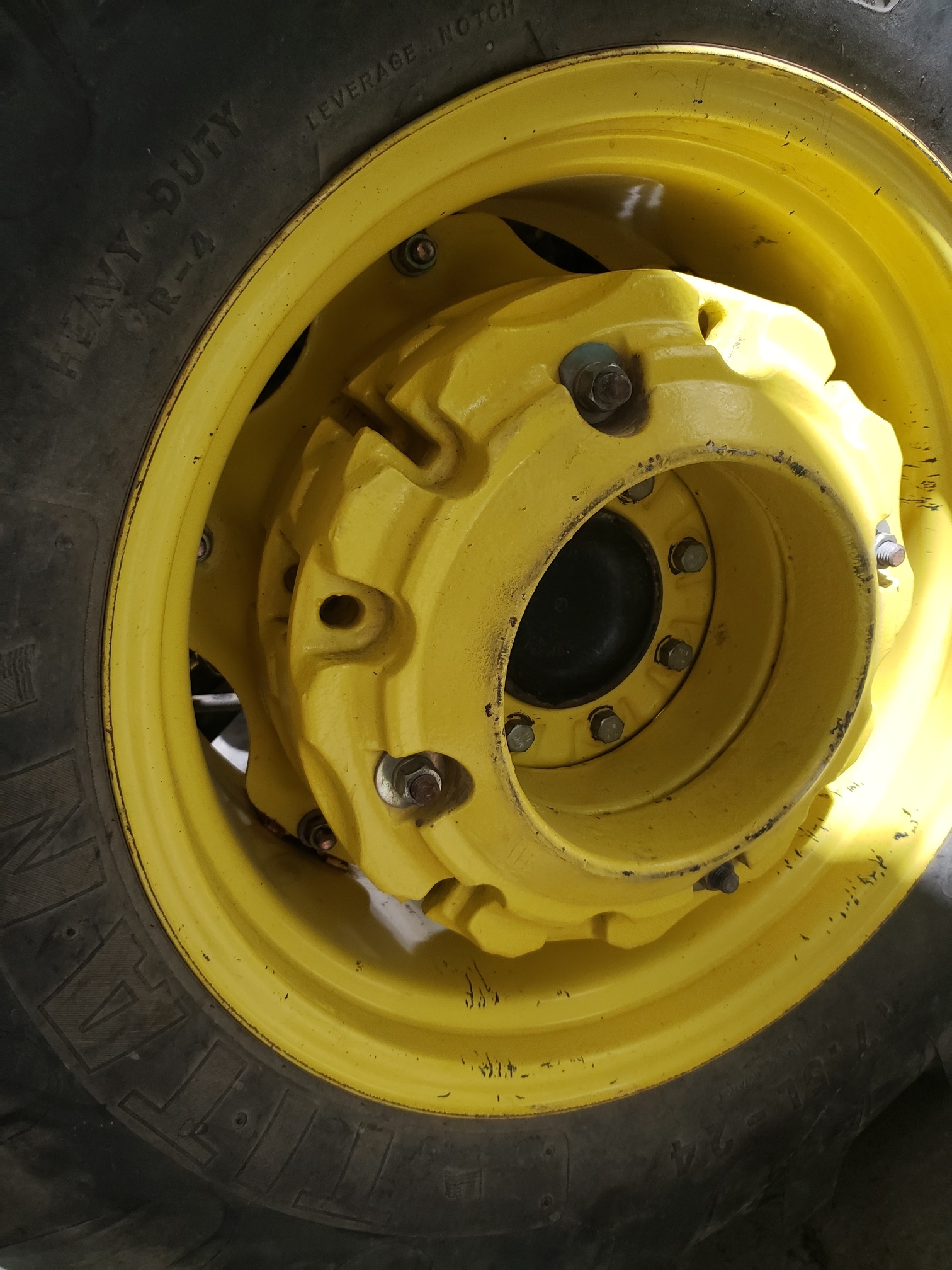

Here are some pics of the mower and tractor details.
Left handle rear remote, middle 3 pt / mower height, end yellow PTO selection20241123_111039_resized.jpg

Bar tires with adjustable rims on 2006 models and others20241123_110543_resized.jpg

Mower deck with attaching brackets front middle and rear20241123_110153_resized.jpg
I think I made a mistake, your tractor is only 58 H.P. I am getting old.

One more picture and it is of the dash. The top left rocker switch is for the load match. The horz. rocker switch just below the windshield wiper switch is for accessing the diagnostics. 20241123_111425_resized.jpg
