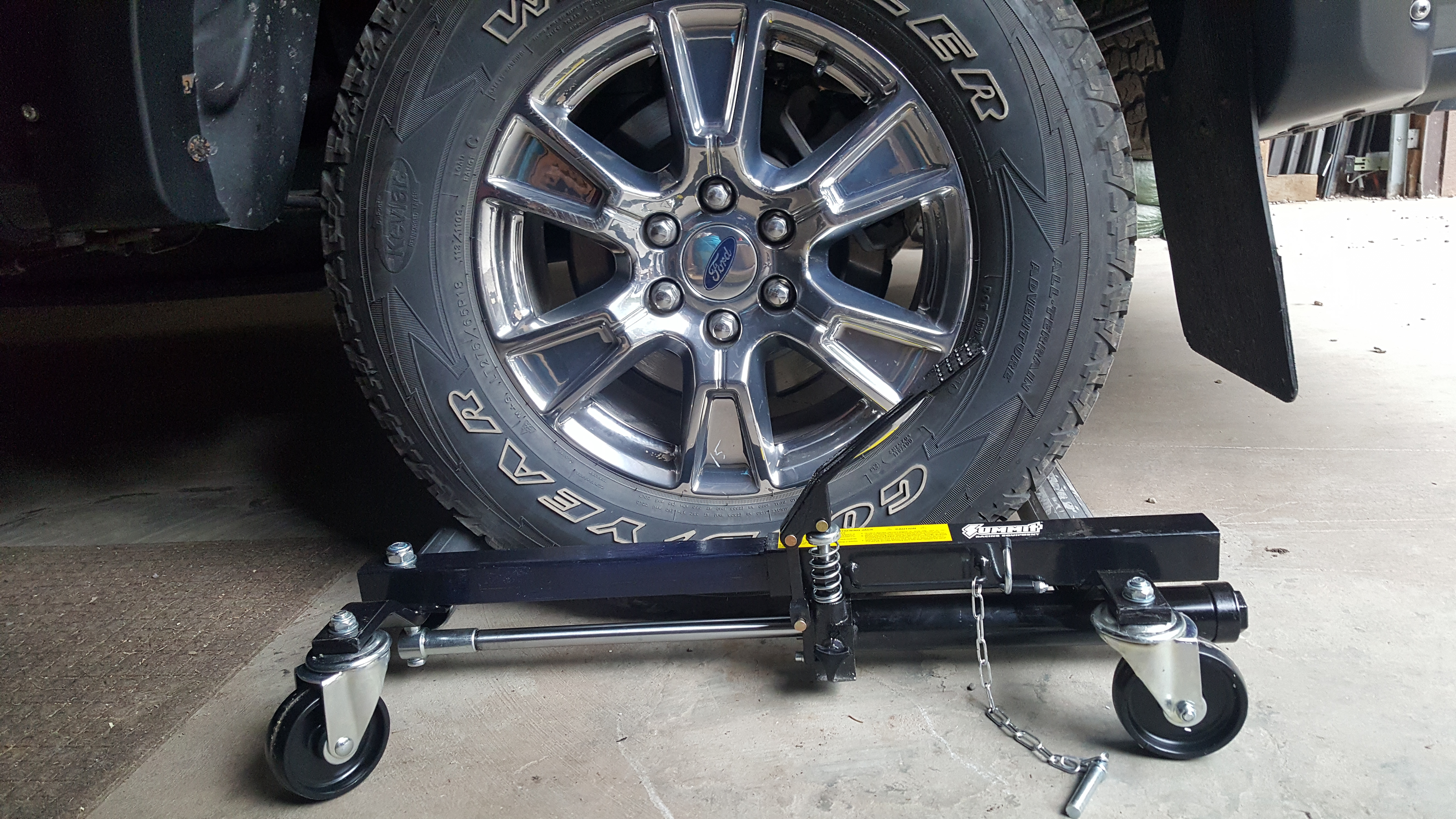

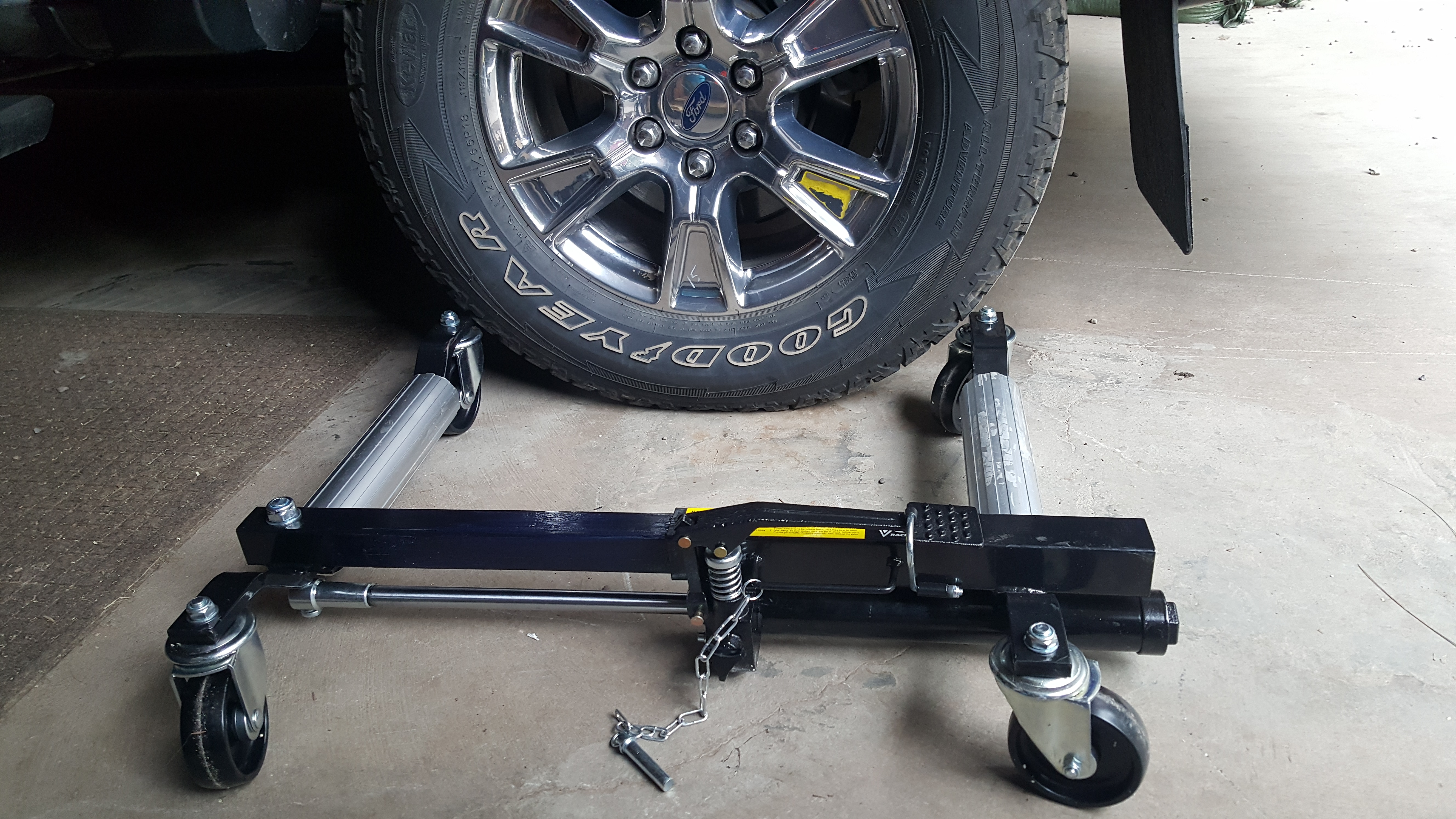

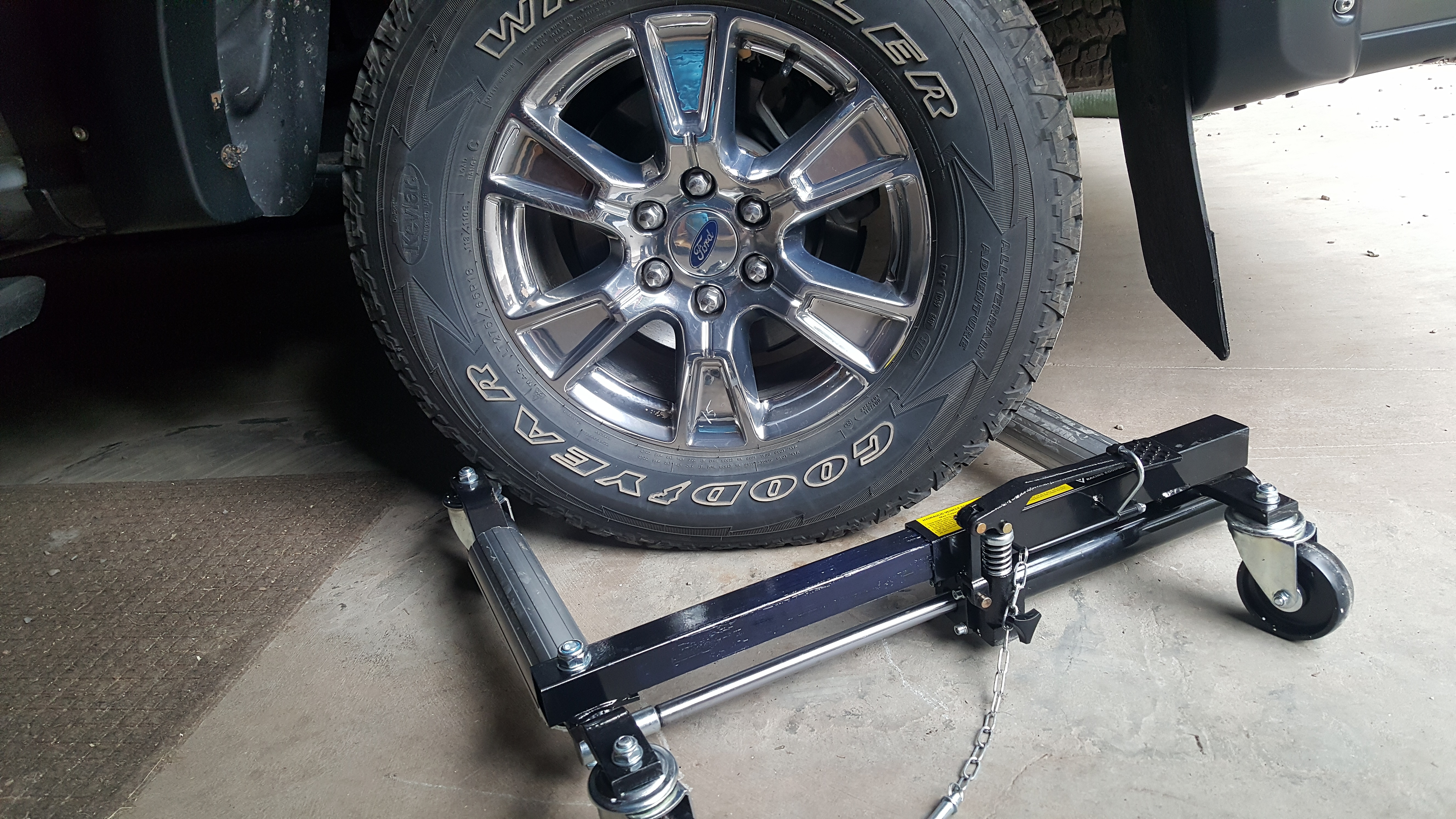

Yesterday I received my Vehicle Skate Dolly and I checked it out today, so glad I did the research and purchased one.
The real good news is the round pipe that the tire rest on does rotate and that makes a lot of sense because it takes less friction while jacking the tire up if you were to use the skates to raise all 4 tires in order to push the vehicle around.
The only drawback I can see is on larger tires it may be difficult to use as designed, you may have to use another jack to raise the tire enough to position the skate.
On my truck tires that came with the vehicle I have to push the skate in at an angle and hook one wheel behind the tire and then push the other wheel into the rear of the tire (my truck tire will not allow this skate to be pushed onto the tire by pushing the skate wheels straight at the same time).
For what I am going to use this skate for it's going to allow me to use a lot less pushing/tugging /pulling to install my other set of tires (studdedtires/wheels).
I hope this information will help others.

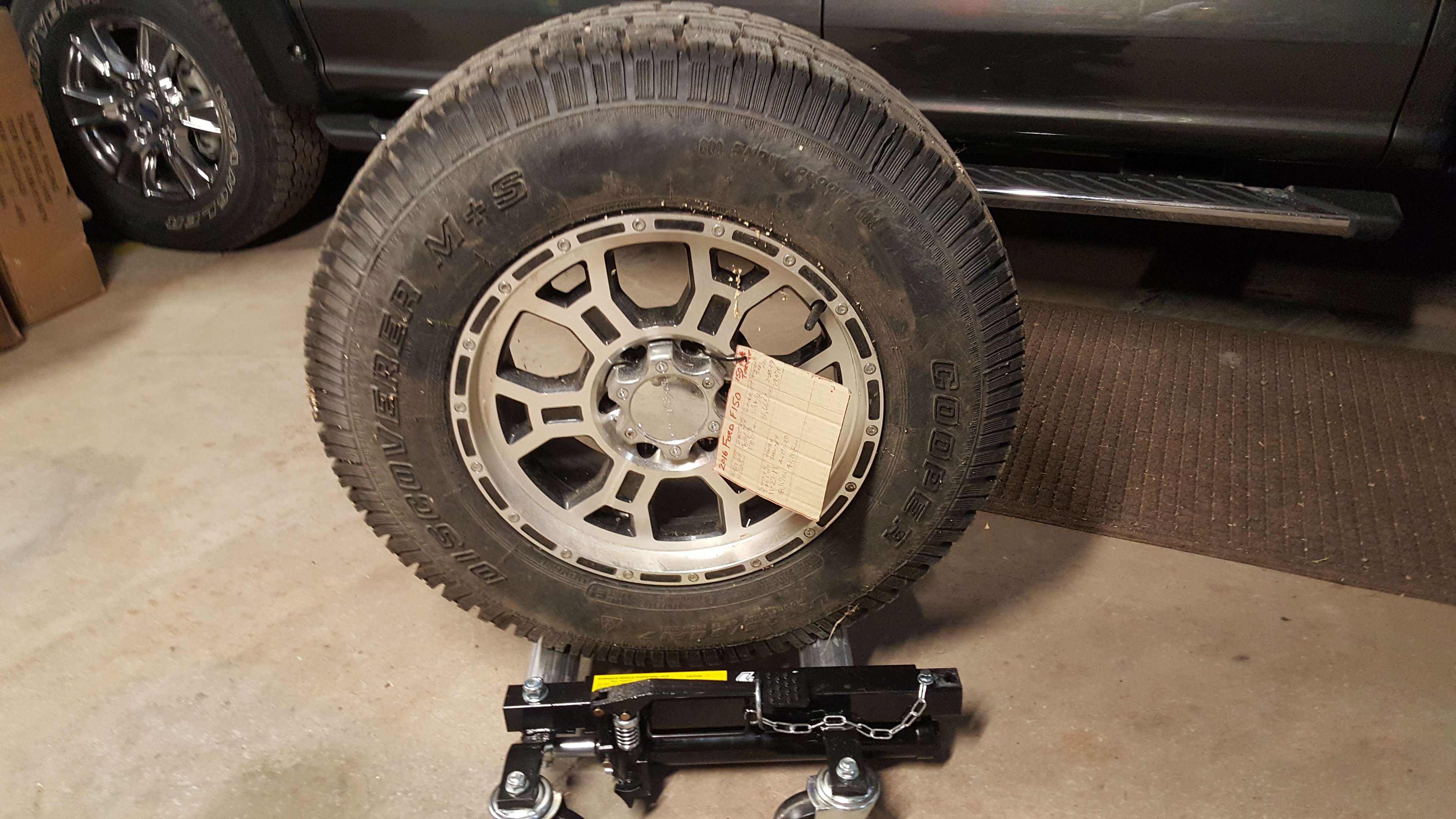

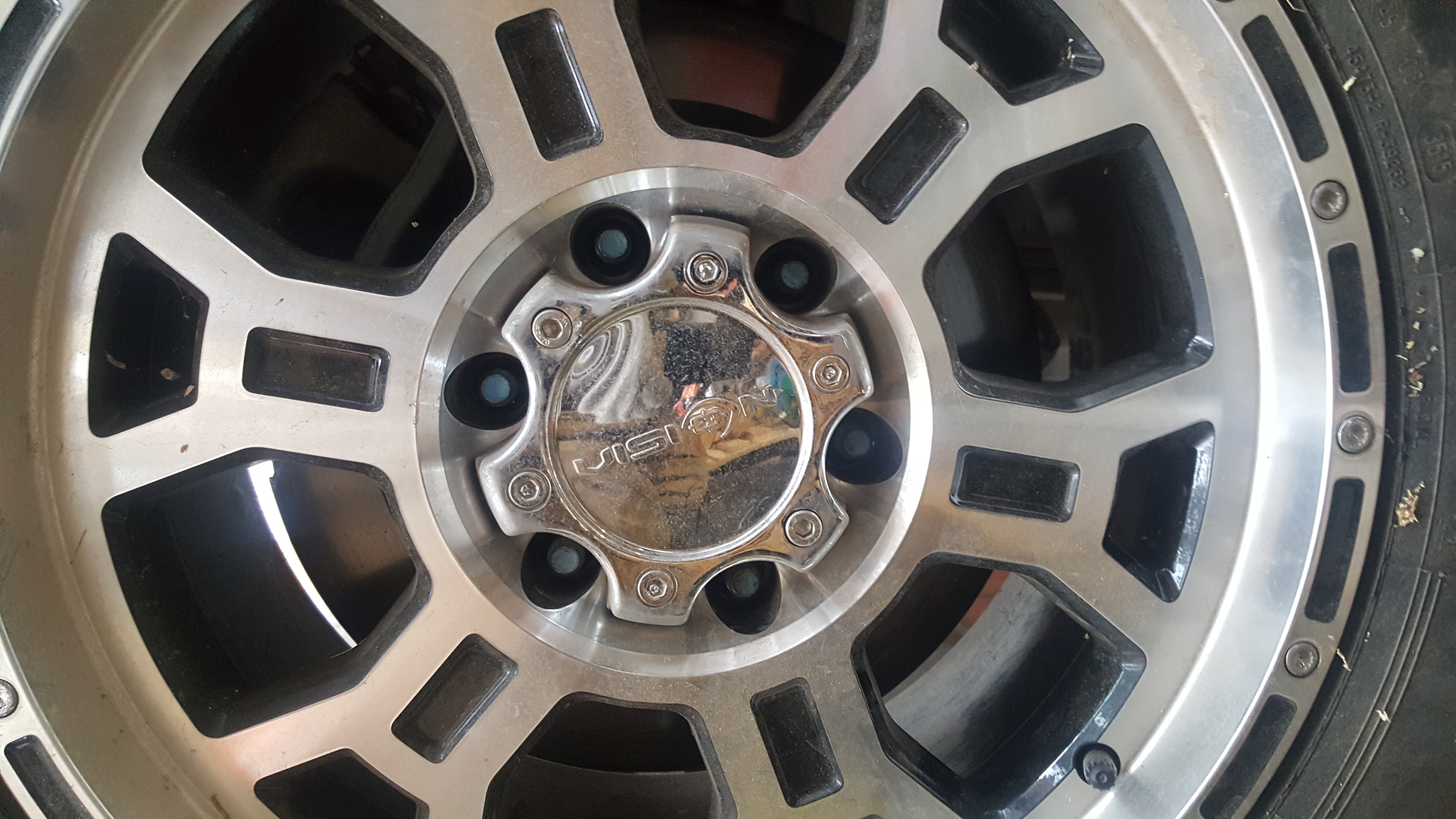

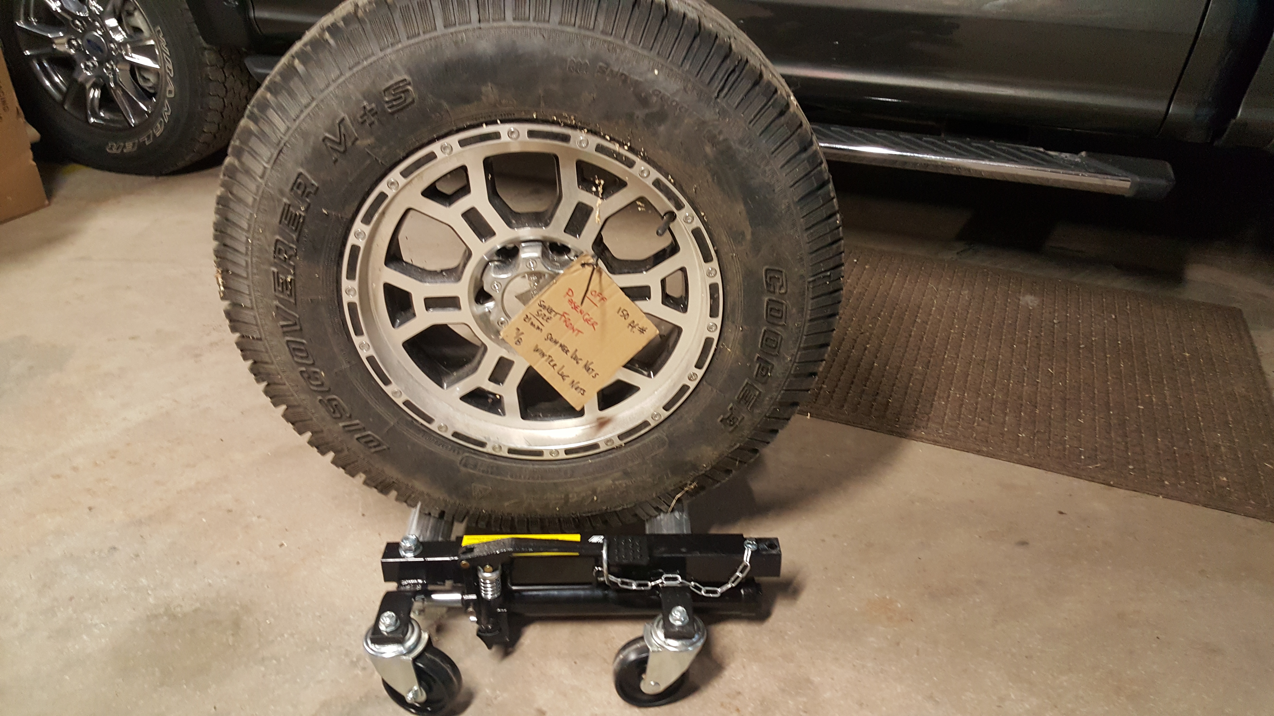

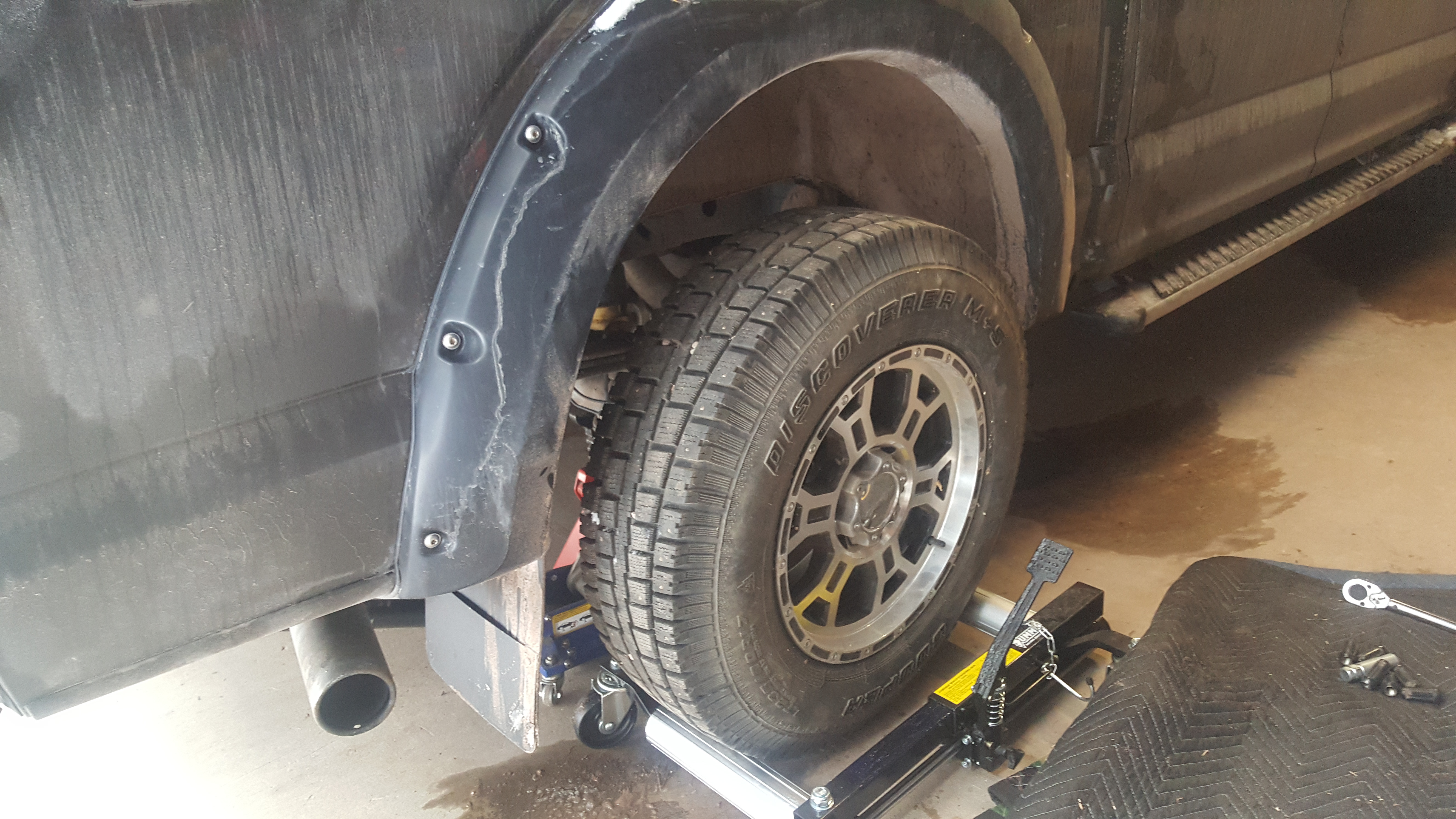

Here's an update:
I swapped out my tires/wheels to my studded snow tires/wheels today.
The vehicle skate tire dolly that I purchased worked great because I did not have to lift the tire to install it on the studs.
My only complaint is I should of purchased this 10 years ago.
Here's a couple of pictures:
