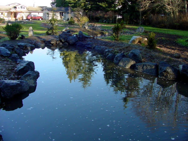

Here is my neighbor's semi finished "Water Feature"

That's a hole! You got your tractor there and built a storage building... I'm impressed!
