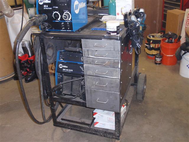

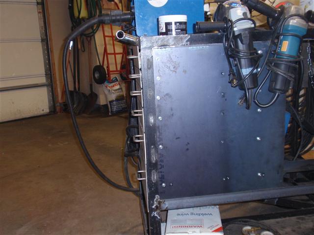

OK, had a little time to get R dun and I have the cart basically wrapped up now, except for paint. I added the drawer fronts and handles and the cart handle on the front. Below are a couple views of it. I angled the handle up 10deg or so as it was going to be tough getting into the top drawer otherwise. Plus it looks nicer, IMHO.
The only thing else I can think I might need is some way to store stick welding rods. I have a tote bin with them right now, but I may try to find a way to add something to the section behind the bank of drawers.
Paint will be a while (probably about 5 years, if history is any guide...)
Much easier to open the drawers now with handles. They are pretty tight in the case so they are stiff to move. I may tack the drawer fronts to the drawers one of these days. I thought about it but didn't bother today. That would prevent them from shifting around at all with banging around.
