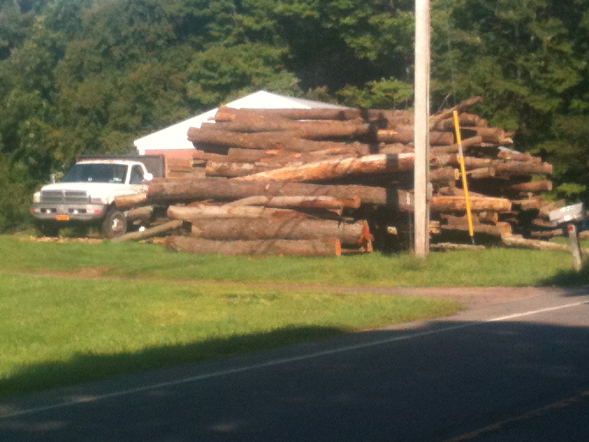

This is one tough piece of steel here. Watching the video yours and mine are made similiar except i don't have a blade. Mine has 2 legs instead. I have never dragged loggs from the lower chain holds, its always from the top roller. Some of my skidds this year were a half mile each way, pulled 500 cord that way so far this year. yea, the logs bang in to the frame but its heavy enough to with stand the use, paint is bummed up but, its only paint, i buy equipment to use, not to look good and no my tractors dont get waxed either :laughing: This year i am using the winch on my Kiot iDK 35SE for the simple reason it has a better seat , easier on my body.
First picture is a part of what i have dragged out this summer, the others are of my winch. . . . .This is how iv'e done it for years . . .John

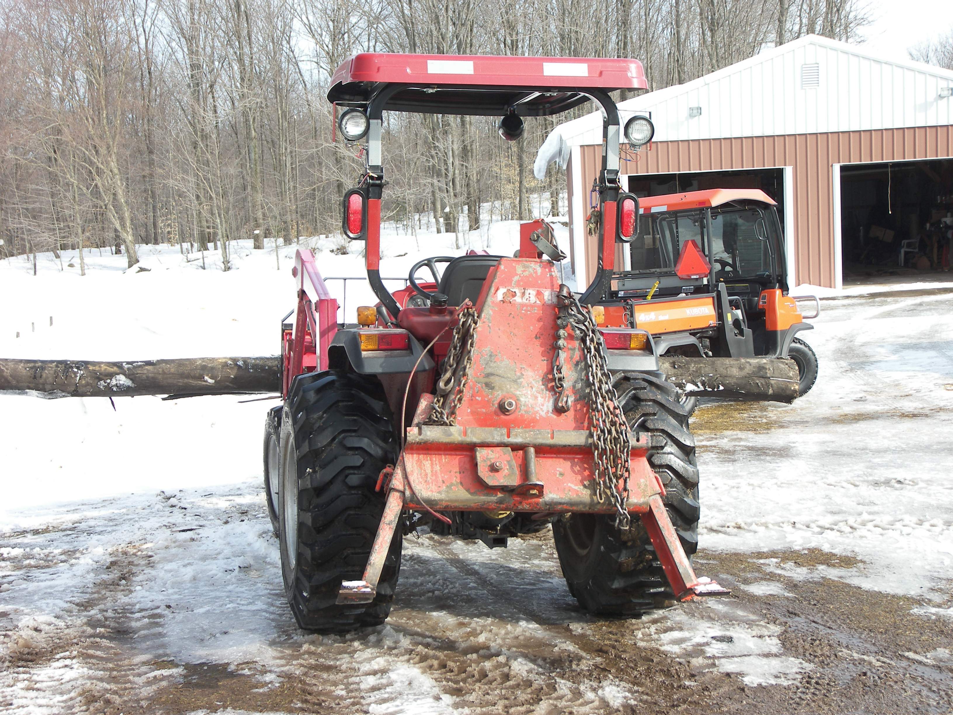

Why you pulling from the bottom pulley, I didn't buy that when I got my winch, I had a thin steel plate where the pulley attachment would go, I took that off, copied it to a thicker piece of steel and put that on. I always winch to the top pulley, and if I have to go around a corner that might tipper the tractor over, I lower the winch down till it almost hits the ground. I haul out big logs and they bang into the upper plate, I mean BANG!, nothing broke yet, and I get my 10 cord of firewood out during the winter when there's snow on the ground so the wood will stay a lot cleaner, and haul a lot faster.

I have not done any upper skid plate modifications yet. My b7800 3ph lift is not that great for lifting the weight and all the weight of the logs up, so I did not want to add more weight to the winch by welding a plate on. I have been considering a much larger tractor, with more 3 ph lift, in hopes of 2 things. One, for the bigger tractor to be able to lift the winch and hitch higher then my b7800 can and two, if that still is not enough, the bigger tractor 3ph rating can lift any modification I weld back there along with more logs then my b7800 can.
My main concern with not having extra protection on the winch is the logs banging WILL bend or dent something that will ruin the winch. Its onlt 3/16 thick on the winch up there. Also, the upper part of my winch isnt very wide and on sharp switchbacks, the logs come out from behind the winch and bang into the side of the winch.
Hopefully if I get a larger tractor, it will just lift the winch and hitch higher the way the winch was orginally designed, but somehow I doubt it will be that easy.
