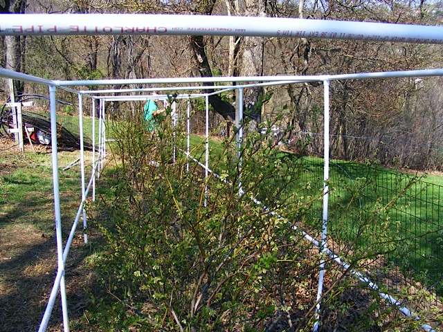

Here's what our blueberry "cage" looked like in progress. My wife got tired of the birds cleaning us out and our first attempt, which you can see the remains of in the upper left, failed during a heavy snow. This framing is made from 3/4" PVC pipe and fittings and then covered with 5' high chicken wire on the sides and top. the wire is held on by plastic zip ties. We had 0 losses this past season. The upright pipe is slipped over metal stakes purchased from Home Depot which are usually used for concrete frame supports, I think.

We tried the bird netting and the very heavy gauge deer netting. It kept the birds out until the rabbits and chipmunks chewed holes in the net. Then we had birds that managed to find their way in but couldn't find their way out. That's why my dear wife said "enough" and had me make a new cage with the chicken wire.
Taking the bird/deer netting down each winter would have prevented the collapse of our original try. I used those same spikes mentioned in my earlier post on each side and slipped 1" plastic pipe used for wells over both to form an arch. I then used some 1/2" PVC to connect the 10 arches together at the top. The idea had merit, but a very heavy wet snow stuck to the netting and the weight bent everything down on top of the blueberries. I think that happened in the 3rd winter it was up, so it lasted pretty good. I'm hoping that the new PVC frame and chicken wire will withstand a similar snow storm.

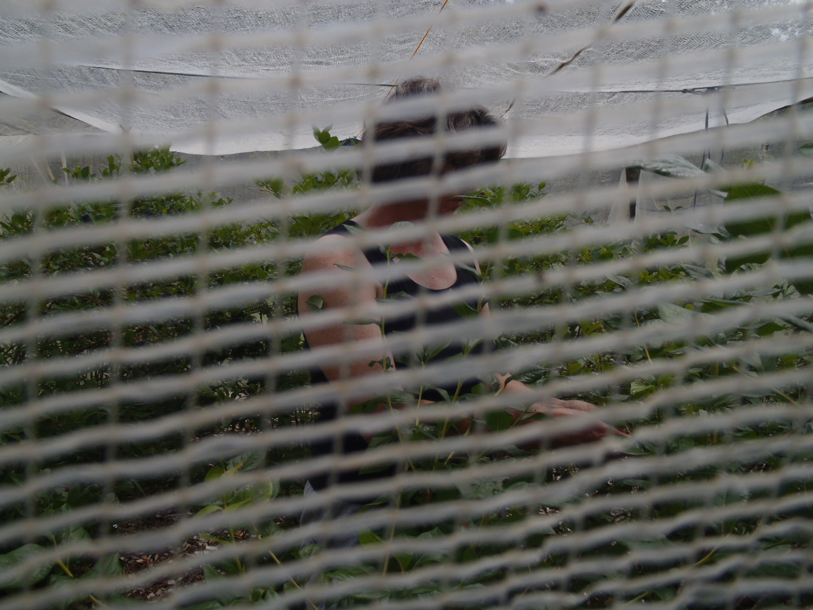

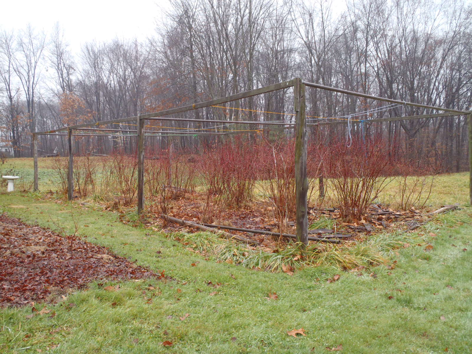

We have 18 "tall bush" blue berry bushes, planted 3 x 6 by the previous owner. They are surrounded by 8 cedar posts and spanned across the top with sections of 2" galvanized pipe and 2x2's. The birds used to clean us out before we'd get more than a taste. The The Plant Manager got a tip while talking to the local ag extension gal that a local tobacco farmer had left some used tobacco netting in a free pile at the end of his farm drive. The Plant Manager crammed her Ford Focus so full of netting that she could barely get into the car. Now we get lots of berries - enough for a few pies, waffles, pancakes and a dozen pints of bb jam. The posts have just about rotted out as the area is very wet 90% of the time. I plan to replace the posts with more of the same and replace the cross pieces with pvc or conduit this Summer. I'll see if I can find some pictures for reference.

As threatened, I dug up some pictures.
Here's The Plant Manager in the berry patch with the tobacco netting up:
And the patch with the netting removed:
