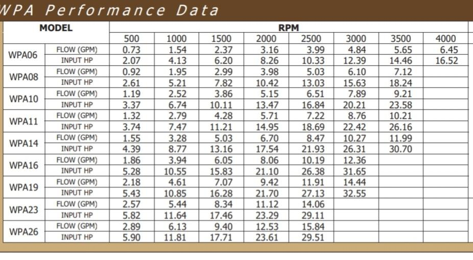

That tractor's hydraulics system has 13.7 Gallons/Minute flow.I couldn't find the pressure and flow specs specifically for that backhoe however. It will take a WPA23 pump at 2400 rpm to create that kind of flow and pressure. You are going to need about 28 horsepower to do that. The hydraulic tank would have to be sized accordingly also. This backhoe may require less flow then that however. Find the hydraulics requirements for the Backhoe and look it up in the attached chart to determine horsepower needed.
You are giving up the mass in the tractor that helps the backhoe be more effective at digging by disconnecting it. My experience with backhoes is the heavier the better.

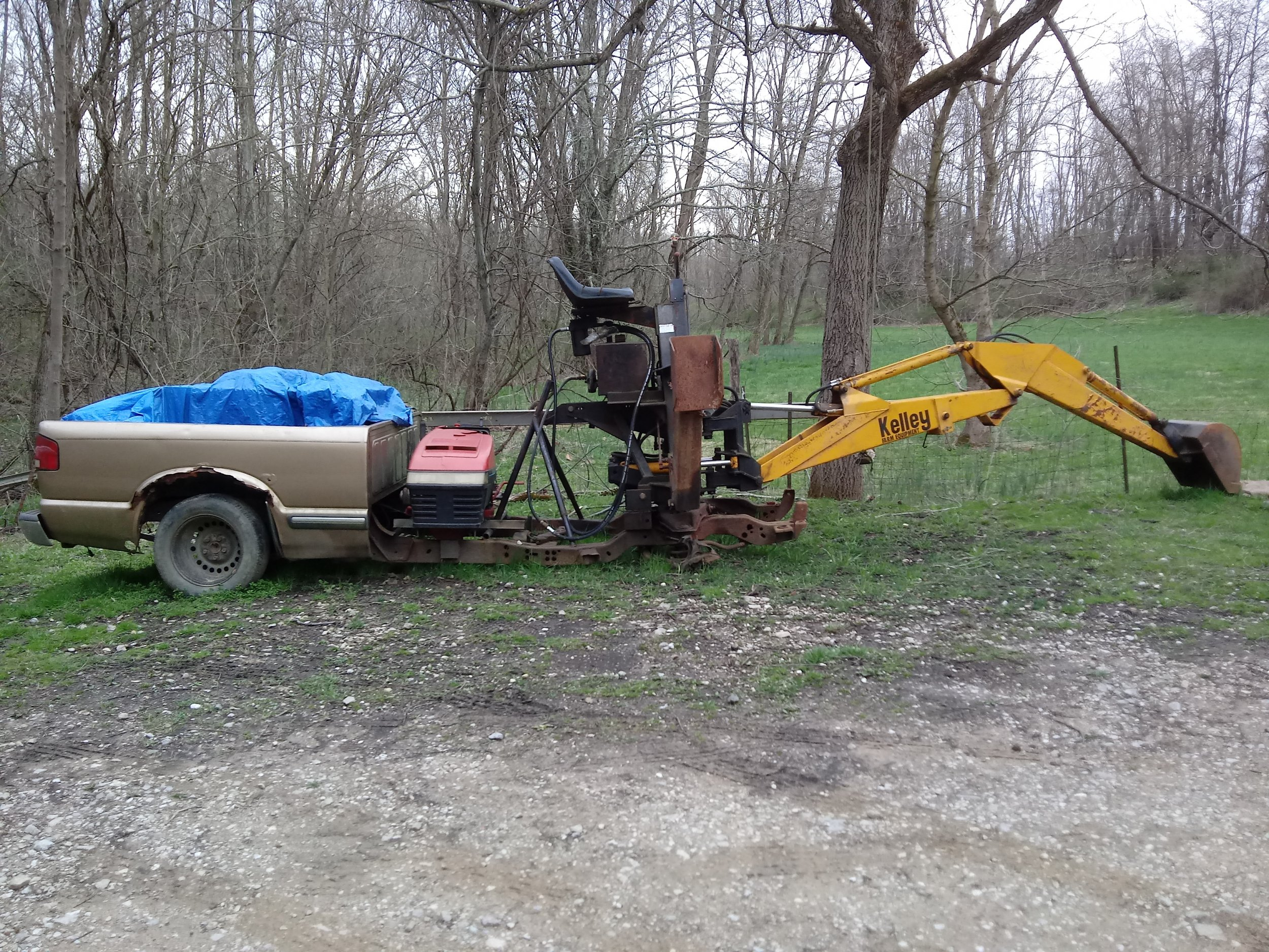

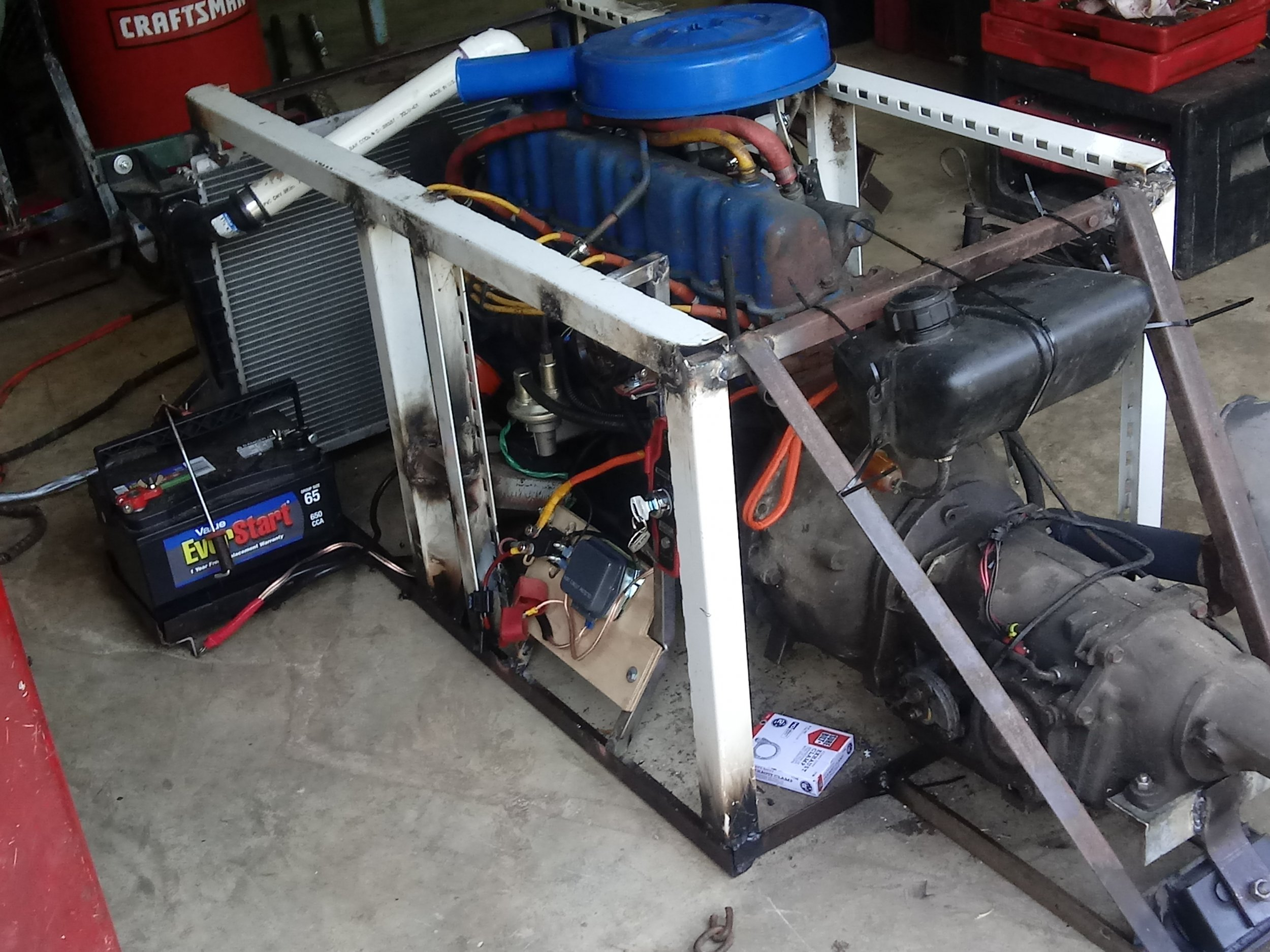

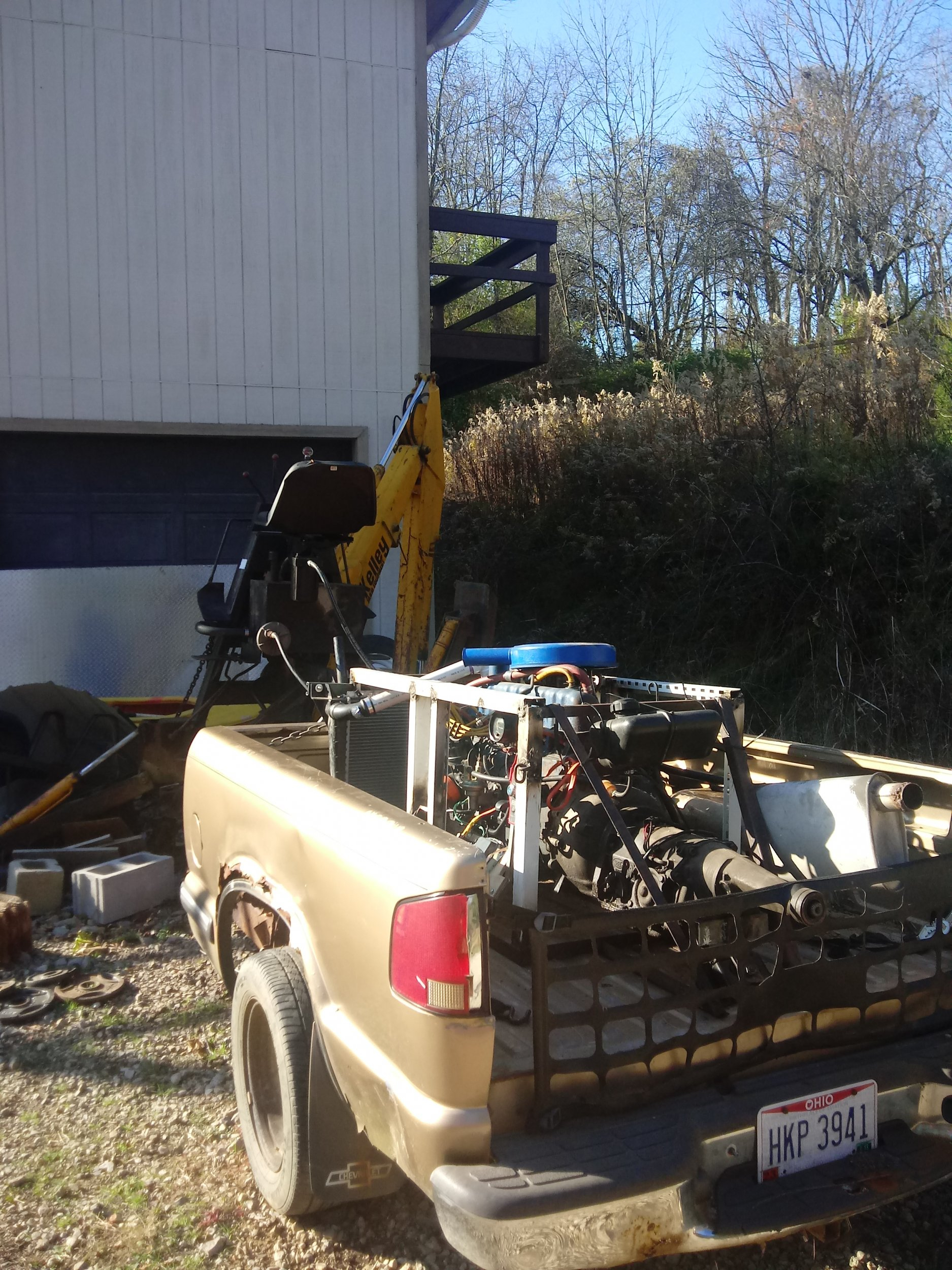

Man don’t do it! I say this from experience. I know what you’re thinking. “It will be great, I can just crawl myself around and dig whatever I want. But you won’t like it. It will be slow and cumbersome to say the least, maybe a little dangerous. You will need the tractor to get it loaded and unloaded. To get it stored, to get from work area to work area, plus the weight and stability of the tractor are very much needed. Then there are in all the engenering difficulties that will have to be solved or not. But they will affect the satisfaction of use. Power is a problem. I went from a 24 hp v twin (that didn’t work well at all) to a 1964 Ford 200 straight six. (Worked well but was a gas hog). I never dug on one project with it. I spent all my time working out the” Kinks “. I finally got the whole thing running really well and sold it to buy what you have sitting on the ground in your picture. I love my 3 pt backhoe– sub frame attached to my tractor. I finished 3 digging projects, already! My humble advice is to use your effort to go dig rather than building something to go dig.

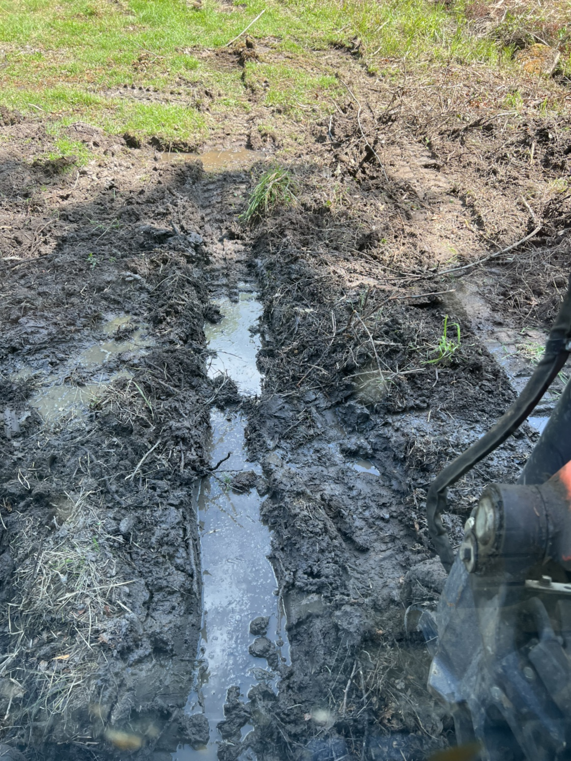

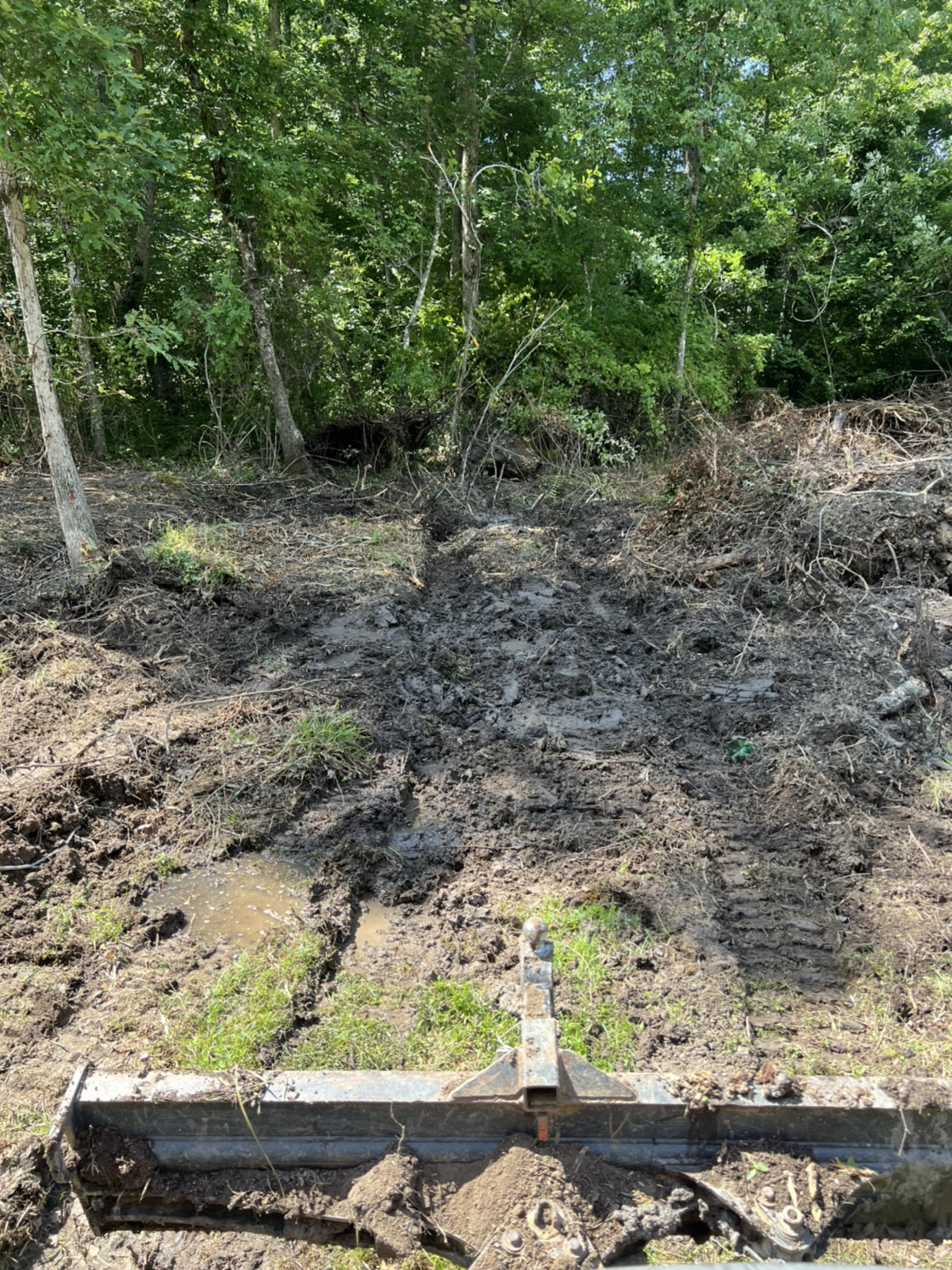

   / Thinking of making my backhoe attachment towable and usable OFF the tractor! #39
Here’s a soft area I was working with my 10k pound mini x. There’s no way my tractor that doesn’t even weigh half as much could drive there without getting stuck.
#40
Thanks for the pics that’s really helpful! This is awesome. So u go pretty confidently in that stuff? Maybe i will rent a mini x and see how it fares
