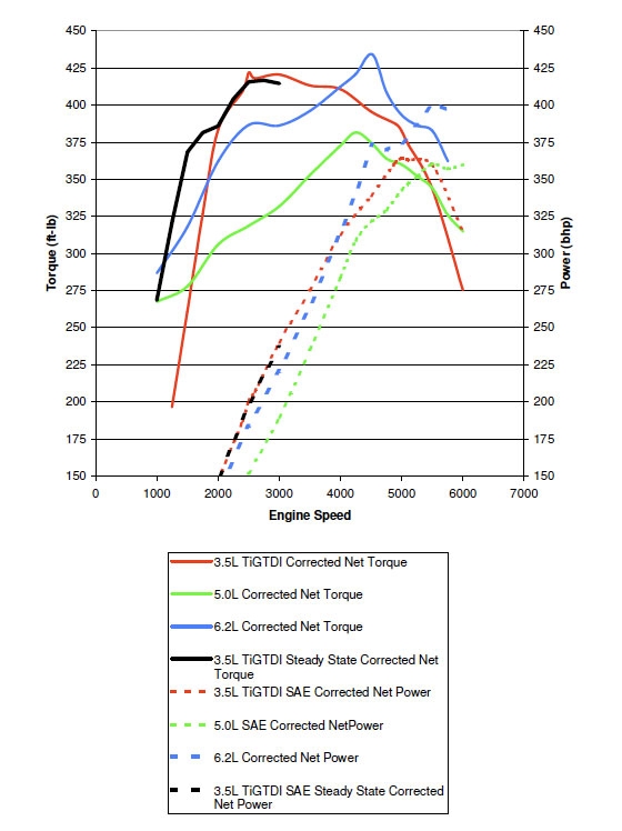

With your race car experience you should realize that it is not about peak power but the area under the torque and hp curves, which is referred to "total power". Just so you don't think I am going to quote "marketing material", attached is a dyno showing the differences from pickuptrucks.com. The marketing material shows 90% of the peak torque being available between 1700-5000 rpms. That chart looks close to those values.
How We Dyno Tested Ford's 3.5-liter EcoBoost V-6 and 5.0-liter V-8 Engines - PickupTrucks.com News

I experienced just the opposite. The EB doesn't even get spooled up until 2nd gear. In fact, the EB should be compared to the 6.2 liter rather than the 5.0.

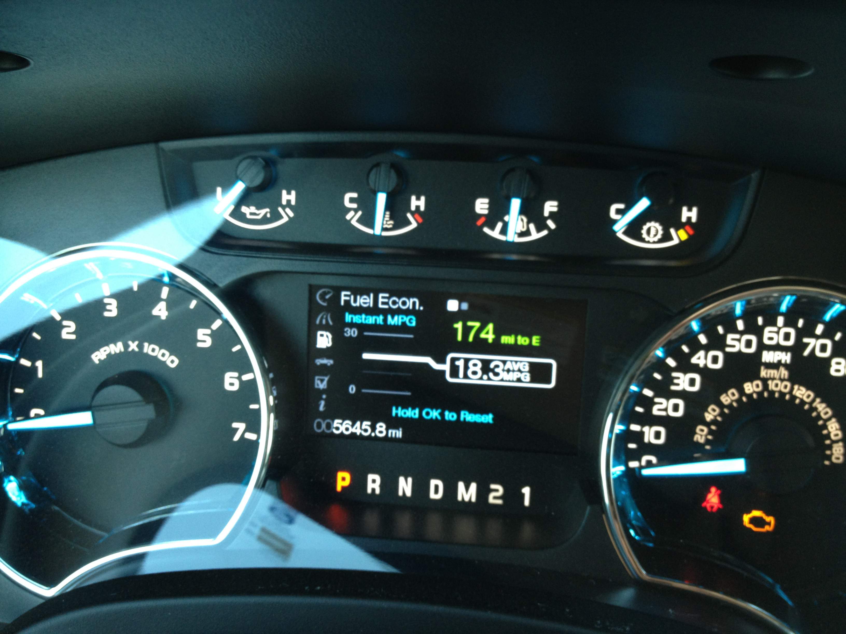

Facts are facts agreed. There are no facts that the ecoboost will require any more maintenance cost just because it has a couple turbos. The most reliable car I have ever owned was a Mazda 2.2 liter turbo I drove in my single, childless, years. I put 165000 hard miles, 7 sets of tires, and 6 speeding tickets on that car before I sold it. That car used no oil in 3500 mile intervals and I never replaced any engine component. Facts will be available in about 5 years so obviously my fingers are crossed. Lets not speculate just yet. I justify my $700 upgrade every day I get behind the wheel and it brings a smile to my face.
Attached is a picture of my current 1/2 tank of gas in mixed driving.
