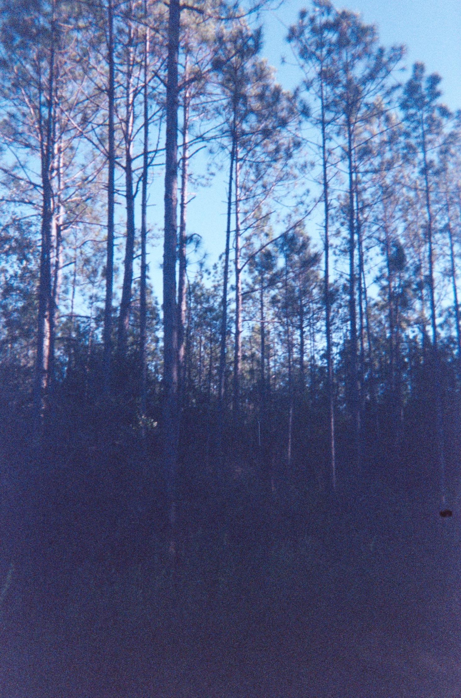

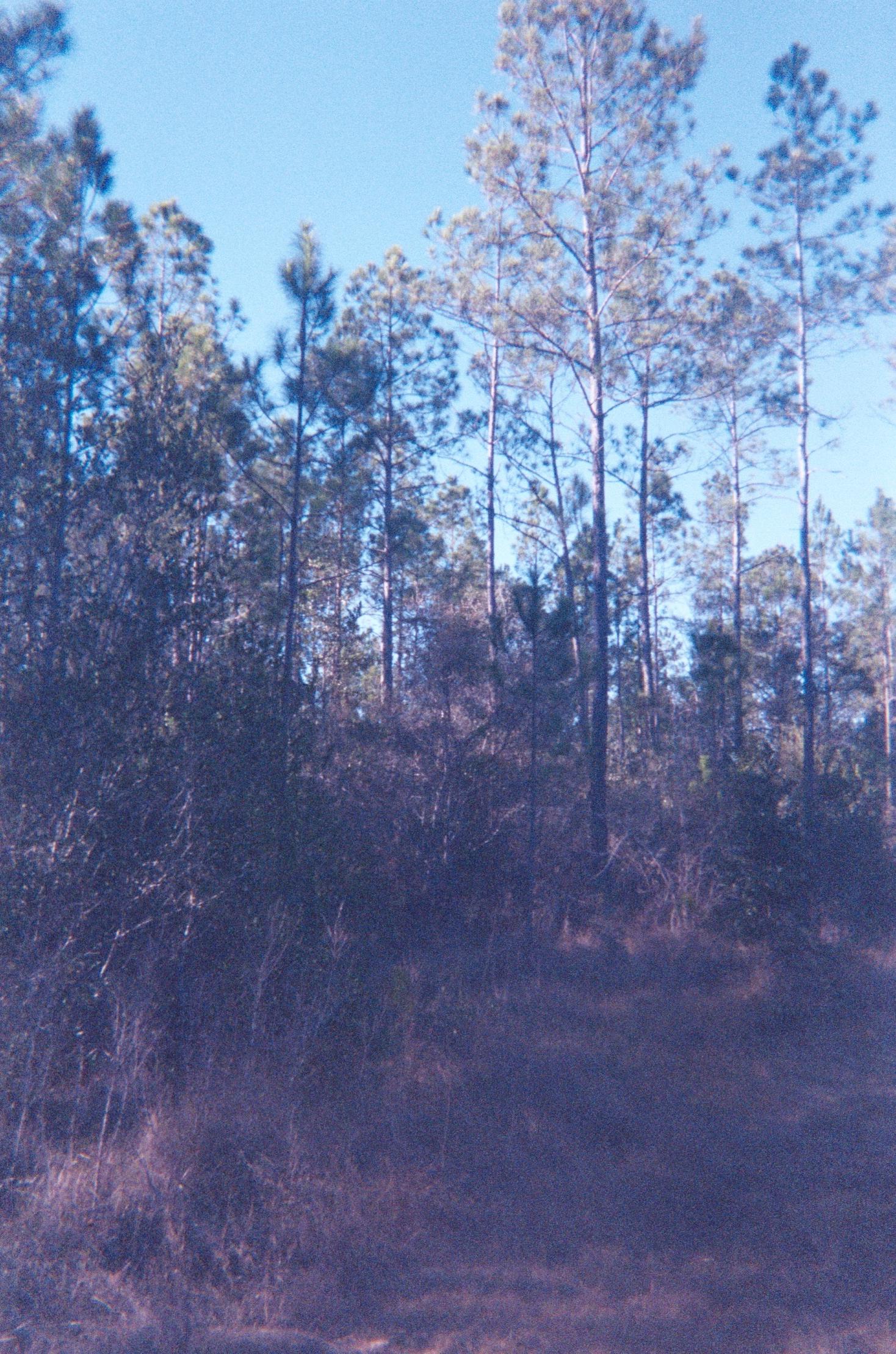

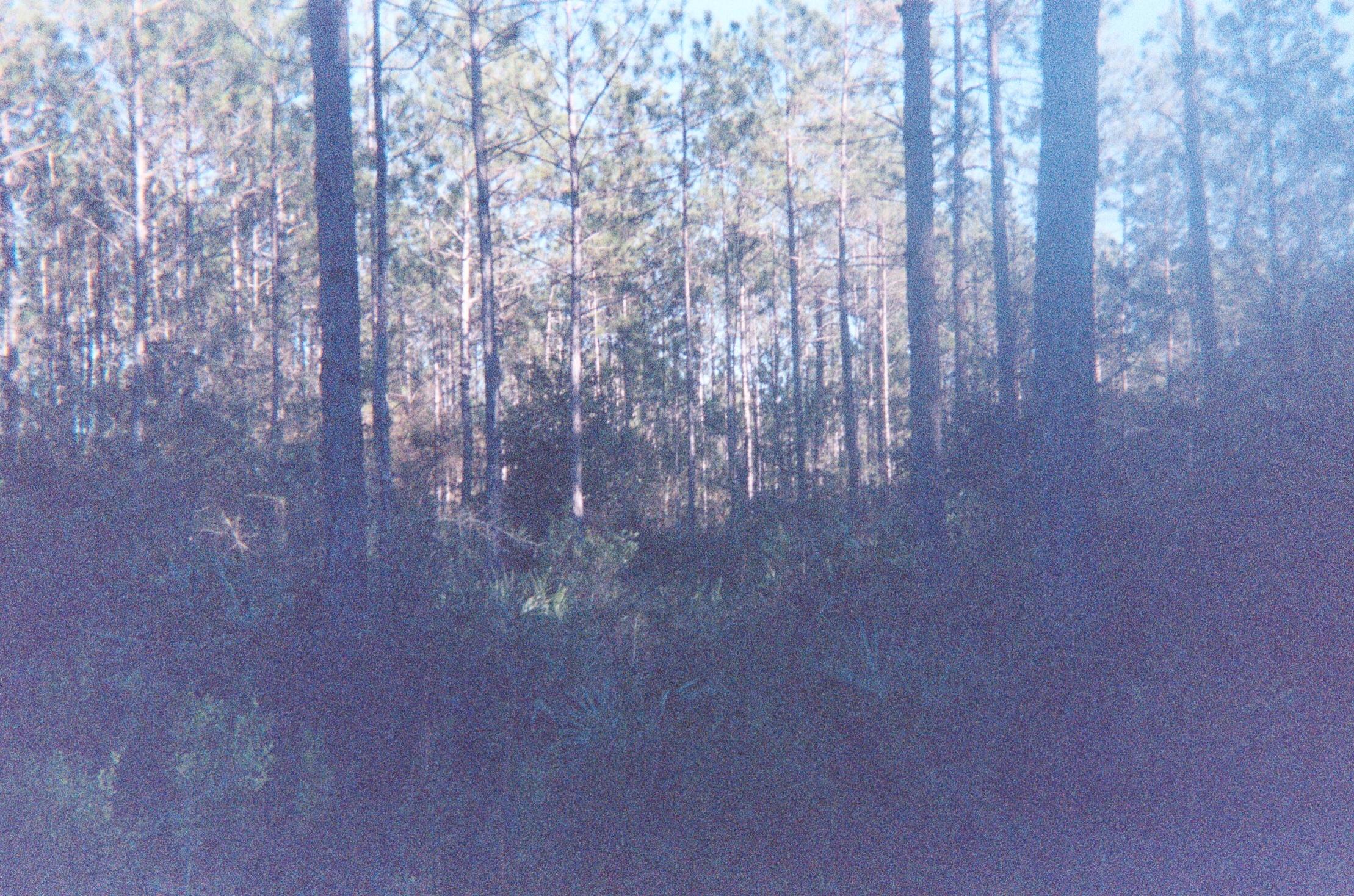

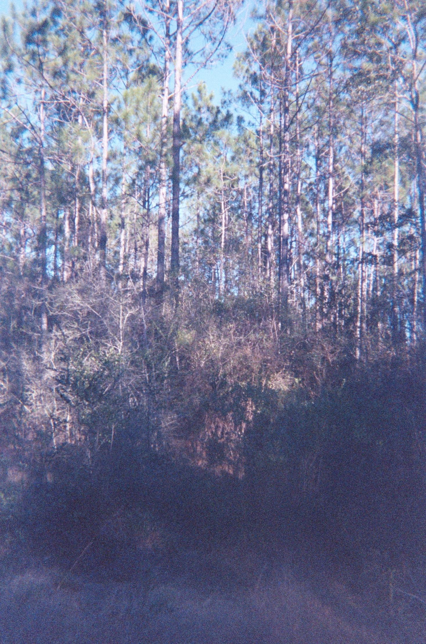

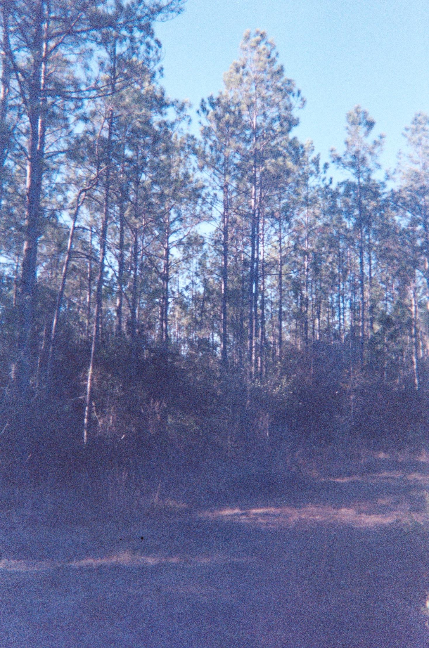

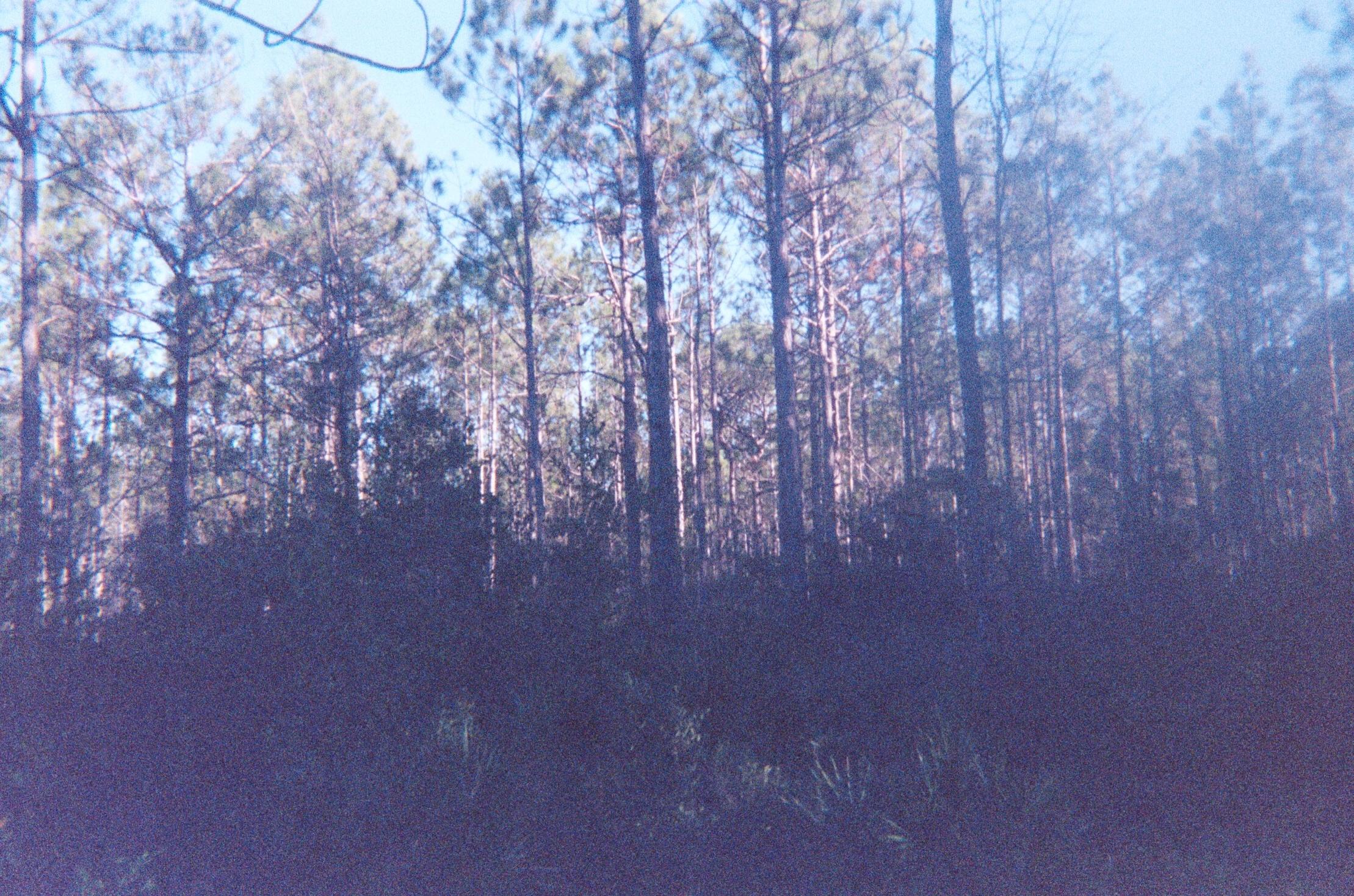

* I would like to harvest the pine trees and make a little money off of them in the process...

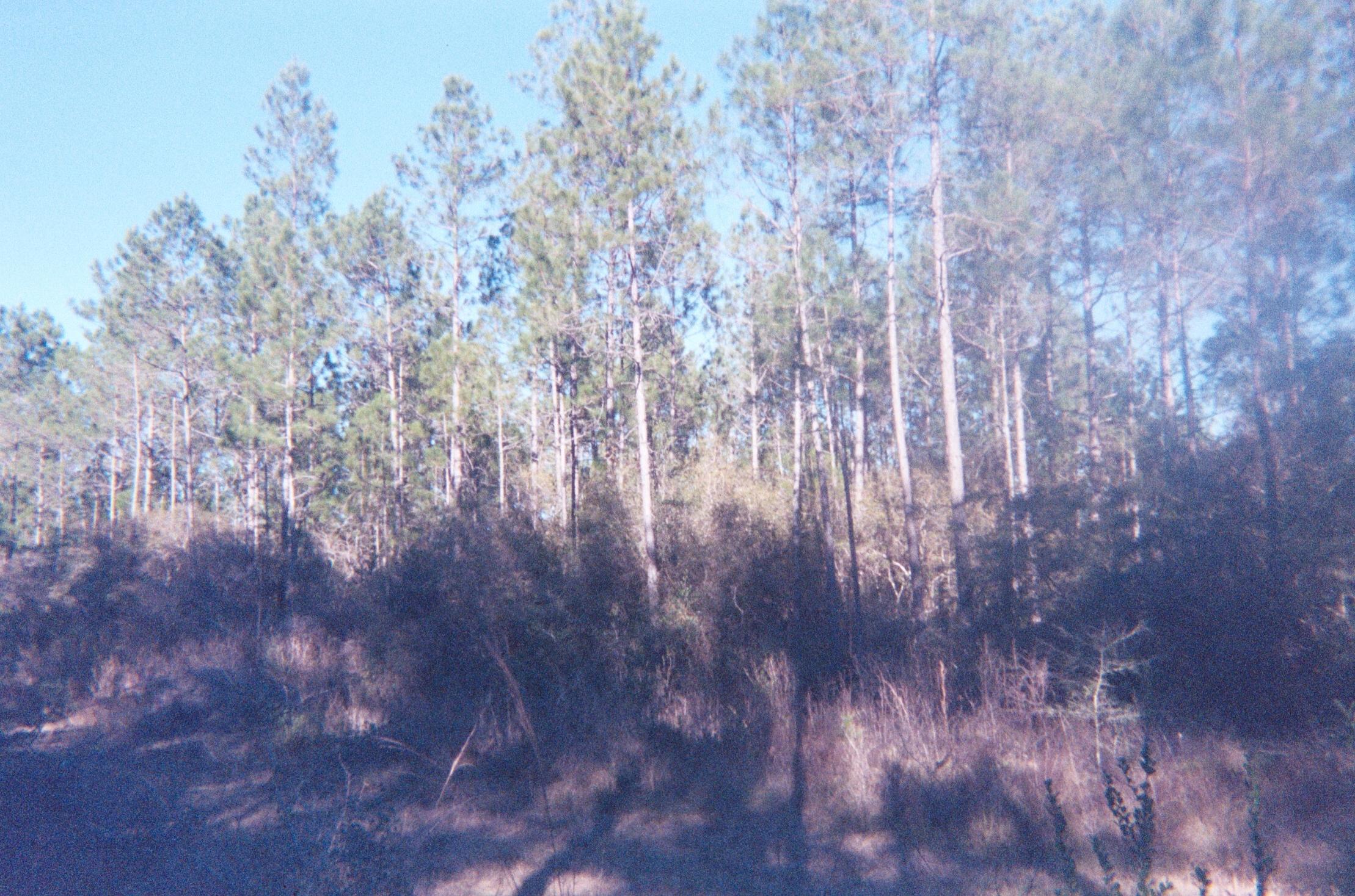

Do you have other pine trees? from the photos, I don't see anything that's worth :2cents: maybe in 15-20 years. What's the diameter of the trees... you can call a forester in to see if there's enough to harvest.
I agree, they are very small in this part of the property. I will have to call a forester to tell if they can use them for pulp wood. They are mostly too small for anything else.

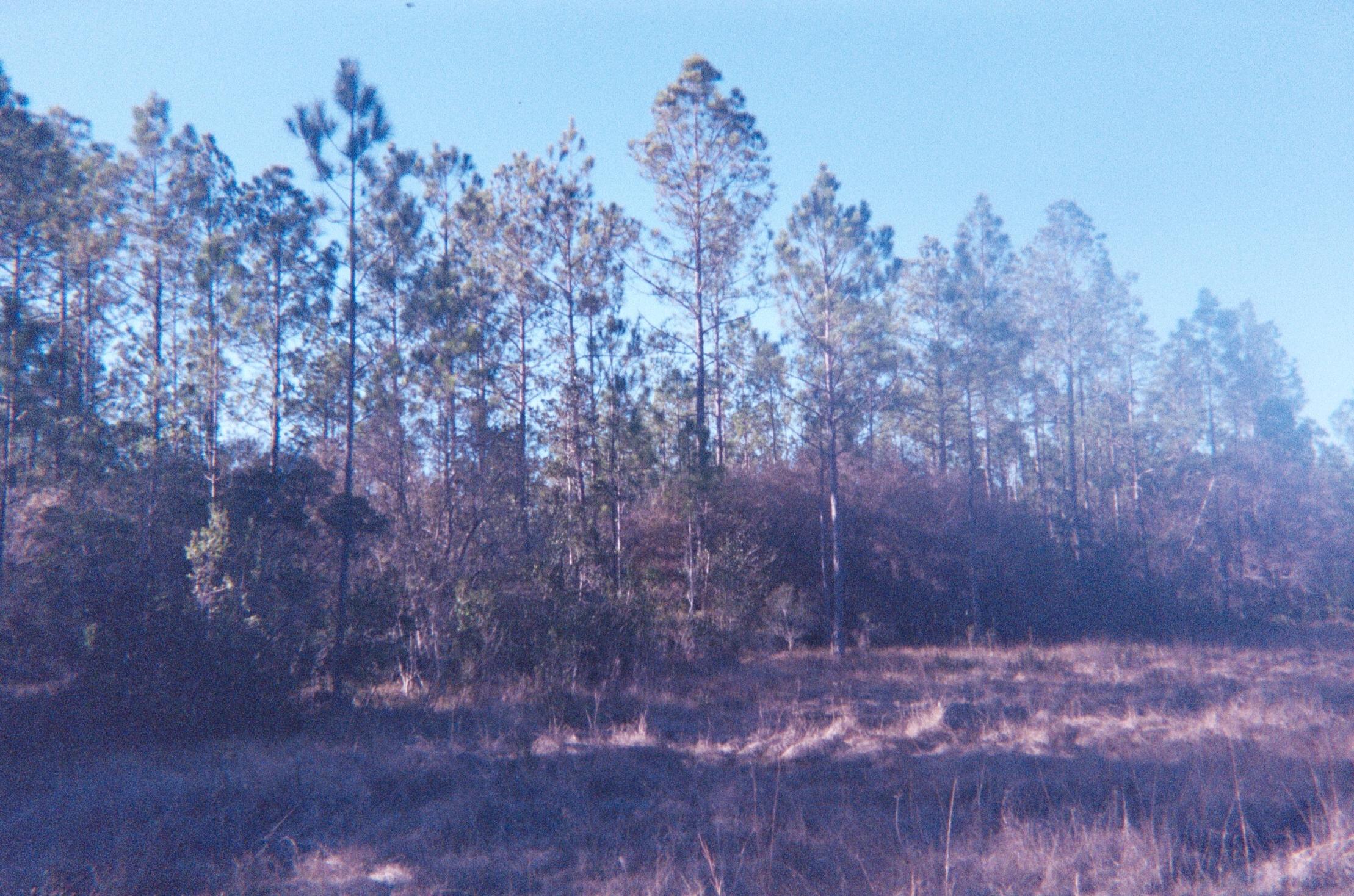

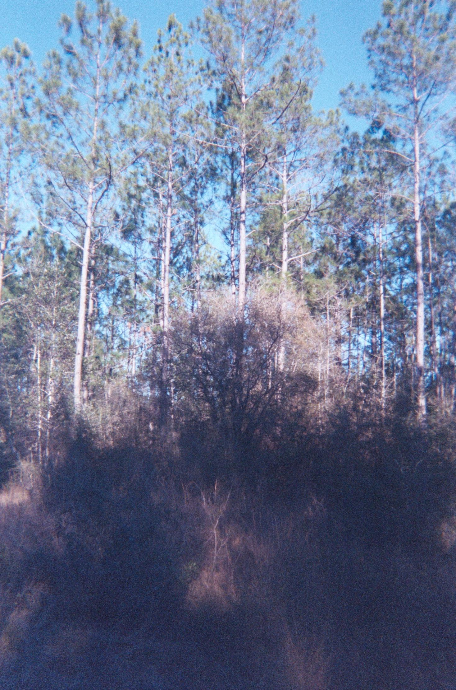

Those trees aren't worth much, if anything at all. Maybe pulp, there's no lumber in them.

[Those trees aren't worth much, if anything at all/QUOTE]
Might be surprised at what some mills will accept for lumber.:D

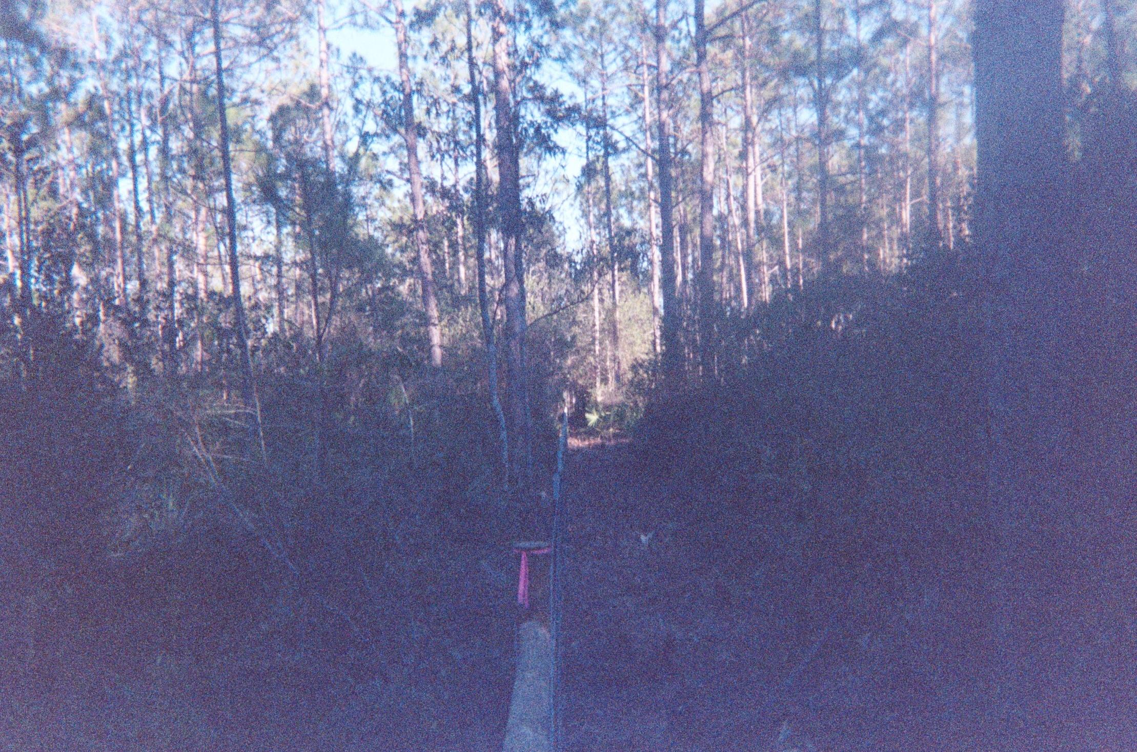

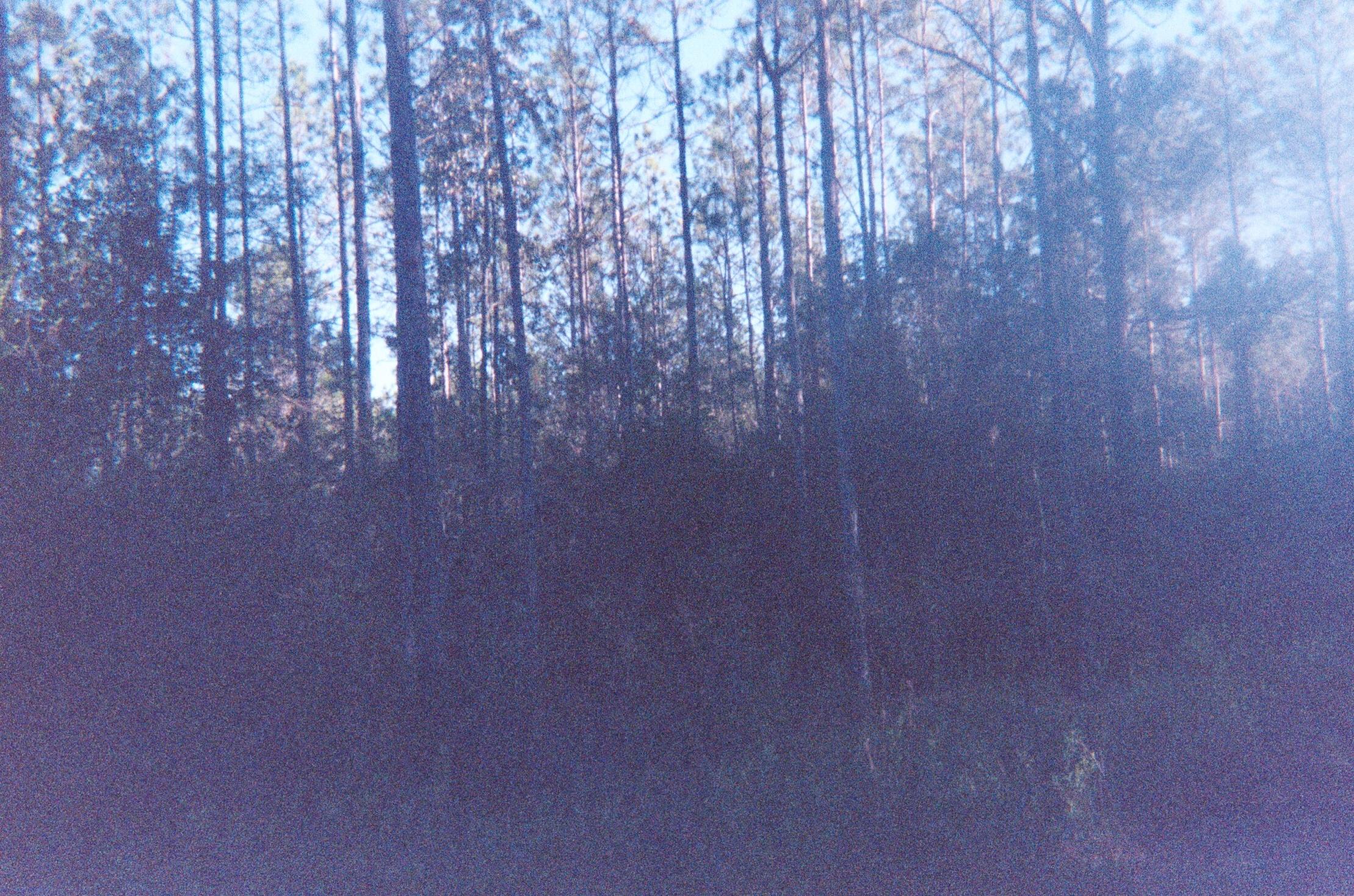

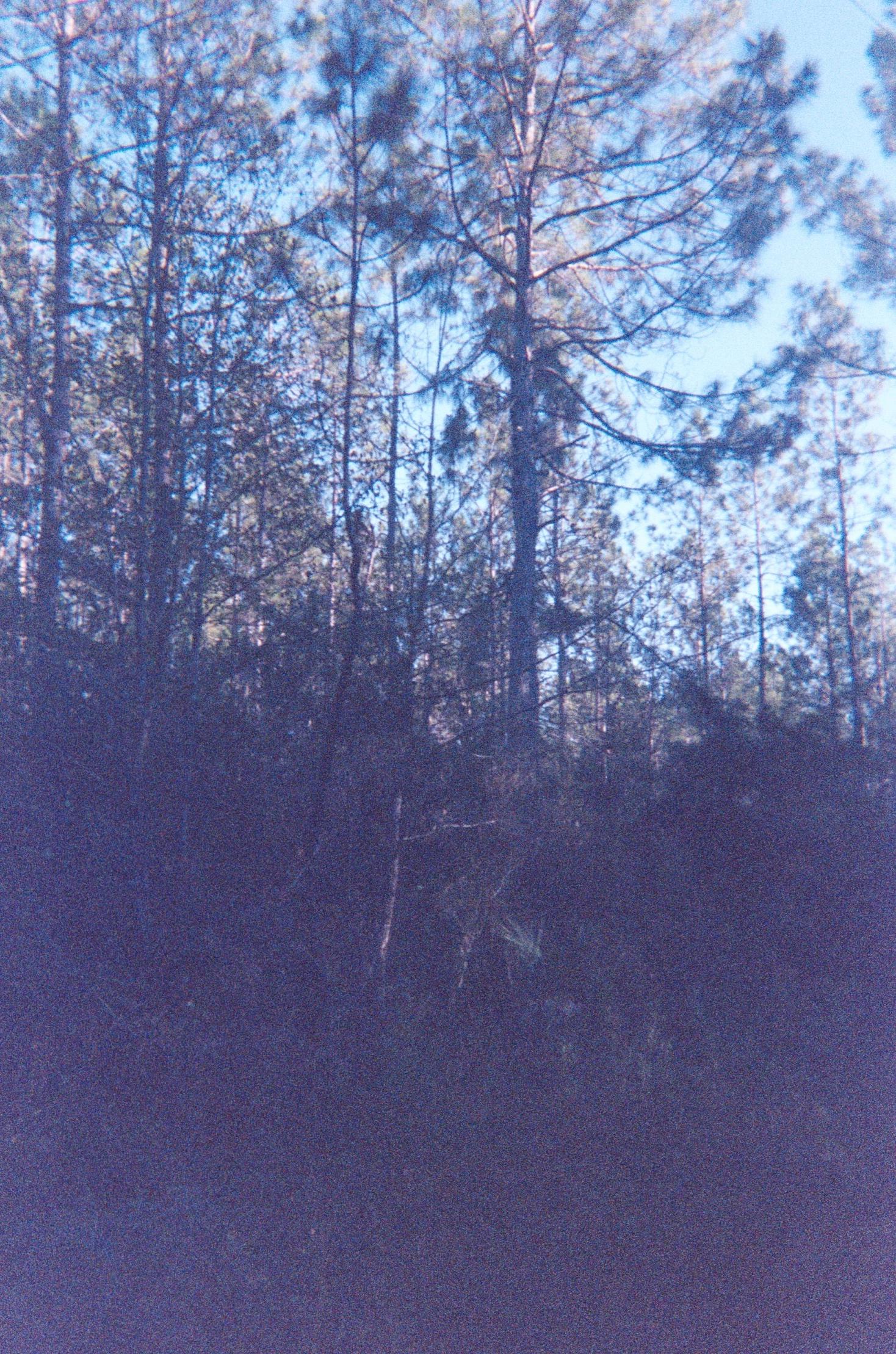

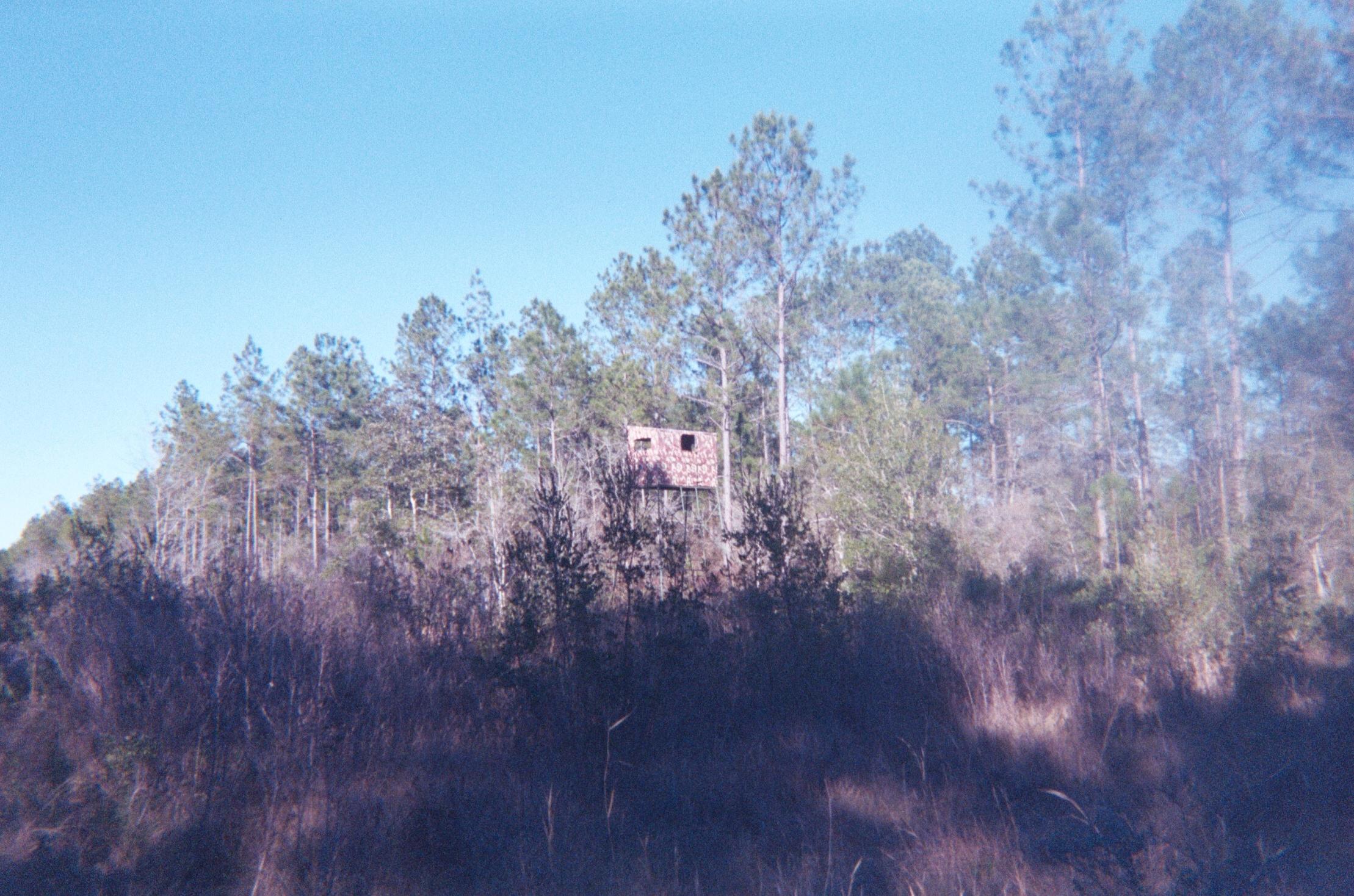

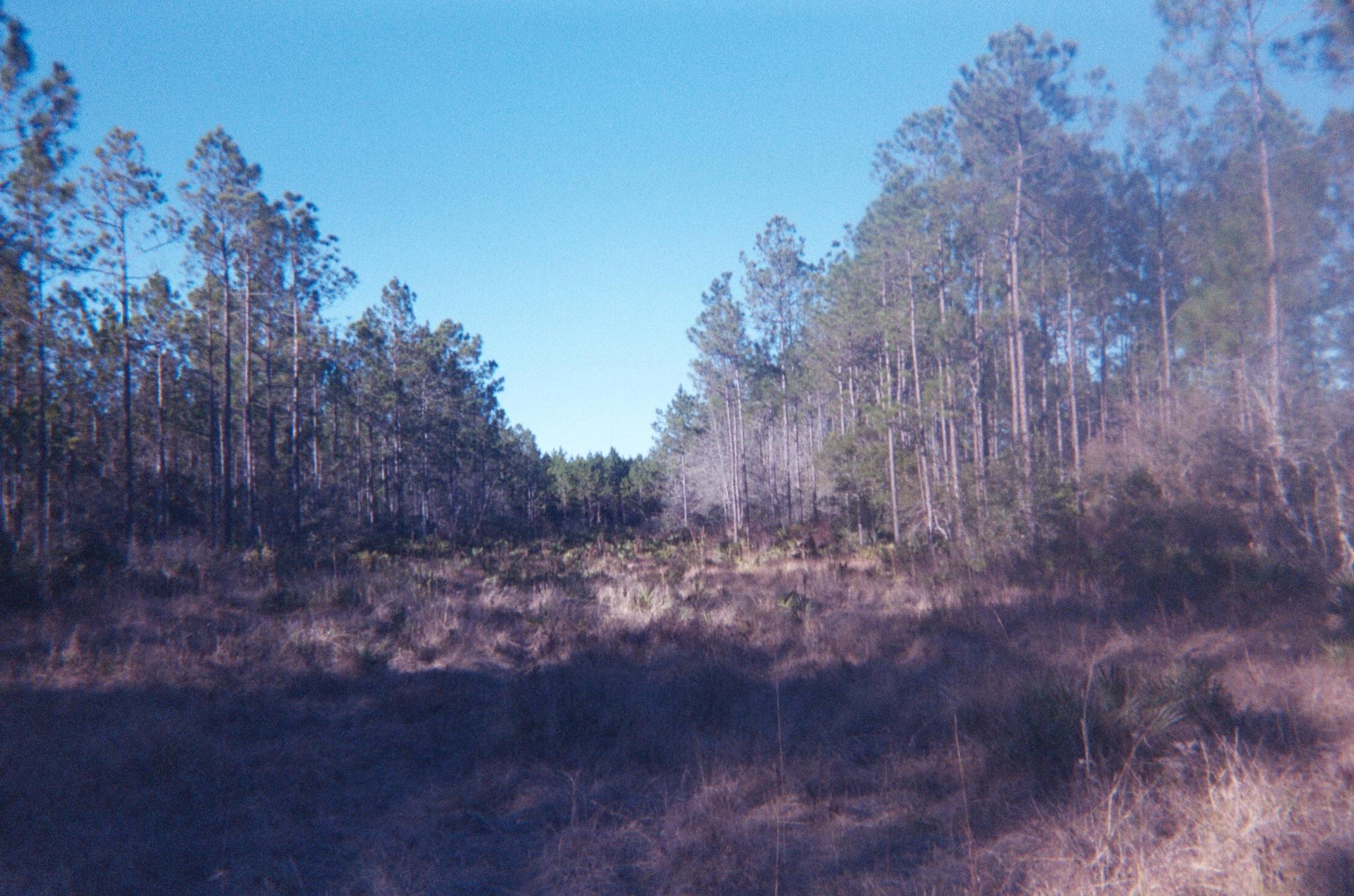

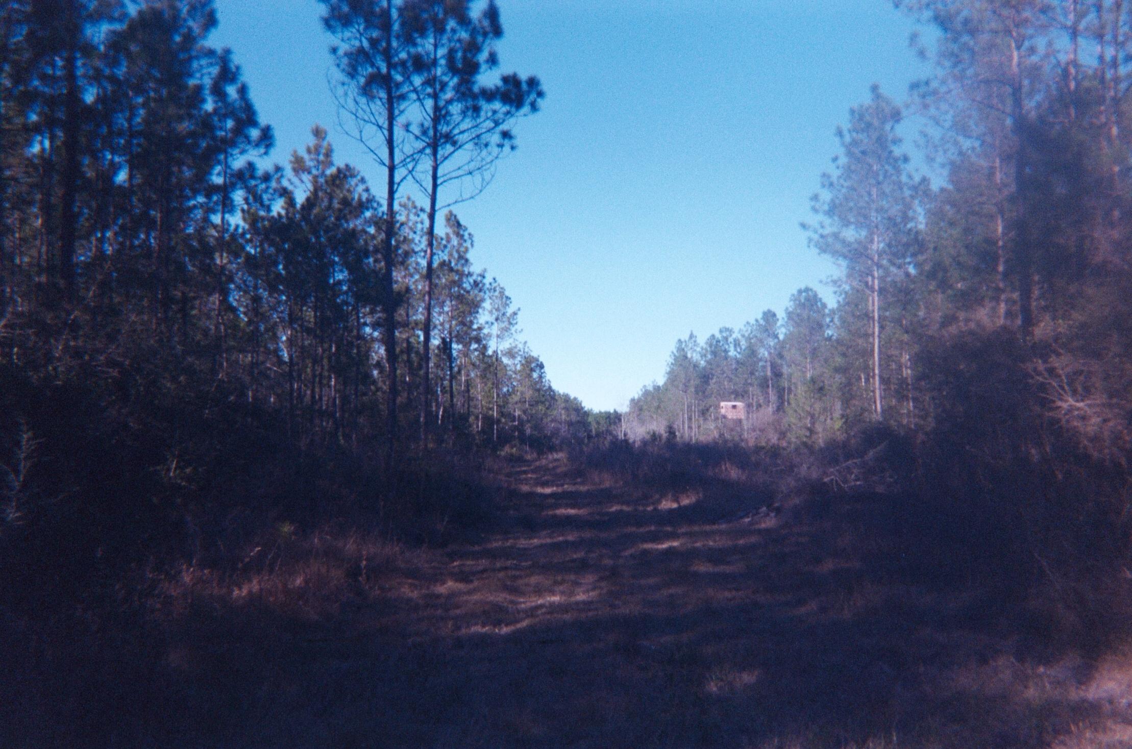

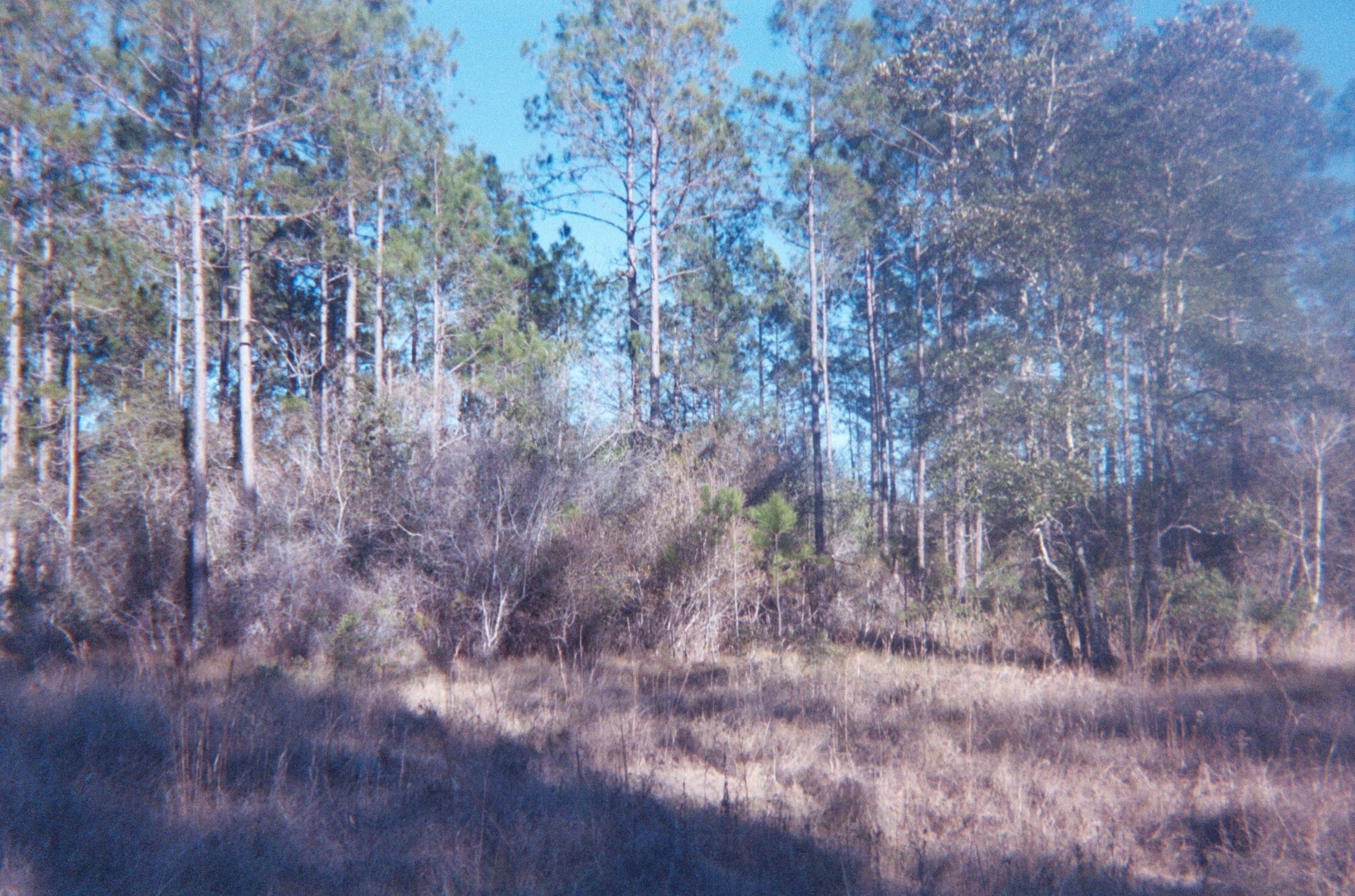

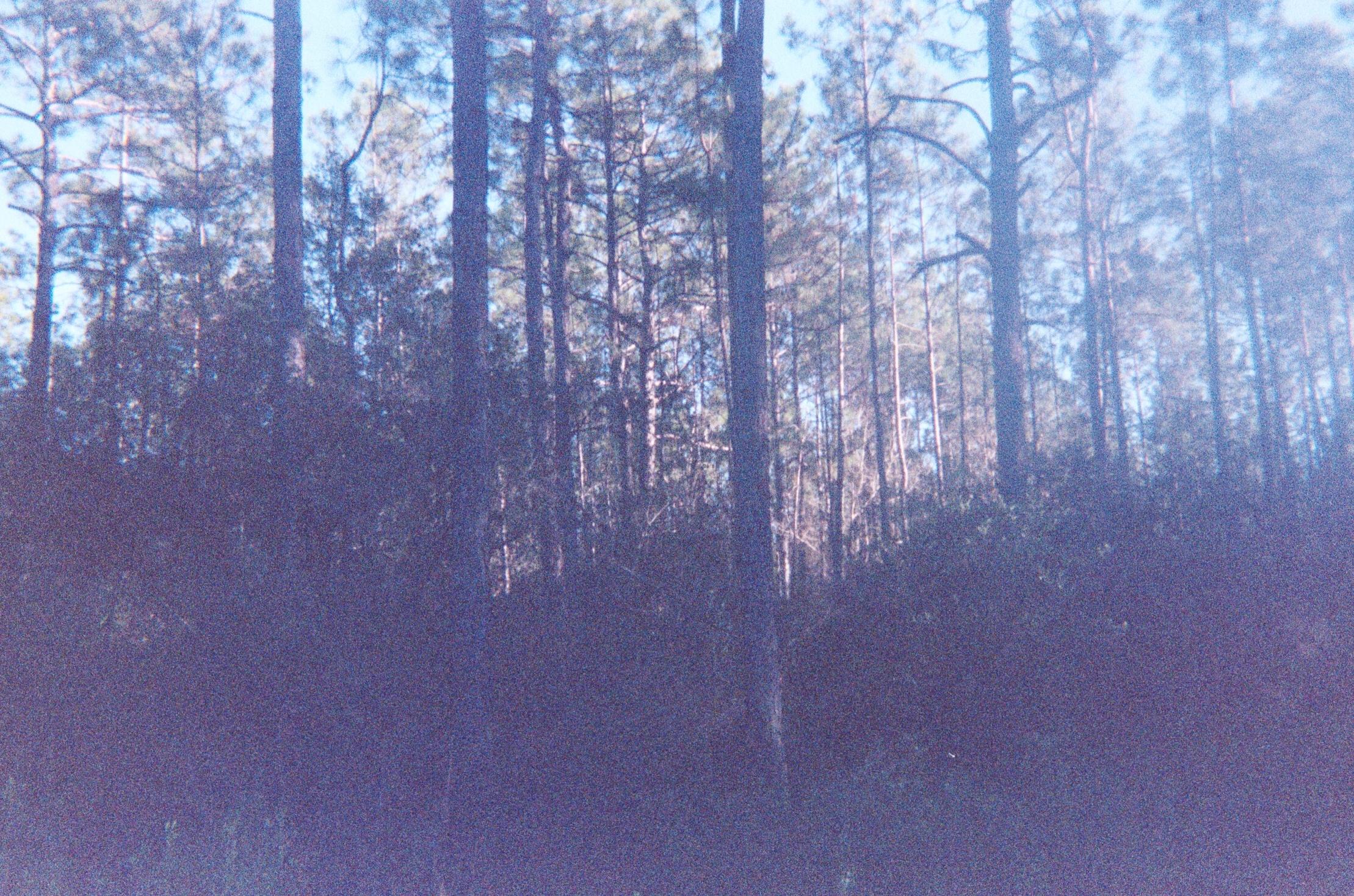

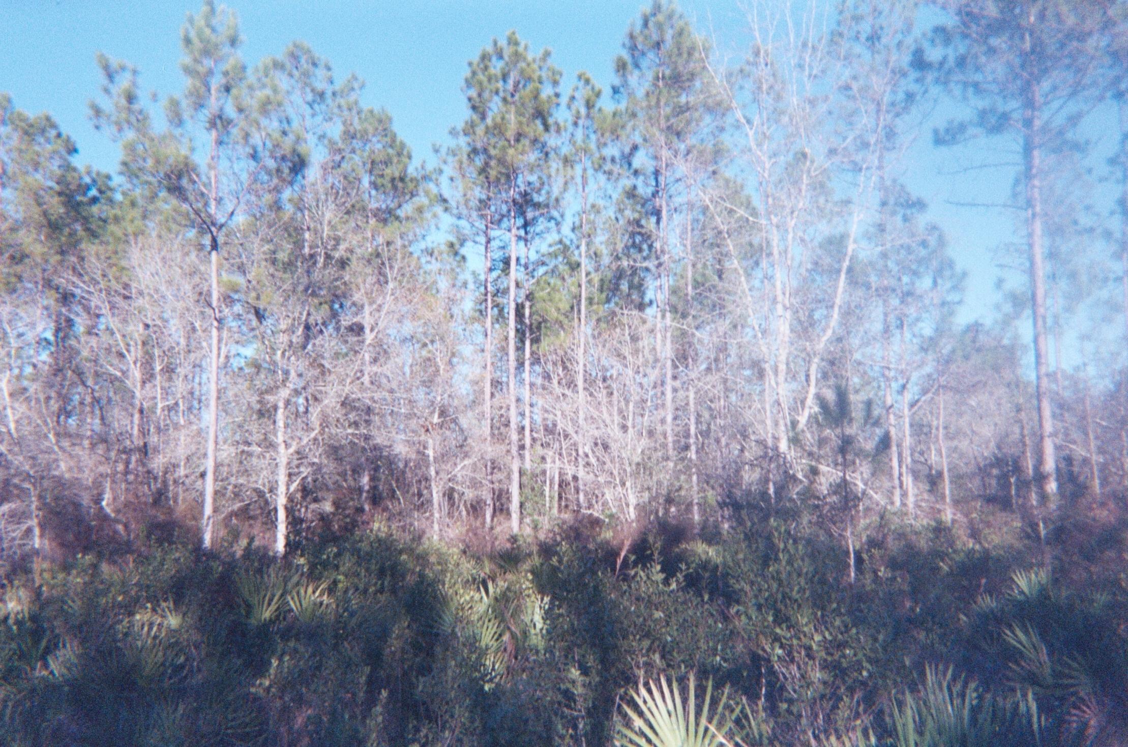

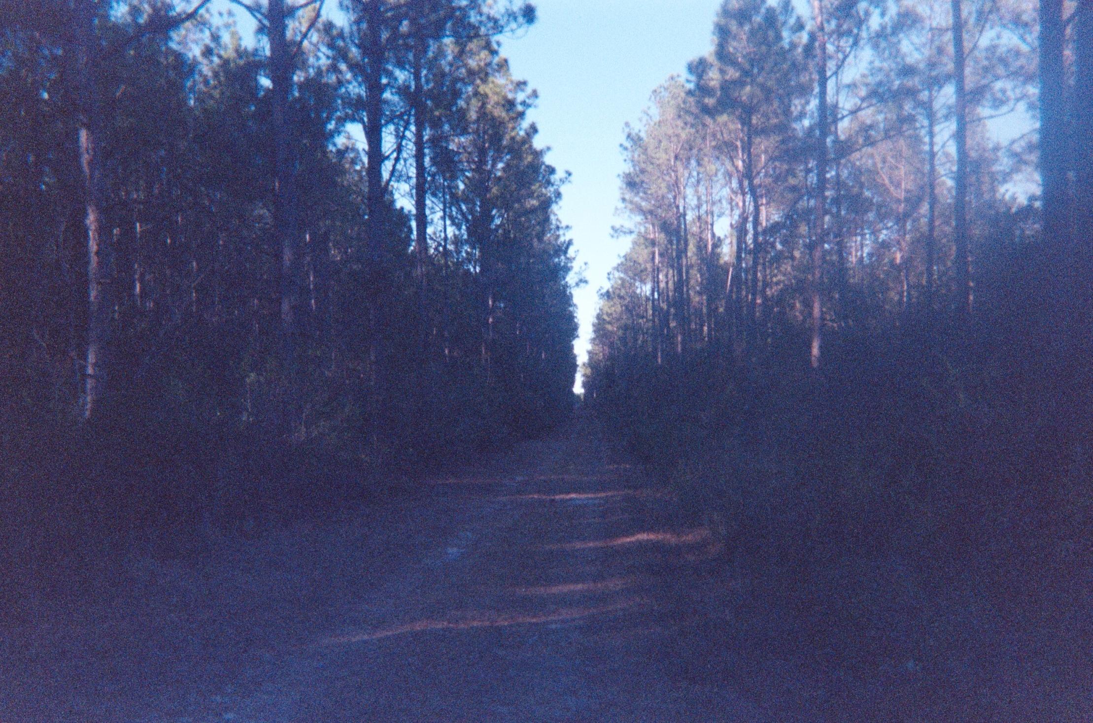

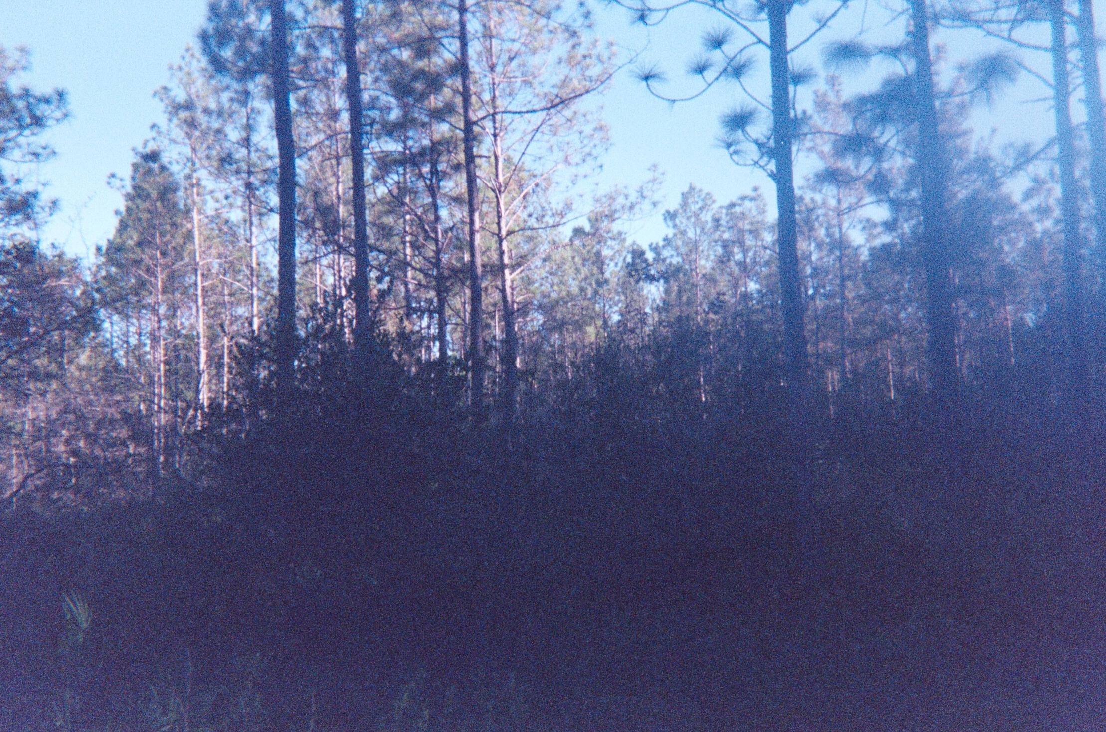

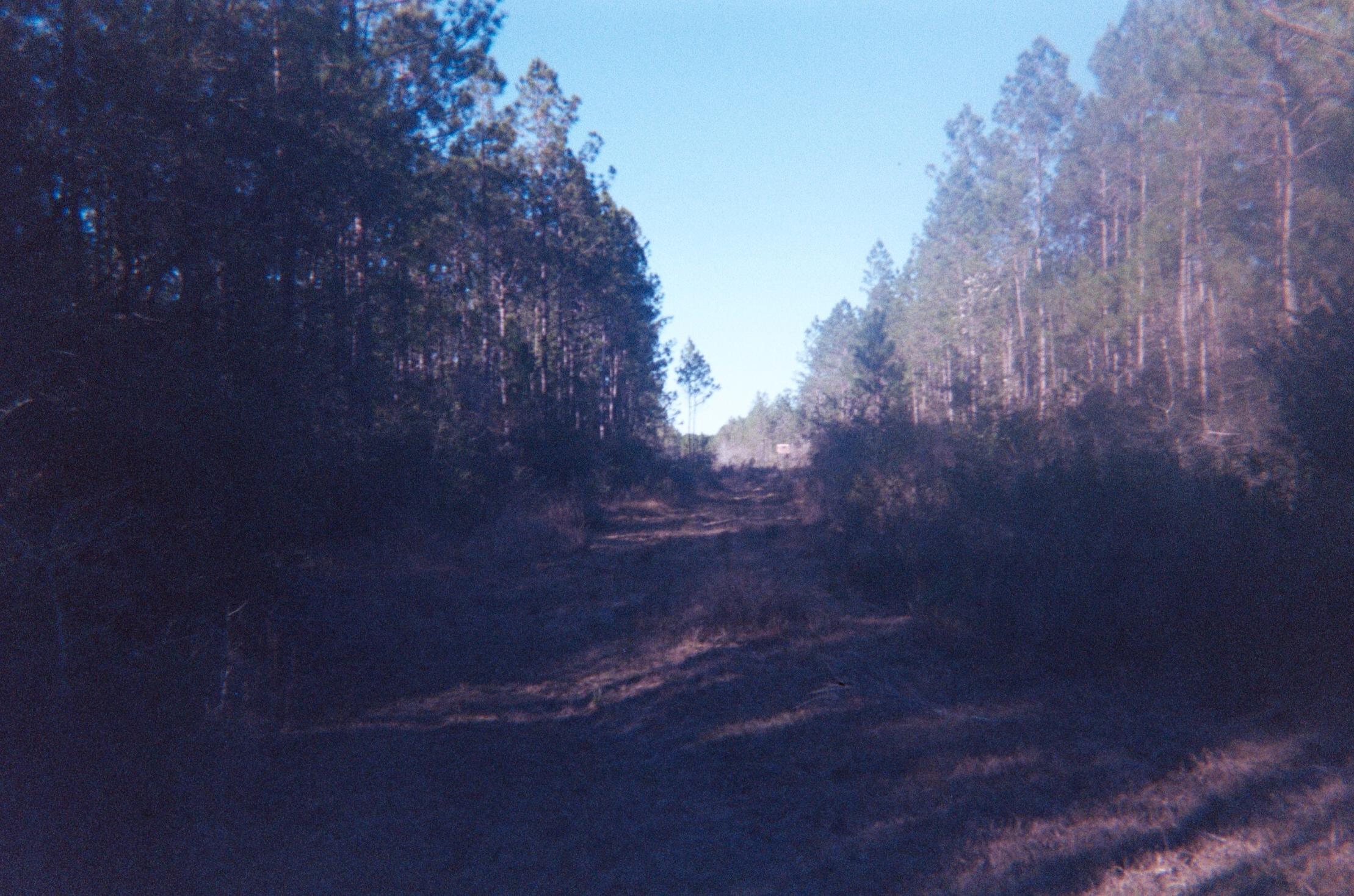

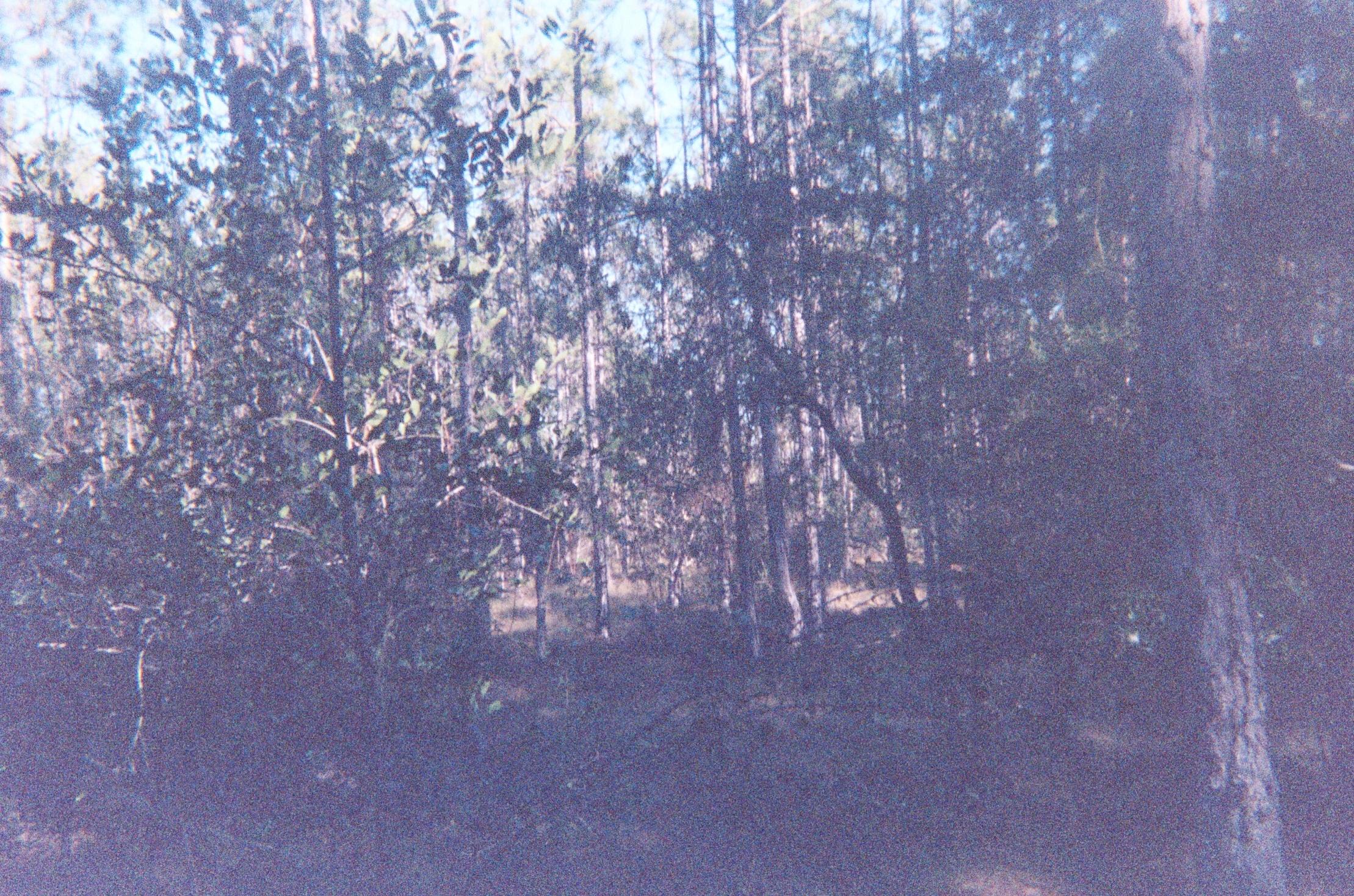

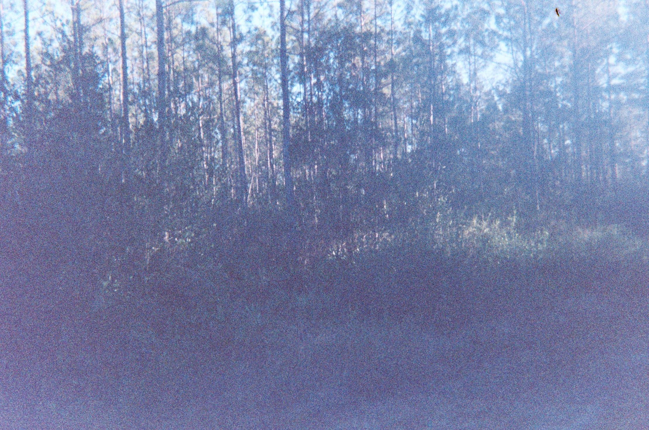

I was looking at possibly row cropping, AFTER a clearing up the land. How big of a tractor would be needed to pull a heavy disk over it? When pulling the heavy disk over the pine tree roots (around 4,6,8 inches mostly in diameter), would it cut up the roots so that they rot faster, or would the disk pull them up out of the ground? I am thinking and dreaming of doing row cropping with a large tractor. Just keeping that in consideration.
For the root rake on the dozer, what would the root rake do? cut the roots up? pull the roots up out of hte ground? or both?
Thanks for the help.

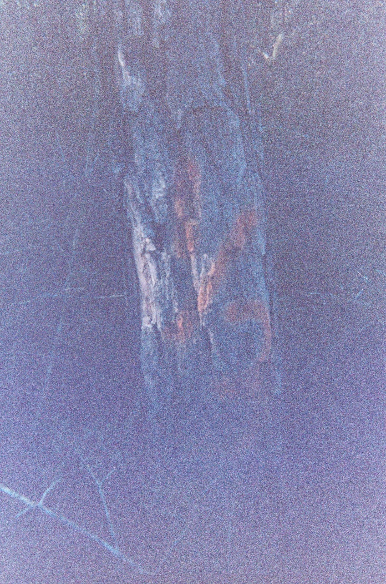

These pictures were taken using an old fashioned kodak underwater camera that "expired" in 2002. Look how great the pictures came out. The last picture is my "1/3" mark, where it is 1/3 of the distance from one end to the other.
