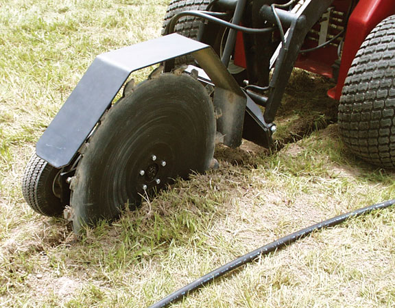

Tiller idea doesn't clean the ditch out - not much benefit. Wheel with cutters would, though I'm not sure why it all goes to one side like in the video. Still seems like a middle buster or subsoiler plus a rack for roll of pipe (you weren't going to use rigid plastic?) would get you pretty far. You could drag a half loop of heavy chain behind the whole thing for backfilling.
Not as much fun as building a rotating tool, but you could be finished for less money and find some other way to have fun?

Tiller teeth attatched to a round plate would work. It would even clean out the trench if it had a crumber bar behind it. Ill post a pic of my homemade trencher I made fro ma 1 to 1 gear box and tillerteeth. China depot has a trencher based on a tiller.
http://www.chinadepot.com/images/jinmaimplements.jpg
http://i471.photobucket.com/albums/rr78/tumblebugtaylor/1000840.jpg
http://i471.photobucket.com/albums/rr78/tumblebugtaylor/1000842.jpg
http://i471.photobucket.com/albums/rr78/tumblebugtaylor/1000847.jpg
http://i471.photobucket.com/albums/rr78/tumblebugtaylor/1000845.jpg
THis is my little home built rig. It really needs to have a 1 to 1.5 like a brush hog gear box insted of 1to1. I could add a few more teeth but my wheel was cut for brazed teeth for another project. I will make another round wheel. Works perfect be hing a hydrostat or a different Yanmar with a super creeper gear. Ive used it on my YM3000 for 1 3/4 miles of trenching for my self and others. I mainly used it to cut a few hundred yards of trench for dug in specs silt fencing. I used it on a Yanmar with a super creeper gear and the L3130 dad used to have. It worked really good.
It also throws the dirt to one side of the trench the open side. I couldnt find the pic of the crumber bar. Its just a semi circular arm like a bike fender to scrap up any loose dirt. It will build up and the tines will deal with it. With out the crumber bar it will leave a fine ground layer of dirt about 1 inch deep in the hole. It cuts a hole 5 inches wide and 8 to 9 inches deep. I was getting 10 but I had to add a shoe for depth control on the fence laying.
