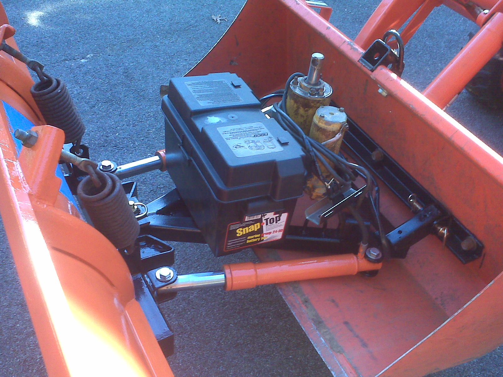

I currently have a Meyer 6' 6" front plow, with the push bar bolted to the pivot points for the bucket.

Here is the front plow set up:
