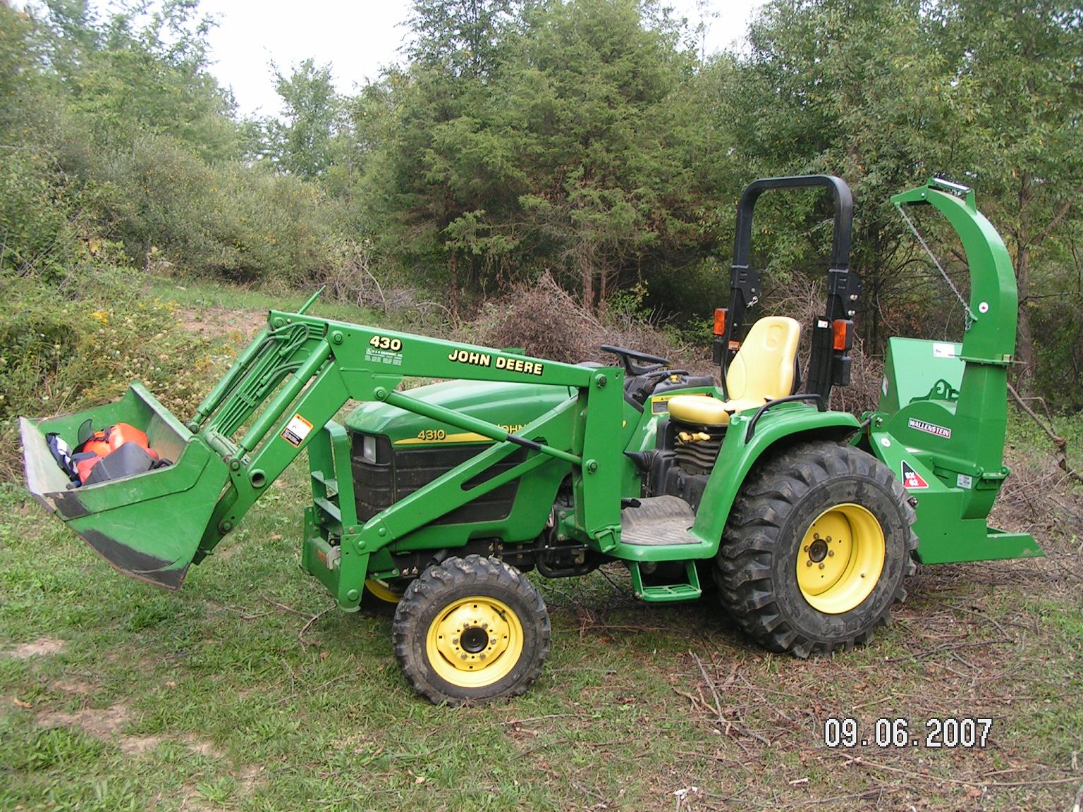

/ Thinning it out #29
Curly,
We just got the Wallenstein bx62 chipper and it has been great so far. If you are looking for something to chip up all your newly removed saplings and trees, this will do the trick. Makes nice enough chips for making paths through the forest and the like.
